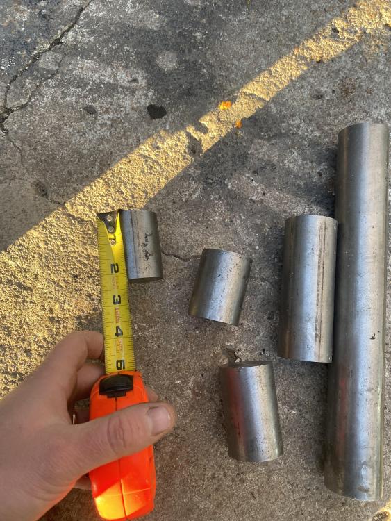

I started hunting for some 2” or close to it size round stock a week ago, to use for the round thingamabob that mounts to the main crank shaft,
and was able to scrounge some off someone who works in an electric motor place, at an 1-3/4 so close enough.. I hope! Lol

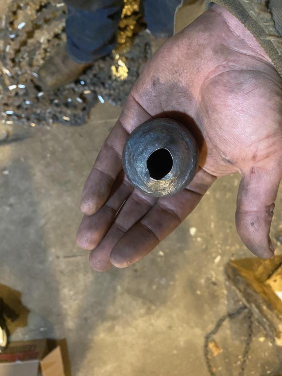

next I started hunting across the vast expanse of the internet for 2” steel balls!
I first started looking at mill balls but I couldn’t find a company that could even tell me what exactly they were made of… and they was expensive!
then after a suggestion from a concerned citizen on here (Glenn), I found a place that sells hot stamped steel balls out of Texas,
(I don’t know what these are made of, couldn’t get no one on the phone)
  but they were cheap and freight was much lower! So I took the bait and through caution to the wind and ordered 5, lol,
They came in yesterday and I couldn’t help but mess with one, so I used a punch to notch a starter point, and a drilled a small hole through it with my 100 plus year old junky drill press that definitely does not drill straight… (another story)
then I drilled a bigger hole with a 5/8” bit, and half a quart of 30 weight oil for lubricant it seems,
well buy that time it was dark and cold outside so I didn’t feel like going out an fooling with the forge, so I grabbed a cold brew an set by the shop stove,
Now it gets crazy… or lazy?
Lol, anyways I got the bright idea to throw the 2” ball in the wood  stove, I didn’t think it would get hot enough to mess with but what the heck?
to my surprise in the measurement of time it took to drink one cold refreshing beverage it was glowing!
so I grabbed an big old rusty wrench and cut off both the ends and grinded one to a point, sort of.. then I went out an grabbed the swage block,
then being as how I didn’t have no ball tongs I just used the fire poker to skewer it through the pre drilled hole, and place it on a round hole,
and I took my improvised drift and hammered away, then knocked the ball off when it cooled down an threw it back in the wood stove,
it accurately took one Brew per heat, and slowly I was able to drift a nice looking oval shaped hole through it while setting in my shop chair next to the stove, Lol
anyways it would probably have gone much faster in my coal forge but this is just the first one, and now I can say it was forged using a wood stove,
I will post my progress as I make each part of a hand crank forge handle several times over, I think I’ll do the rest of the heating on the other parts in the forge though lol,
One last thing… I may or may not have used the shop cats water bucket to cool down the drift and quench the ball…. Again to lazy to walk outside… lol
I looked at the existing blower handles I had  and mounts,
There’s a couple different styles, one being the the handle part is one with the crank lever,
the other the handle is riveted onto the the crank lever, this is the way I’m gonna go,
there’s a couple different mount also,
here is the 1-3/4” round stock im gonna use for the mount part since I don’t have a lathe to turn it down I’m gonna opt for the bulky style mount, 101DB61E-2CCB-4558-BA83-23DC813FD903.thumb.jpeg.3515096eb39fd86c6d1e3b44643efb83.jpeg
