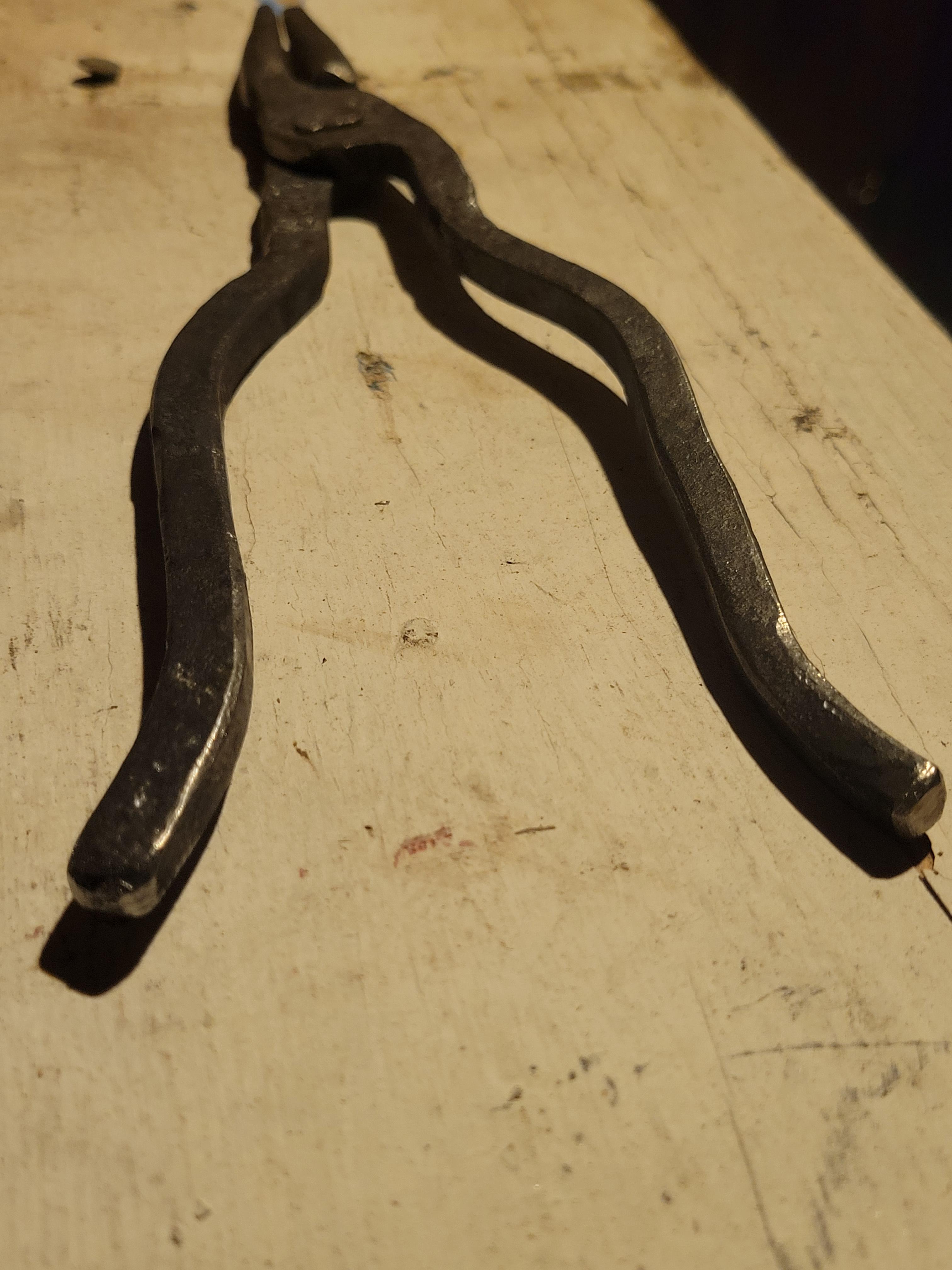

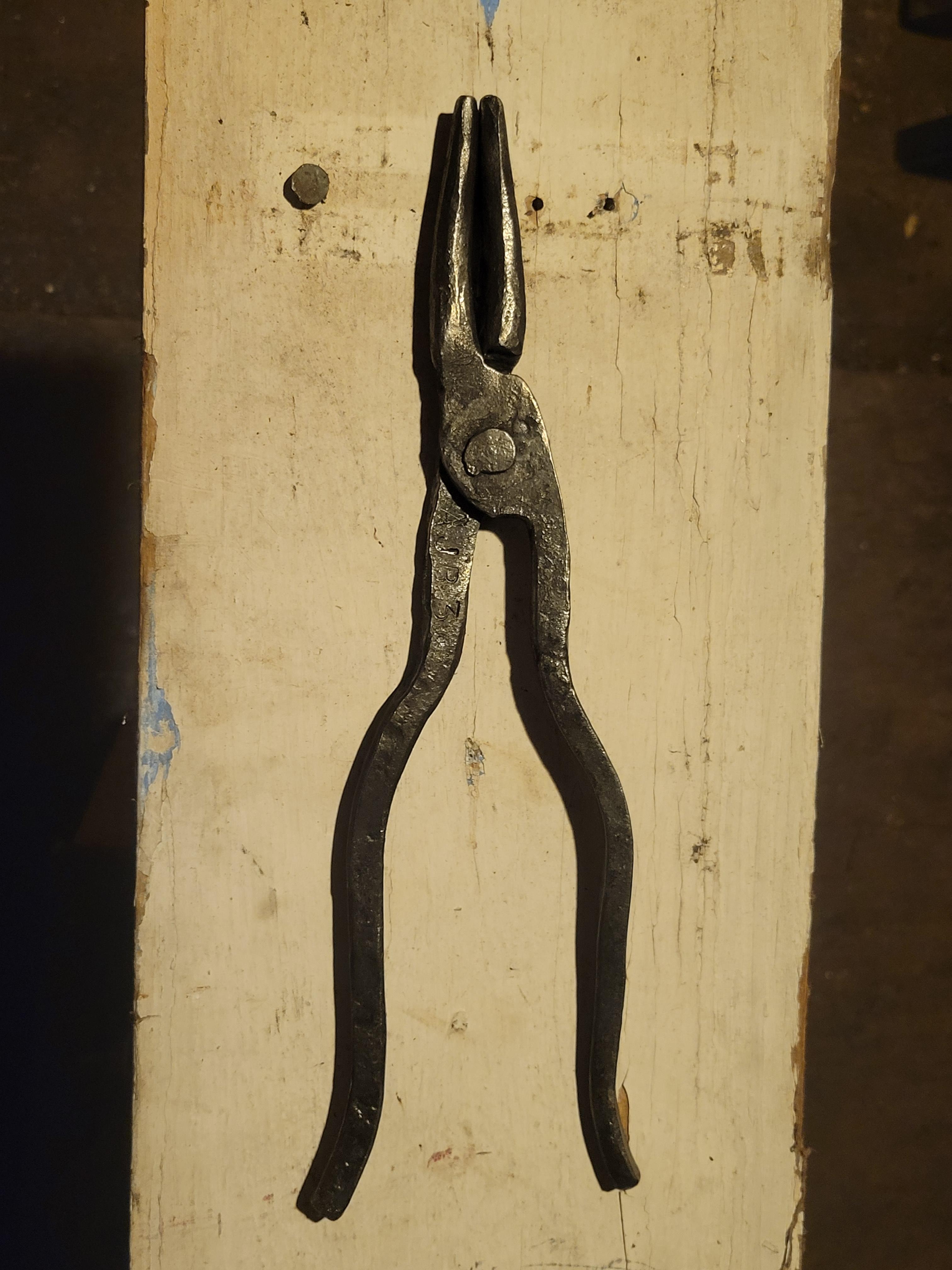

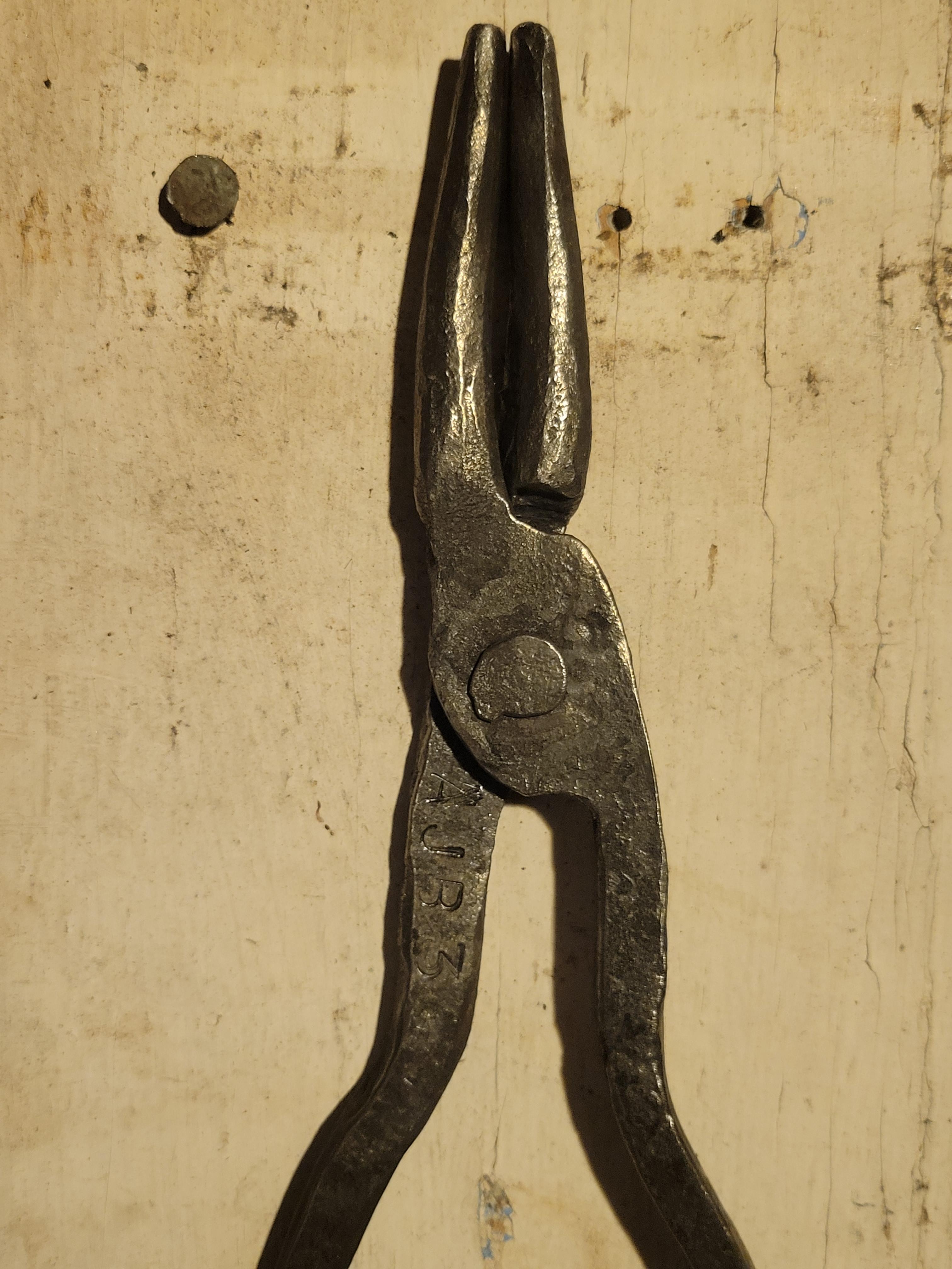

Red Shed Forge Posted March 4, 2021 Share Posted March 4, 2021 I needed a pair of scrolling tongs for some desk legs I have been working on. I have some 3/16" x 2" flat stock scrolls that will be attached to the legs; my hope is that these tongs will help me refine the imperfect scrolls. These are the third pair of tongs I have ever forged. I have yet to test them and at face value, they could certainly use some improvements in a few areas, but they feel sturdy and comfortable in my hand. I learned a lot along the way in regards to number of heats used, hammer techniques and control, and overall confidence in my abilities. They are forged from 5/8" high carbon sucker rod. They are 11 1/2" from the tine tips to bottom of the reins. The reins span 3" in width. I drew one of the reins a bit thinner than the other and my rivet could be bulkier; I plan to improve on these two aspects on my next tong forge. Quote Link to comment Share on other sites More sharing options...
ThomasPowers Posted March 4, 2021 Share Posted March 4, 2021 All the sucker rod I've seen is medium carbon---where did you find the high carbon stuff? They are going for tough not brittle as dropping the downhole pump a thousand or more feet down is an expensive proposition! A scrolling wrench might be handier than scrolling tongs for wider stock and definitely for heavier stock! Quote Link to comment Share on other sites More sharing options...
Red Shed Forge Posted March 4, 2021 Author Share Posted March 4, 2021 I posted last year in September when it "Followed Me Home", and a response I got advised that it was sucker rod: However, my FIL who gave it to me, acquired it from a deceased neighbor who in life had no known (to my FIL) connection to well pumping. He was an electrician and collector of much scrap steel in south-western Kentucky, so it is difficult to pinpoint from where it originated exactly. It certainly sparks and forges like HC steel (in my limited experience), so maybe it is related to an electrician's vocation, rather than sucker rod, if most is MC like you say. I do have a small, poorly forged scrolling wrench and hardy bick to assist in tweaking the scrolls as well. I made the tines on these tongs 2 1/2" long with the thought that their length would be helpful on the wide stock. Maybe it's just me, but I also did not find it too difficult to move with a smaller pair of needle-nose pliers, so I assumed mine would do an even better job. We will see. Quote Link to comment Share on other sites More sharing options...
ThomasPowers Posted March 4, 2021 Share Posted March 4, 2021 I tend to go from needle nose to a wrench. I do need to make a couple larger wrenches for some projects coming up... Quote Link to comment Share on other sites More sharing options...
Red Shed Forge Posted March 4, 2021 Author Share Posted March 4, 2021 Well now I want some better wrenches too! Lol. I've got some sections of 7/8" round stock that I believe was used as canopy tent stakes that might work..? It was painted yellow at one point. IIRC, they have some crowning at one end from what I assume is damage from hammer blows. Too soft? Quote Link to comment Share on other sites More sharing options...
JHCC Posted March 4, 2021 Share Posted March 4, 2021 One of the most important things in scrolling tongs is having enough mass in the bosses and a heavy enough rivet to withstand the twisting forces that scrolling will place on them. I've got two pairs of scrolling tongs made according to the method in this video from the New England School of Metalwork: Quote Link to comment Share on other sites More sharing options...
Red Shed Forge Posted March 4, 2021 Author Share Posted March 4, 2021 Thank you for sharing that video, John. Very helpful. I actually made mine based on a Joey van der Steeg video where he used 3/4" round spring steel. And thank you for mentioning the bosses as I am wary of mine for the reason you mention; they are slightly more than half the thickness of those in that video. I'll keep this in mind when approaching my next pair. Hopefully they don't give when I use them on my current scrolls. Quote Link to comment Share on other sites More sharing options...
rockstar.esq Posted March 5, 2021 Share Posted March 5, 2021 Building a bit on JHCC's point, I experimented with forging a box joint instead of the overlap hinge. Scrolling pliers / needle nose are a natural for this because the jaws are generally slender and tapered which makes it easier to slide them through the punched slot. The resulting joint has three planes applying shear force against the rivet, which makes them very strong for twisting applications. I was very surprised to discover that a sorta-well formed box joint will work without a rivet. Forging the box joint is a bit more complicated than the half-lap. For my experiment, I used some mild steel to make the slitter, and drift. The drift wants to be 1/3 the thickness of your hinge joint. I used the drift as a forging bolster when setting down the center boss. I didn't have a set hammer, so I just used some short square stock as a substitute. Aside from the "special" tools, the box joint wasn't too hard to forge. I was pretty stressed about passing the inner boss through the opened outer boss, but it wasn't as difficult as I imagined it would be. If I had to do it again, I would have used a lighter touch closing the outer bosses because the cold central boss acted like a drift. Quote Link to comment Share on other sites More sharing options...
Francis Trez Cole Posted March 5, 2021 Share Posted March 5, 2021 The video is great, But you never hit the flat side of the boss with the hammer. The anvil will help make the boss flat. Second I would use a longer rivet to make a a bigger head. Helps keep them strong when twisting. Remember the forge to hold the metal is in you hand the longer the reins the more leverage you have. Quote Link to comment Share on other sites More sharing options...
