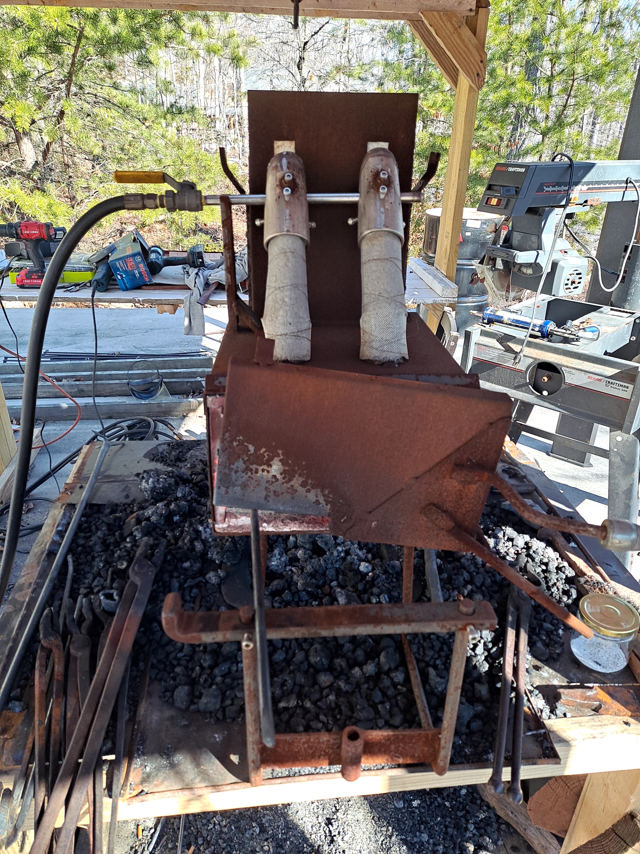

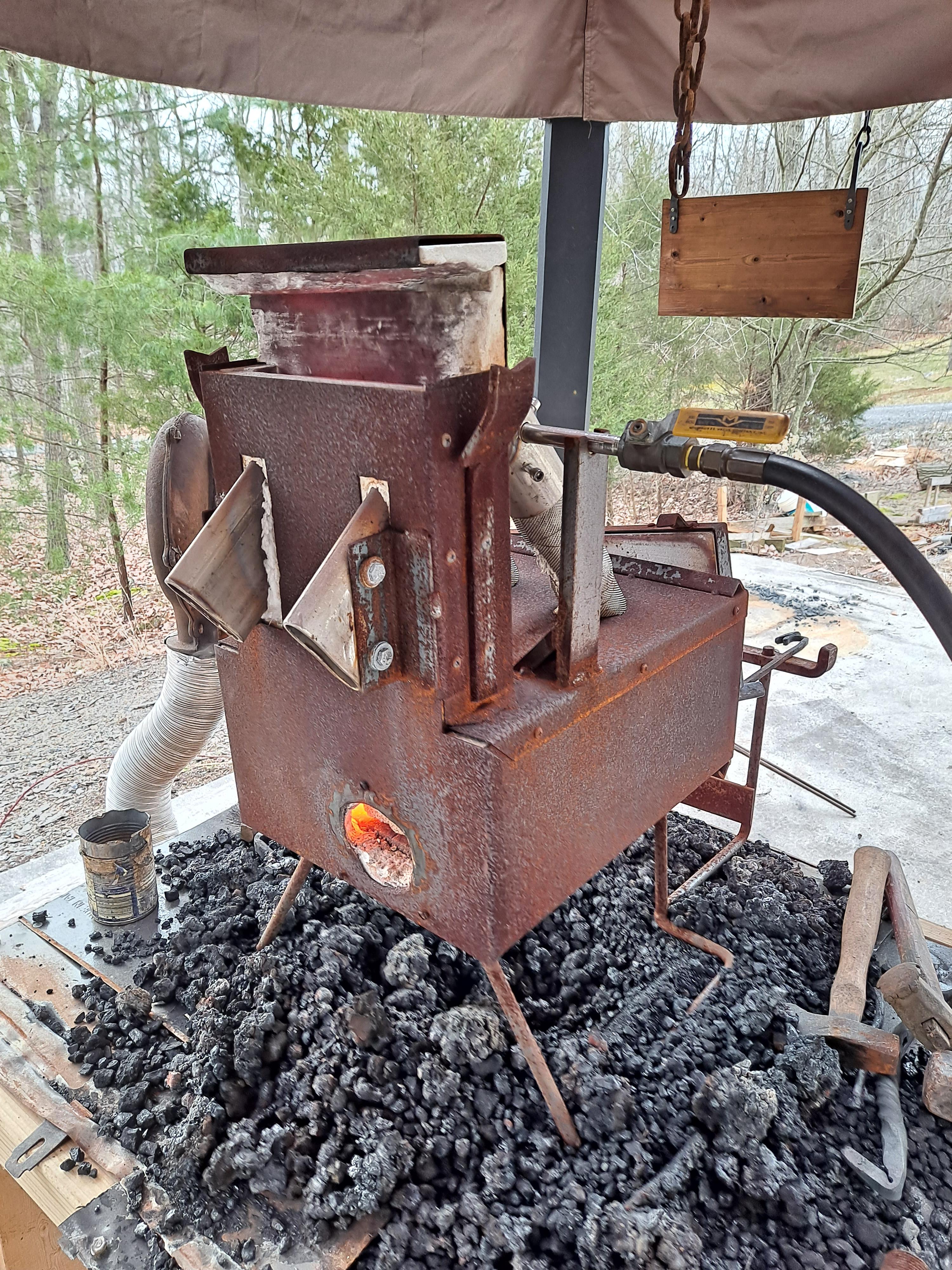

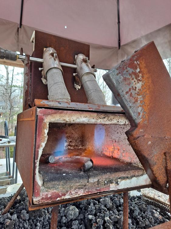

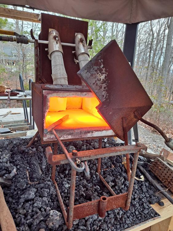

I am lucky enough in my studio to use regularly a Sandia Gas Forge. I wanted to share some photos and invite questions, as I know these forges are a little rare.20210123_125958_10.thumb.jpg.ac4d8ccaaceb28d153237f1e1f6b63b7.jpg20210111_095205.thumb.jpg.f10e5f46aca6db290d111d3a600da6b7.jpg20210111_095132.thumb.jpg.8ba192a96d8382d358c51b376d6956d3.jpg20210111_092212.thumb.jpg.bc7fc740853db100ec68c4f9e0626465.jpg

Not sure if they're still made,  but I was gifted this by a fellow Smith when I moved into a townhouse a few years ago.
I know there were some threads about this year's ago, but since I use one daily I thought it might be nice to have some current firsthand experience.
I bought the plans too; problem with them is that all of that stainless steel pipe oxidizes away; maintenance is kind of expensive at the cost of S.S. these days. But there can be no denying how well they work.

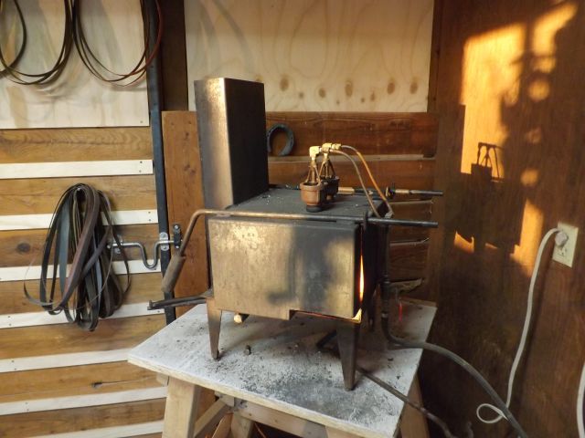

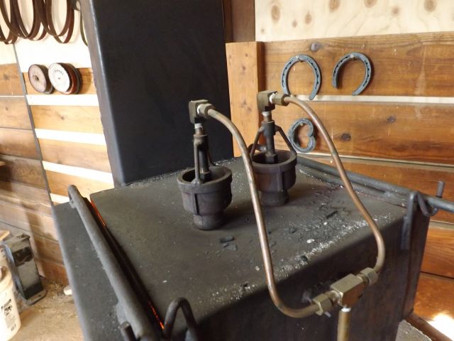

I use a modified Sandia forge (2 doors, and without the intake tubes on top).  Will post photos later.

Here are photos of my Sandia forge.  A friend made it some (15-20) years ago.  It needs some tweaking but it works well.  I have been using it more than my coal forge lately.  Easy start up an less hassle than building a fire and tending it.  That said, I expect I will continue to use both for the foreseeable future.

The main advantage of the exhaust is that the tubes warm the propane, allegedly making it more efficient.
I go through about one BBQ size bottle of gas every 16hrs running 10psi.
I have never used another gas forge, so nothing to compare, but at that psi I get yellow heat pretty consistently.
I use mine for production work and especially toolmaking with spring steel, since I cannot burn the spring in my coal forge.
