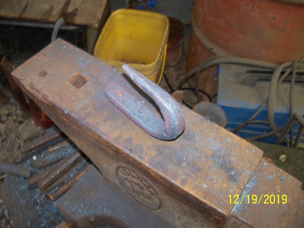

What Frosty said. I have welded normalized coil spring to mild with E6011 rod and it is still holding after lifting a lot of weight. I don't have a picture but this is welded to the bucket of my tractors front loader.
