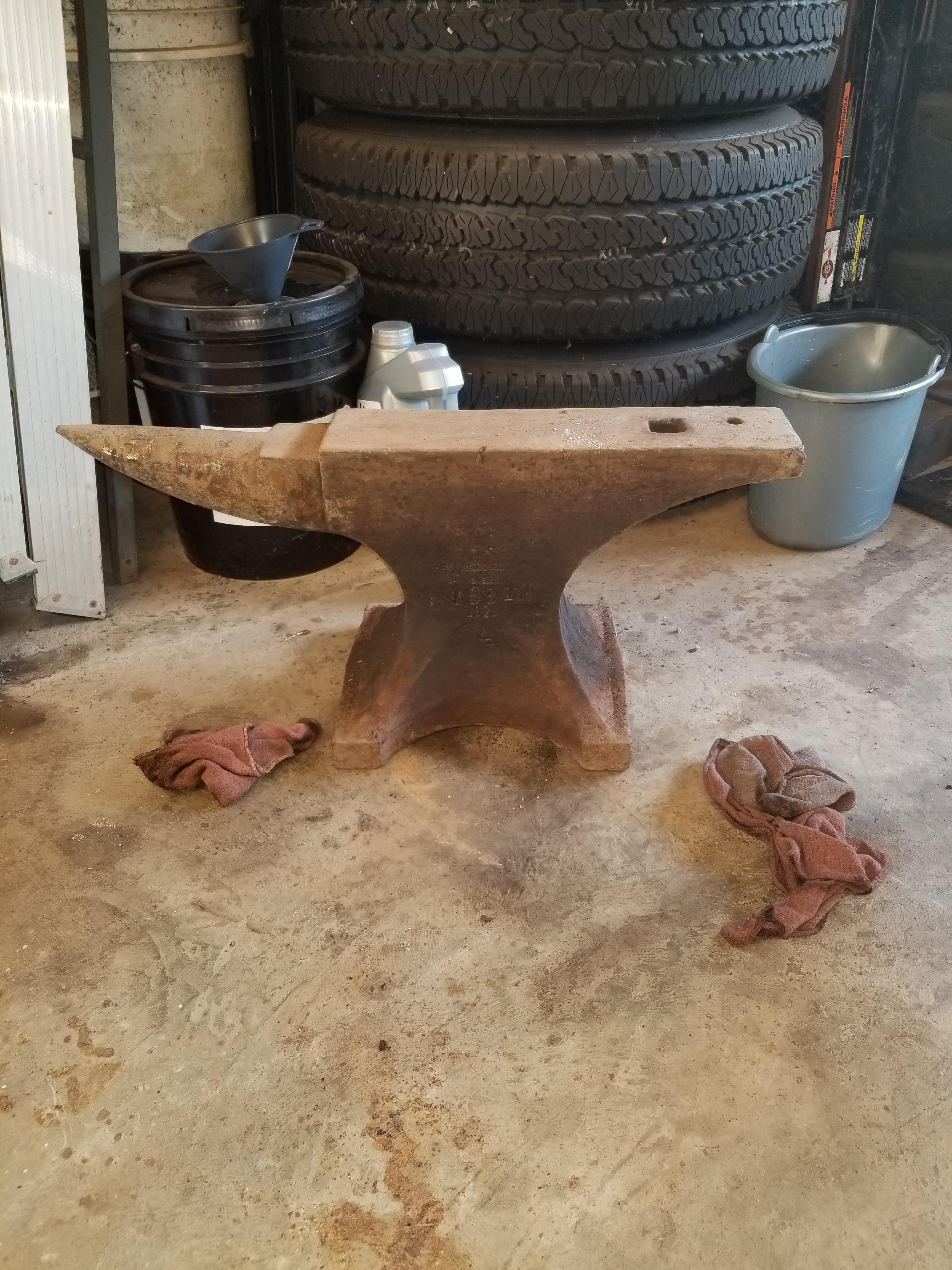

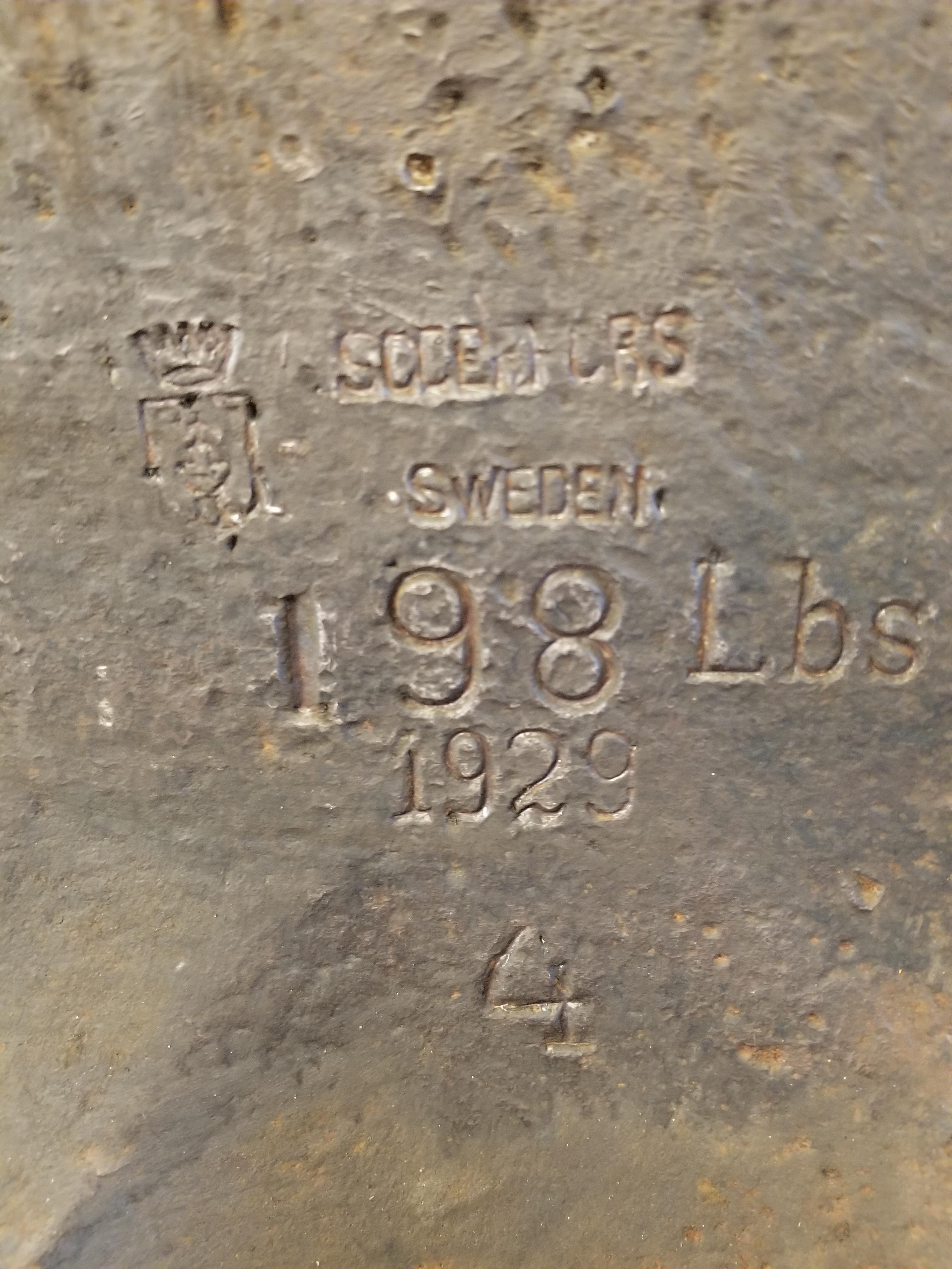

That's a "198lb. Soderfors anvil cast in 1929" just like it says on the side. I hope you plan on using that beauty, Soderfors cast Swedish steel anvils are as good as anvils get. Check the other side for the model name, mine is a Sorceress #5 but Soderfors is a major foundry anvils were a sideline and they made them for many retailers. Paragon is another brand or model name, there are others but I'm blanking on them.

Frosty The thank u and west Virginia  and I'll look and see if I can see any other numbers and yes I plan on using it I was just curious I I got a good deal on it or no paid 175.00 for it

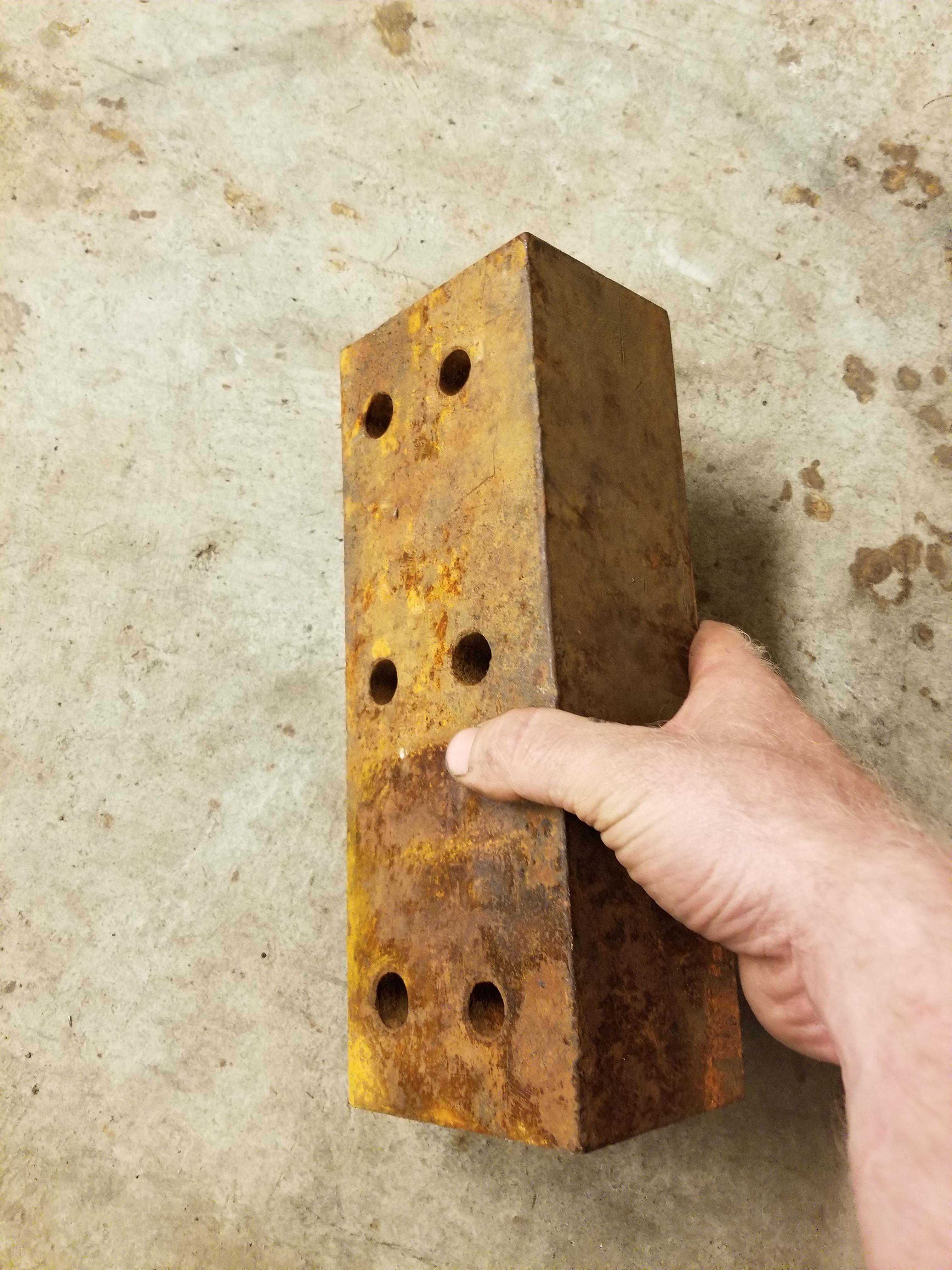

And it came with this piece of metal not shour what it's for and I'm sorry about early
A good deal? At $175.00 U.S. you got a steal at 88 cents a pound and it is a cast steel anvil, one of the finest. I have seen Soderfors go for upwards of $7.00 a pound. Can't tell what the piece that came with it but it will come in handy fore sure. It looks like a counter weight off a piece of heavy equipment like a tractor or bulldozer. I hope you have read about not doing any grinding, milling or welding on the face of the anvil.

That's just a nice size chunk of steel, it's not related to the anvil other than the seller wanting it gone and you were handy. $175 for a 198lb Soderfors!!!:o I hope you bought a lottery ticket! That's the SWEETEST deal I've seen in a long time. It's like getting a Ferrari for the price of an old used toyota!

Don't hesitate to take a powered wire brush to it, a cup brush in a disk grinder is perfect, wear PPE!! (Personal Protective Equipment) Digging bits of broken wire out of your hide smarts. A wire brush won't hurt it a bit and rusty isn't the way to treat a fine lady like that just go grinding. Once you get her cleaned up a wipe down with Boiled linseed oil or my favorite Trewax, a Carnuba paste wax applied on it at about hot coffee temp.
Using a wire wheel to clean it up a bit won't hurt and a coat of wax or BLO (Boiled Linseed Oil) will help protect it. Hammering hot steel will shine up the face just fine.

$175??? You lucky dog! I don't have to ask about the ring, it's a Soderfors. How's the rebound? I have a 1920 151# Soderfors that I love. It's an excellent anvil.
