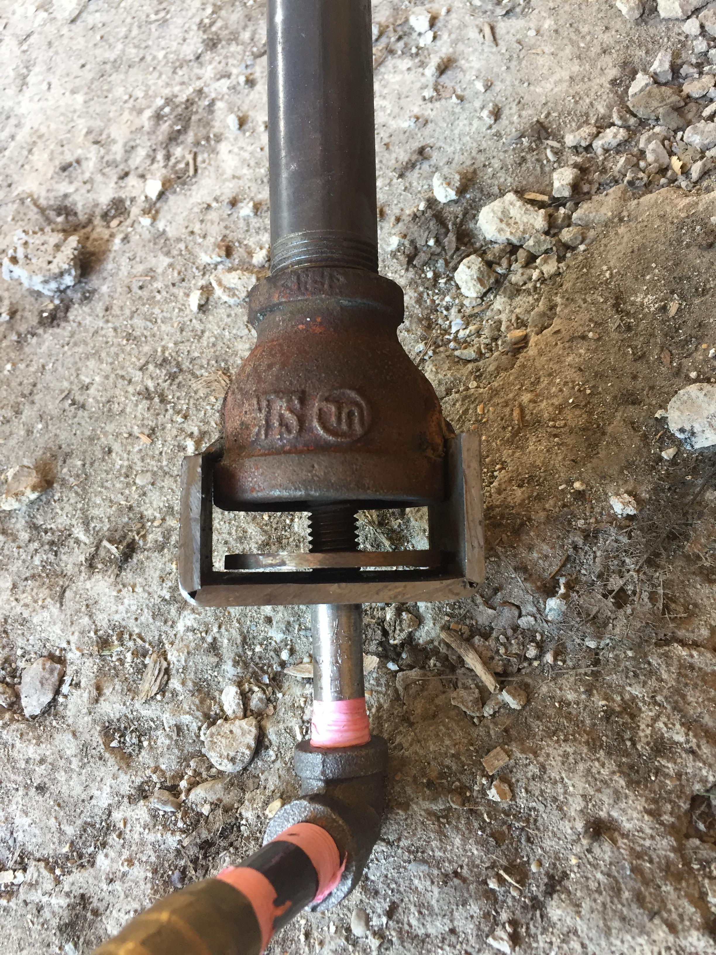

Hi, I'm new to forging and just building my first propane forge. It's a big one- about 2500 cubic inches. I made venturi style burners (3 of them), figuring that would work. Problem is, outide the forge they work pretty great, but once installed the flame is very weak  and often just oxidizing, even though I can control the amount of air going in. I'll post videos, but here is the info anyways. The burner construction is as follows. Straight from the tank there is a high pressure regulator with a hose that leads into 2 tees in order to split the assembly into 3 branches. At this point the pipes are 3/8, but they lead through 90 degree elbows and reduce into 1/4 to go into the burners themselves. There are ball valves on all three. I threaded the pipe nipples and put it through a bracket which is welded to the reducer on the top of the burner. A disc is threaded onto the pipe so that it can move up and down on top of the reducer in order to control the amount of air going in. At the end of the pipe there is a cap with a 0.035 MIG tip for a jet nozzle. The reducers themselves are 1-1/4 to 3/4, the burner shafts are 3/4 by 8. Currently they are just being held in the forge by 3 pipes welded to the body that the burners just sit in, I'm wondering if I need to make the pipes bigger and just use retention screws so that there is extra space around the burner for air getting into the forge. Here are the videos of the burners outside of the forge, as well as inside. In the videos of the burners installed in the forge, I am using a hair dryer to blow more air into the forge and you can see the flames immediately get better. Any help would be appreciated. Do I need to change to forced air?

Thanks a lot for the info, I didn't know you could only heat so small an area. I really do want this to work without having to make an entirely new forge, so would it work better just to cut it in half? And here are pictures of my burners, so if they are salvageable please let me know, if not I'll make those tee burners if those will work a lot better. Im sorry if I sound like I'm ignoring your guys advice, it's just that I've spent a bit of money on this so far and I don't want that to be wasted, so if i can make my existing forge smaller and just remake the burners that would be best. Believe it or not, where I live in canada, I can't get any of the popular castable refractories unless I pay a small fortune on shipping, and the best I can get here is 2800 degree stuff from a pottery place that's 80 bucks for a 50 pound bag! So that's why I want to salvage this forge.

Ok so I’ve made a small forge now, with Frosty’s t burners, an they work great outside the forge, but inside they sputter a lot and are very weak. Again, if I blow into the forge it gets much hotter, which leads me to believe it’s the same problem as before. This is really frustrating so if anybody has a straightforward answer I would appreciate it. I am just about out of money so I can’t build a whole new system. Would it fix the problem if I plugged one end of the t and attached a small blower at the other to increase the air getting in?
Did you follow his design exactly, or did you just use whatever length 3/4" pipe nipple you had around with a 3/4" x 3/4" x 3/4" TEE fitting (because it was difficult to find the correct reducing fitting), and put a pipe reducer on the other end as a flare like so many folks do?
Frosty's burners are pretty easy to construct (by design), but they do need to have the mig tip orifice correctly positioned.  Part of that positioning is drilling and tapping the back of the TEE as accurately as possible so the tip is centered and inline with the center pipe of the TEE.  The other part is locating it in the correct place in line with the mixing tube so it induces the correct amount of air.  This latter is the fine tuning that needs to be done for these homebuilt burners, and one of the key challenges for the design.  Frosty can likely help you here better than any of the rest of us.
Blown burners are much easier to tune, IMHO, and what I use myself.  You likely could do what you described to make your burner into a blown one, but you might not get adequate mixing with that configuration.  Just remember that if you start experimenting with a blown burner you need to be very cautious with your lighting and shutting off routines.
Take a photo of the flame both inside and outside the forge as well as the .  If you ask very nicely Frosty will most likely help you with tuning properly.  Also shots of the entire gas train will help, to be sure you are using the right regulator setup.
