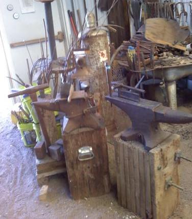

Beautiful stand and looks very well done.  What do you plan to make?  Knuckle height is good for using sledges and top tools and way too low for blades in my experience---you end up crouched over to do precision work and your back gets messed up.
I tend to use the vertically oriented wooden anvil stands and large baulks of timber stands.  Stumps are not very common out here.
I'm all about the cheap; those two stands, the wood was free and the fittings were US 20 cents a pound at the scrapyard.
I also teach and so have to have a range of anvil stand heights including ones for 5'2" and 6'4"  smiths.  Start of class is usually moving anvils and stands around until all the students are equipped in the range.

For me, doing "fine work" which includes most of bladesmithing, I like the anvil's face at mid wrist height.  You need to see what works best for you; but do pay attention to your ergonomics as we hope you will be doing this for decades and not have to give it up early because you trashed your arm or back. I am lucky enough that I can use different anvils for different tasks and so have a variety of heights available.
Another way to get a good indication is to put a thin piece of plywood on the face. Assume your stance and hit it with a "normal" blow of the hammer and see how the indentation looks. C with the opening facing you: anvil too low. C with the opening away from you: anvil too high.  C with the opening to the right or left---you are not hitting flat or the anvil's face is tilted. O anvil just right!
Note that this can change as you adjust how you are standing and using the hammer over time.  (I know I'm one to two inches shorter than I was 40 years ago!)
