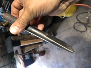

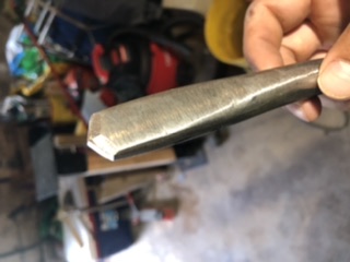

  2. Hey Thomas, thanks for the reply. I haven’t tried drilling holes but maybe I’ll try that next time. I was hoping to get it done on the anvil but that’s proving tougher than I expected. I’ll post a picture of the punch I’m using below. Im using propane, seems to be a very even heat. I don’t have anyone holding, that would be nice but with a hand punch it seemed like a bad idea. I need to make a handled punch with better tip geometry for sure. Having that and a striker will be helpful.

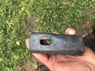

  3. Hello again everyone, I’m hoping you all can give me some advice here. I’m struggling xxxx xxxx to punch and drift a straight, clean eye in a hammer. I’m on my second attempt. I’ve been using a hand punch I made from 3/4 h13. The drift I’m using was drawn out from a big pry bar. The first issue is the eye is crooked, which is certainly just lack of experience. The second issue is I can’t seem to drive the drift in far enough to try to draw the cheeks out and straighten the crookedness. I’ve realized that I need to be working very hot, so I adjusted the forge and I’m having a somewhat easier time, but I just can’t seem to get it driven very much at a time. I’m working solo for one, and two I don’t think the punch tip geometry is right. I’m not getting a clean plug either. Anyone have any suggestions?
  4. My only education thus far has been YouTube, books and learning by trying on my own. It’s not the best way, but it’s what I have access to at the moment. I’ve made my first hot cut chisel, hammer eye punch, round punch and hammer eye drift. I’m trying to make some hammers with a hand eye punch. The first one is mystery material from some machinists parallels I got from a junk sale. The eye is pretty off and it took a few days just to punch it. I’m working on another one using a 1.750x4” round of 1045. It’s been much easier to punch so far, but without knowing the proper geometry of a hammer eye punch, no striker or striker anvil etc, it’s still slow going. If I were smart I’d have made a handled hammer eye punch first. Just a few photos for critique.
