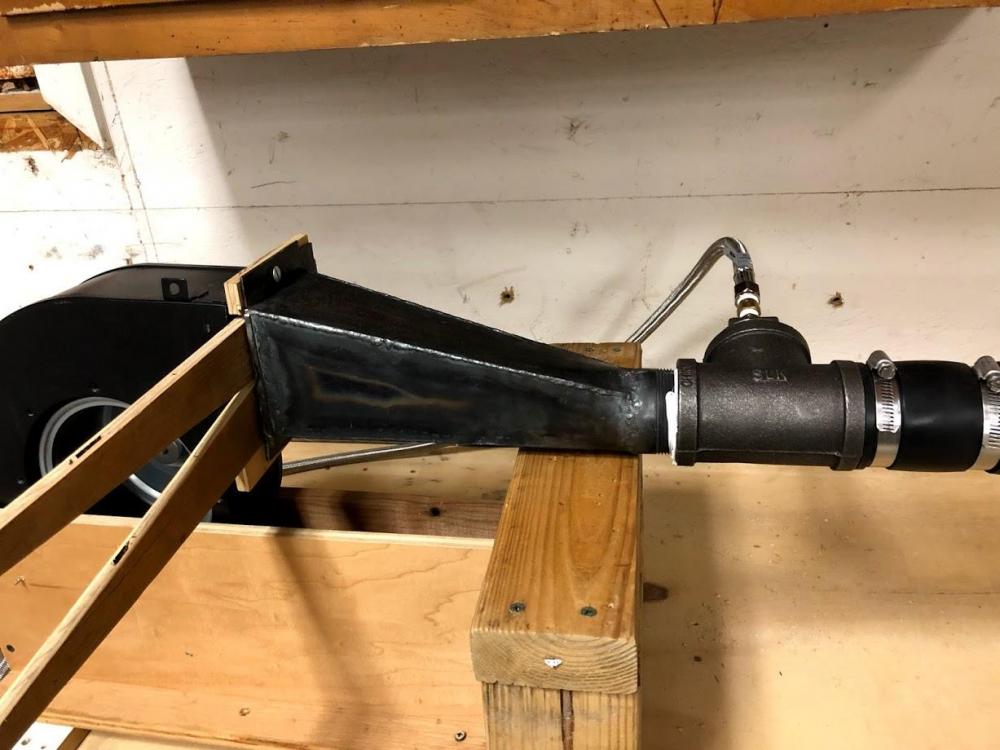

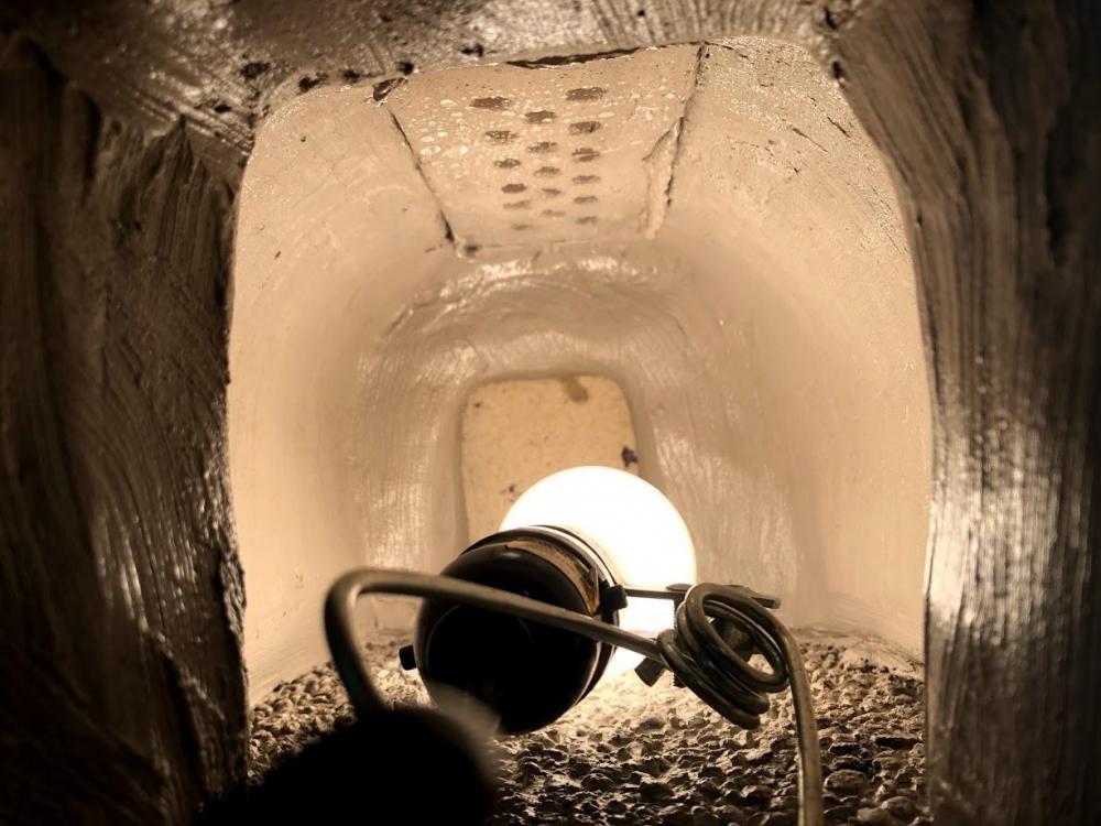

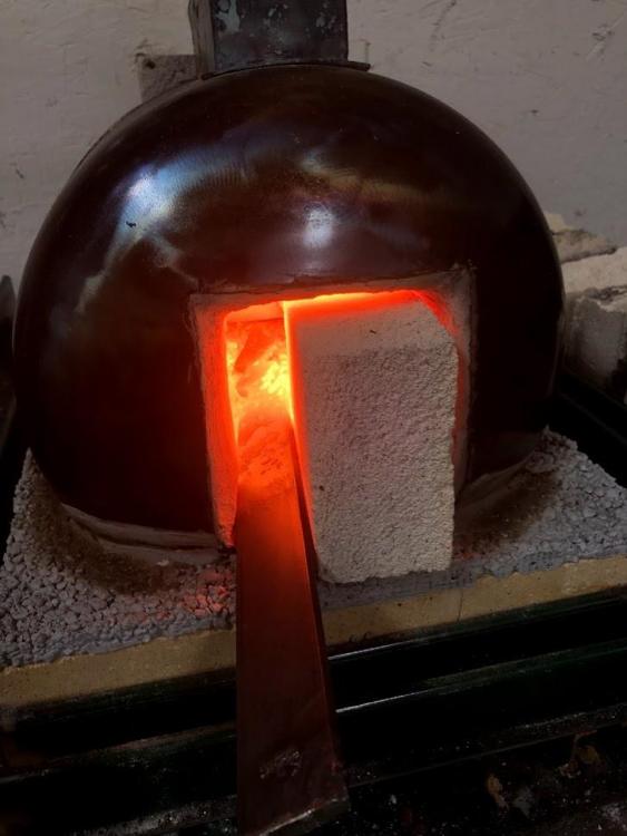

Selkirk Posted April 4, 2020 Share Posted April 4, 2020 Good Morning All, I built my first forge over the winter but after running a few times I'm seeing a number of problems with how I built it. I'm hoping that now that I understand the operation and my needs better I can tweak it rather than start over. The first problem I need to overcome is forge temperature. I have a hard time reaching yellow heat. It takes at least an hour to warm up enough to be able to reach that temp. From my reading here it sounds like my choice of hard fire bricks on the bottom is a big mistake. Currently I have a 1/2" top coat of 3000F castable to protect the brick. I'm thinking of adding a 1" thick layer of 2800F castable that I already have. It's a little better insulating (0.45W/mk) and will reduce the total volume of my forge. This would bring it down from 575cuIn to about 500cuIn. I just received some Matrikote for my final layer as well. Any thoughts on whether or not this is likely to be worth the time and effort? On whether or not a fresh layer of castable will bond to an existing lightly used surface without falling apart? Thanks in advance for your thoughts! Quote Link to comment Share on other sites More sharing options...
Binesman Posted April 4, 2020 Share Posted April 4, 2020 An hour to reach yellow heat is a massive issue. It is more than just hard firebrick in the floor. So lets start with your full design? Including burner and regulator along with some video of the forge running and how you tune oxygen? Quote Link to comment Share on other sites More sharing options...
Selkirk Posted April 4, 2020 Author Share Posted April 4, 2020 I'd be happy to elaborate. I can get orange within about 15 minutes. But then for full yellow it takes a while and I really have to crank the gas. I've cranked it up to 10psi after 2 hours and couldn't get any more than a yellow on some quarter-round. It's a Forced air ribbon burner. I've got a large squirrel cage blower with a home made wooden damper to tune. I'll probably upgrade to a gate valve soon because it's touchy. For Gas it's a high pressure regulator which I run through an .035" MIG tip. I have 30+ inches and one 90-degree bend before the ribbon burner. I run 2" pipe all the way to the burner. I've attached pictures of the blower/gas injection as well as a photo of the inside of the forge after I covered the wool with Satanite. The video was taken at about 20-30 minutes of start-up and was probably about 3-5psi. The clearly visible blue flame goes away after about 30+ minutes as the chamber gets hot. Another comment on insulation... I've got two 1" layers of wool behind the satanite but I was paranoid and really went to town with rigidizer on each layer. Is it possible to compromise thermal conductivity severely but over-rigidizing? The outside of my forge gets *very* hot. Thanks! IMG_1963.MOV Quote Link to comment Share on other sites More sharing options...
Binesman Posted April 5, 2020 Share Posted April 5, 2020 Do you see steam when you shut the forge down? If you oversaturated your blanket and then did not dry it that could be a problem and it also heats the outside up a lot because its hot steam. Beyond that possability I dont know what I see looks good. Can you post a video of it running please. Hmmm. What size propane tank are you using? Quote Link to comment Share on other sites More sharing options...
Selkirk Posted April 5, 2020 Author Share Posted April 5, 2020 It definitely steamed on the first fire, but not since. I tried to post a video but it doesn’t seem to be working. I will have to look into that. 20 lb propane tank. My personal theory is that I have a whole list of minor issues. Poor insulation, slightly too large chamber and doors that don’t seal well. It’s forced air and propane, so I feel pretty good about getting those BTUs into the forge but my amateur guess is too many of those BTUs are just heating my garage. that is why I am thinking about another inch of insulating castable on the floor and the Matrikote. But I’m definitely worried about what is going to happen with those two different layers. Does this theory sound off base? Thanks Binesman. Quote Link to comment Share on other sites More sharing options...

Buzzkill Posted April 7, 2020 Share Posted April 7, 2020 To me the most likely culprits are the combination of the forge volume and the mass of solid refractory materials. In the first post I believe you said you have a half inch of Kastolite over hard fire bricks on the floor. Even though the Kastolite is somewhat insulating it will still absorb a fair amount of heat. I experimented with different thicknesses of Kastolite 30 over 2 inches of fiber blanket in the past. The thicker the Kastolite, the longer it would take the forge to heat up. To whatever extent heat passes through the Kastolite, you have some serious heat sinks right under it on your floor. Decreasing the volume of the forge by adding yet more mass on the floor may or may not solve the problem. It comes down to whether the additional mass will absorb more heat compared to the lower volume requiring less constant heat to maintain a given temperature. It may be worth a shot. There is an equilibrium reached between the heat produced and the combination of heat absorbed, transferred through the solids (or into your stock), and the heat lost through exhaust openings. Obviously we'd prefer to shift the equilibrium further to the heat produced side and minimize the heat lost through exhaust openings, absorption of construction materials, and transference. You'll have to decide whether the cost of that additional inch of refractory and the added difficulty in breaking out the floor are worth it in case it doesn't work. If you get to the point where you have to replace the floor, I suggest building up the floor with as many layers of ceramic fiber blanket as needed to give you the final volume you desire (minus the half inch for the insulating castable refractory layer of course). A more precise way to control the air flow will also be beneficial. Fine tuning is hard to do with sliding mechanisms unless they are controlled by screws or other methods of producing very small adjustments. There's nothing particularly bad or wrong in principle with using a mig tip for fuel delivery, but it is not needed for a blown burner. The only real benefit is a restriction that small will provide a wider range on a pressure gauge to use as reference points once you get things running the way you want. A potential down side is that if you have too small of an orifice for your fuel delivery and you hit the max pressure capability of your regulator, then you can't introduce more fuel per unit of time into the forge, which in turn limits the maximum heat you will be able to produce. A larger mig tip will still provide enough restriction to provide a pressure reading on a gauge so you can quickly return to a previous setting, but allow more fuel to be delivered at a given pressure. Quote Link to comment Share on other sites More sharing options...
Binesman Posted April 7, 2020 Share Posted April 7, 2020 Sorry I misread. I thought you stated you were still loosing preasure while in the water bath. Not that it had solved the issue. Construction all looks good. And the forge should run fine. So that means your problem is in the burner. Ive yet to make a ribbon burner so cant help a lot there. Quote Link to comment Share on other sites More sharing options...
