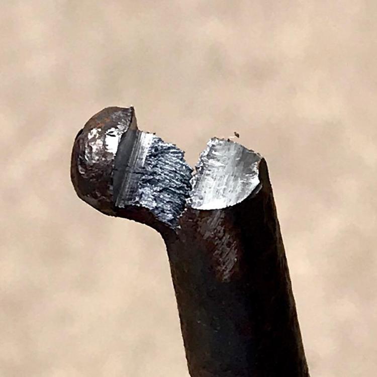

Is this wrought iron?
I picked up most of my tongs from someone who wanted to see his father-in-law’s tools and equipment go to someone who would use them and was not just wanting to get stuff cheap and then sell it for a profit.
The surface of the tongs has always seemed different than what you normally see on rusty tools, so I took the end of the reins on one of the sets that needs the rivet replaced to see how it sparked. It sparked a lot like my post vise, horn of my anvil, and old wagon tyres that I know to be wrought iron, so I cut the tip half way through and bent it. It split and didn’t break. I assume it is wrought iron?  If so, almost all the tongs I bought are wrought iron.
When would tongs have no longer been made from wrought iron?
That's wrought iron for sure.  When were they no longer made from wrought?  Who knows.  Some folks still make them from WI.  If they are in good shape I would keep them for history's sake or just use them.
Isn’t the only commercial source of WI just salvaged old stuff?  Why would someone want to use something special to make tongs today when just normal steel scrap will do?
Why do people repair and restore old cars when the new ones are better?
Some folks are just into the historicity of the craft and like to replicate stuff the way it once was made.

Why restore old tools? It makes a person learn new things even if they're from the past. Forging WI is a whole different critter than steel. Old stuff is good, forget about it and you have to repeat it to get past where you are.
I think their point was: why make new tools out of WI when MS is easier and more plentiful. One answer might be "Because it's there!"  I certainly feel I'm closer to earlier smiths working the materials they used and the tools they used.  Though rocks are a bit of a stretch---save for anvils.
