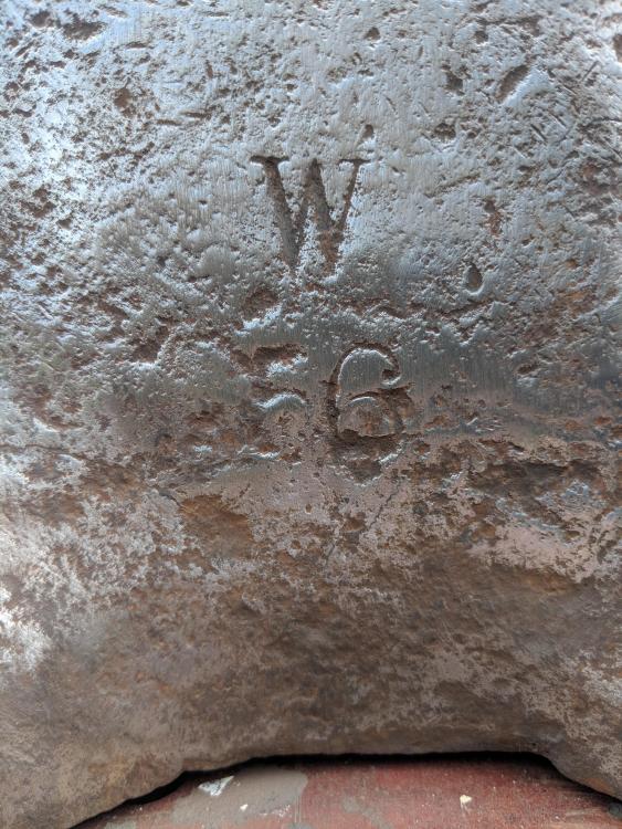

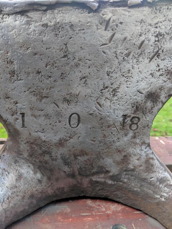

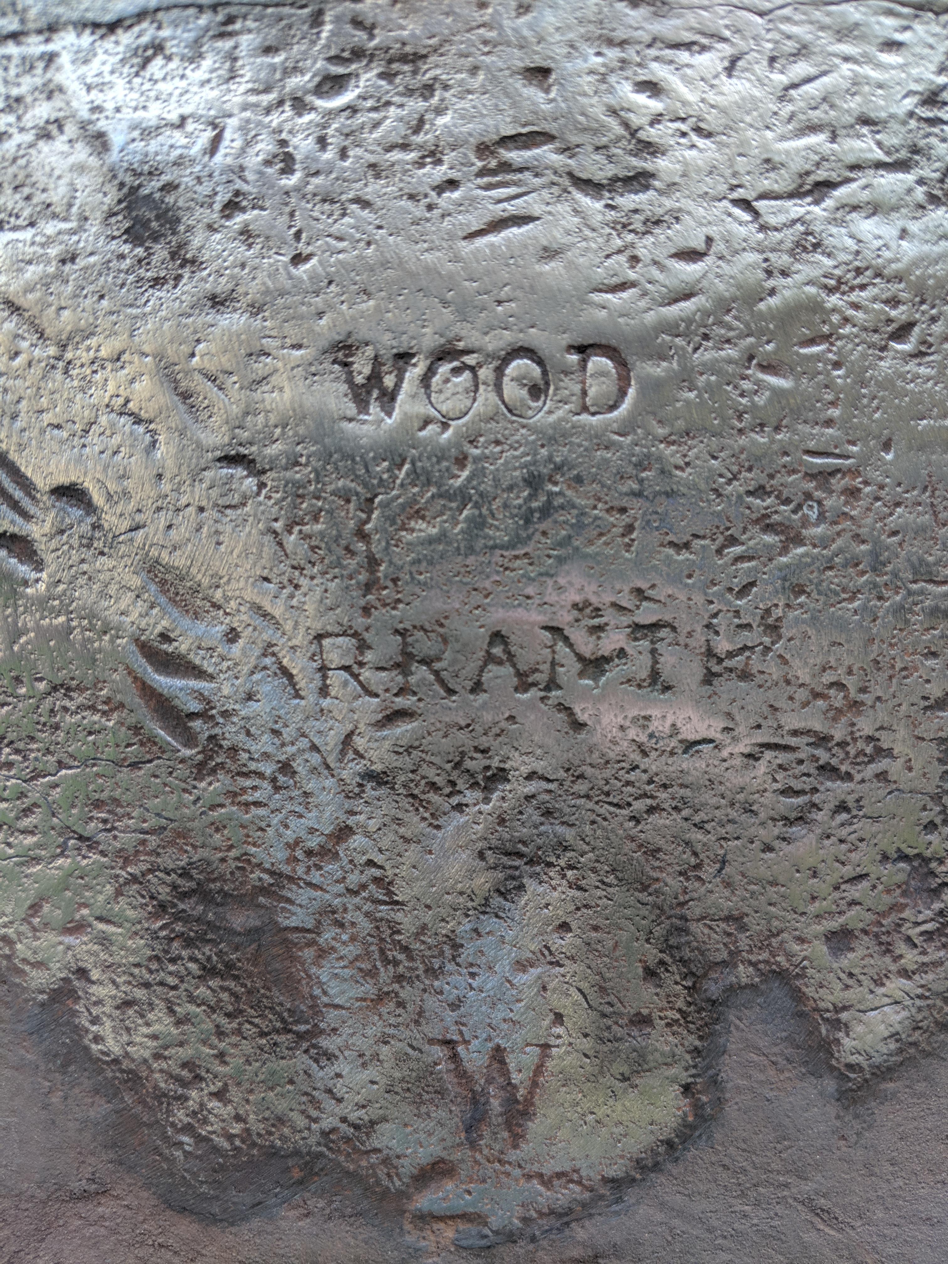

I've just started blade smithing as a new hobbie and I've recently purchased an anvil. I have given it a clean up and and found these inscriptions/markings (pictures attached) can anyone help me with what they mean? manufacturer or anything else? I'm interested in the history of it, thanks people. =]
Possibly an Attwood, I don't have my copy of Anvils in America in this country to see what other "Wood" there might be.
The 1  0  18 is easy; it's the weight in the CWT system  1 x 112 + o x 28 + 18  so originally 130 pounds, and made in England probably at least 120+ years ago. Note: old weight markings are often a couple of pounds off nowadays.
Often anvils are marked with variations on Warranted  Solid Wrought Iron
and often there are markings for inspectors.
Ah that could explain the 'arrant' part
