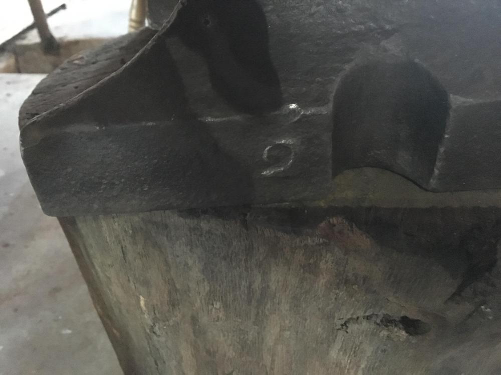

Picked this up today. No distinct stamping but I believe it is a Fisher. Only mark is, what I believe to be, a “2”, on the rear foot. See pic. Stand for 200lbs.? Weighed it on a scale about as old as the anvil and it read 185lbs. Makes sense, give or take a few.. No ring, like a Fisher. Great rebound, like a Fisher. Shaped, like an old Fisher. Forged, not cast. See pic. I would like to know the approximate time period from any Fisher expert, and any other information about this anvil if possible. Thank you and truly appreciate and respect any shared knowledge.
You say "Forged not cast"--- yet the projecting 2 is indicative of a casting. How do you differentiate?
Is there any swelling under the hardy hole like a Badger might have?  (The inlet in the foot under the hardy hole is also seen in Badgers IIRC).
Ahhhh! Good observation! I was under the assumption it was forged due to the keyholes/ tongholes.. But the raised “2” is a very solid piece of evidence to indicate a cast. There also is swelling under the hardy as well.. Do I have a Badger? So much left to learn.. I am in Western Massachusetts BTW.. Appreciate the input!

It is always difficult to say anything definitive from photos alone.  But from the photos, it appears that you have an early Fisher, approx late 1850's.  Straight horn on the underside. Your anvil was made in Trenton, NJ.  Follow me here or at Fisher & Norris Factory Museum.  Hopefully within a year, my book will be finished on everything Fisher, from their founding to present.
