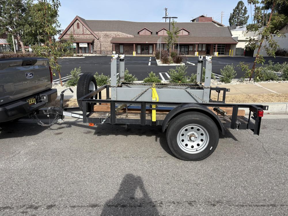

Mine wasn’t as large but this is how I moved mine from Los Angeles to Albuquerque. I rigged it upside down to keep the center of gravity low. It probably would have been okay right-side-up but I didn’t want to take any chances. The small trailer was rated double the 1200 lbs that it was carrying. IMG_1599.jpeg
