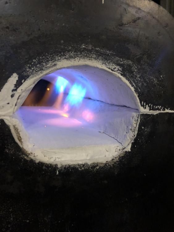

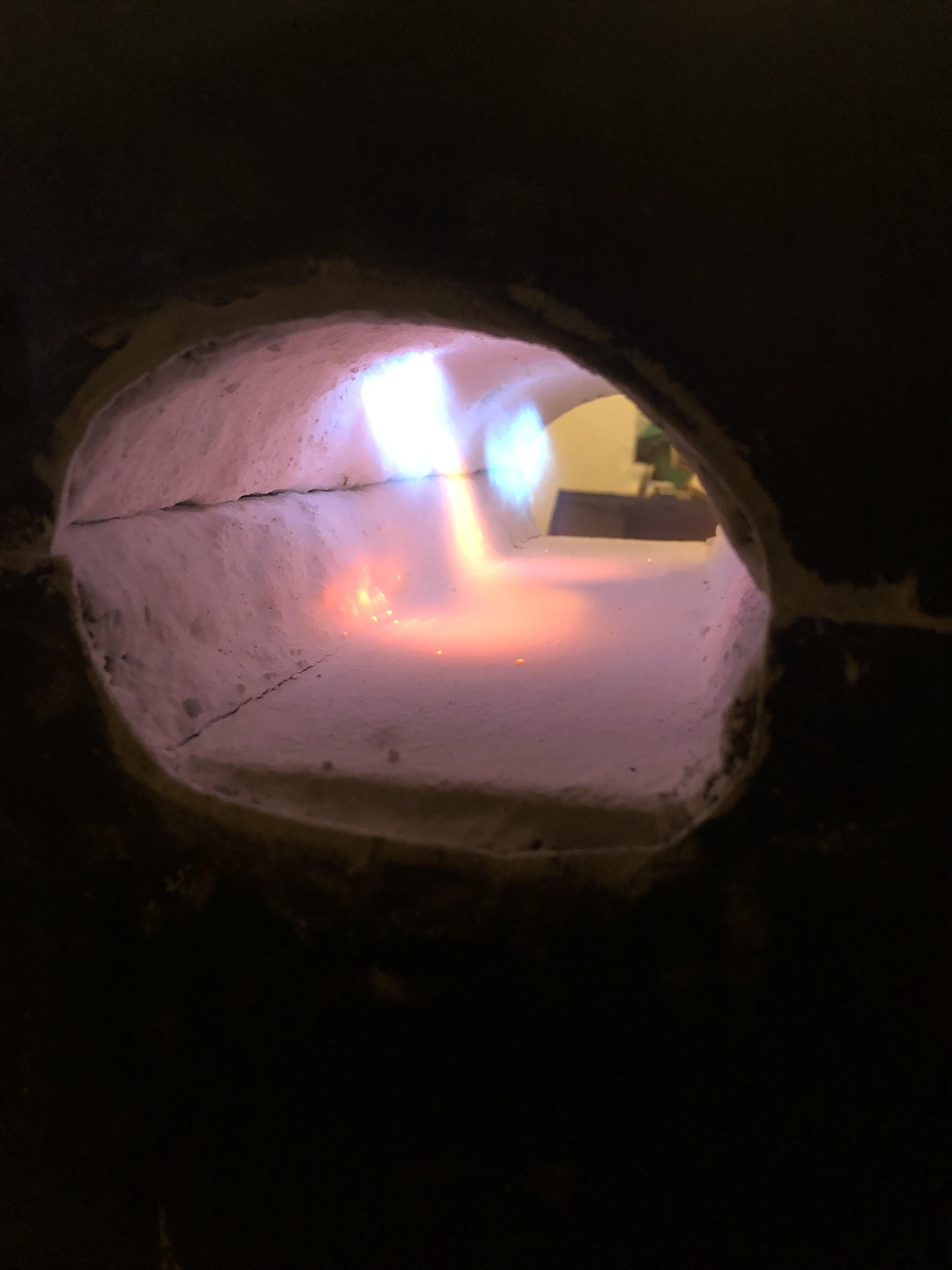

Finally lit the forge for the first time today. I just wanted some advice on tuning the burners. Fairly sure they're a bit fuel rich but I wanted some expert opinions on what exactly should be done. I have 2x 1/2" T-burners. First picture is the front flame, second is the back.
They look pretty good. Let them come to heat and burn a while to finish curing the refractory before you make any changes. How far into the liner are the burner nozzles? The one burning off the end has me wondering.
Frosty, They're both about 1/2" into the lining. I've only had them running around 6-7 psi, but any dragon's breath that come's out is out the back for the most part, and blue. Not sure if that helps or means anything.
Is that 1/2" measured from the shell? The front burner is putting out more volume or at a higher velocity forcing the exhaust mostly out the rear. Were I to guess from 3,500 miles away I'd say check the jet on the rear burner for a burr or obstruction. Provided the rest of the construction is the same. IF the jet in the front burner is trimmed back from the throat farther it could be burning harder/faster but I'd expect it to be leaner.
The 1/2" is measured from the outer shell. The mig tips should be relatively clean I think, haven't touched those. I did manage to bends a few flatter portions in the coil loop on that back burner, might that be the issue?
Yeah, that could be restricting the propane flow. Was there a reason you coiled the tubing? I stopped doing that a while back and just but a couple snaky bends in it as a cushion. I use a spring coil type tubing bender.
I’ll go ahead and swap out that section of tubing and see how it goes. Would you recommend I trim the mig tips back a hair, say 1/8”?
I'll also add that after the forge got around a nice orange color that back burner flame began to flicker every now and again as well.
One change at a time! Then test to heat in the forge and take notes. Get them burning evenly before you start tuning.
If they actually need further tuning after you do get them burning evenly I'd try trimming them less than 1/16", probably 1/32" at a time. They're darned close now and 1/8" is a major adjustment. Also make sure the jets are aligned with the tube when you reassemble them, they're easy to bump.
I'm not surprised the back burner started stuttering, most of the exhaust is going out the back and is being taken in by the back burner.
I replaced the tubing on the back burner and I'm not sure it's gotten any better. The flame in the back is now smaller and slightly green. The front flame also shows hints of green at times as well. I've checked the jets and they look lined up properly. If I remember correctly, green = fuel rich and that should be a sign to trim the mig tips?
Slight edit: The back burner tube itself was slightly tilted out of alignment with the flare I cast in the refractory, I tweaked that a bit and now both flames look to be the same size, the rear flame is definitely more green, and the front is only a hint green at times.
The green is probably just copper oxide knocked loose when you changed the tubing. Not uncommon.
The close one appears to be burning off the nozzle. If the burners are close to the same there shouldn't be that much difference. It still looks like the one in back isn't drawing as much air. It's richer and not so long nor hot.
The front burner looks to be acting like it has to much pressure. So, leave it alone and see if you can get the rear burner drawing enough air.
Just to make sure, they have the same parts, same: T, tube, gas fittings, jets, nozzle flare, etc. all the way back to the regulator. Yes? You made them as close to exactly the same as you could right?
If so something is tweaked or blocked somewhere. Do you have torch tip files?
Frosty, I forgot to take another picture so that last one isn’t the most up to date, my mistake. Everything for each burner is as close to the same as I could get it to be going back to the brass tee flare fitting that splits my main propane line.
