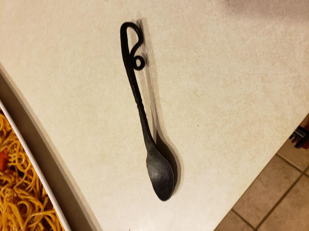

Thank you, I will do some more work on it and research decorative filing.  I really enjoy the ornamental kind of stuff but figured I would give a knife a try.  Once I can build a longer forge, I plan to build some tools like tongs.  Attached is what I have making to learn and practice.  Take care.  Max
Hey, the other work you did (aside from the knives) is darn well excellent for your experience.  I’m thinking I need to go back to the basics and make some leaves....again....
Your forgings look darned good, well done. The knife shows good skills all you need to know is how to employ them. Maybe direction is the word I'm looking for. The leaves are marketable and your bottle openers look nice a little style and they're sellers.

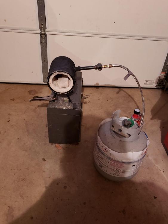

You don't need a longer forge, you can only work about 6" at a time and heating more will degrade the steel for no good reason, even if you were making swords. Honest, take it from a guy who keeps making forges too large.
Frosty, Thanksfor the comments. As for the forge, should I just make an opening on the back to feed the metal through, so I can heat longer pieces like tongs? Thanks!

Yes, pretty much every type of forge profits from being able to stick long pieces *through* it so you can heat the middle of a long bar!

Max, is your forge lined with something other than the wool?  I can't tell from the pic of your forge,  I've seen a lot of newer forges popping up on forums lately that just have the Kaowool with no other coating.  Uncoated ceramic fiber insulation will start to release tiny fibers once it is fired.  These fibers can get into your lungs, and cause serious health issues.
There are a number of slurry coatings that people use for this, but I'm not a good source of info on which ones are best.
Good point on the forge lining.  Some kast-o-lite 30 is in order for sure.  A LONG read of the two main threads in the gas forges section will explain all.
rhitee93,
My forge is lined with a single 1" layer of kaowool. I then coated it with ridgidizer and the sealed it with ITC 100-HT. I also added a cheaper refractory to the outside of the can but I am not sure it actually adds any value. Thank you for the kind remarks.  Max.
Good deal Max.  I've seen a bunch of forges lately coming from eBay that have no rigidizer, and people have been firing them up not realizing the danger.
Yeah, it is very scary stuff.  I see a lot of experienced blacksmiths (at least on the dreaded YouTube) using forges without ridgidizer or a refractory coating and no respirator. I am fortunate that I found iforgeiron.com before I got started and received a ton of guidance from a bunch of the members. It is nice to have a great resource of information and members who are helpful and interested in advancing the skill. It is valuable to me since I do not have any schools nearby and have been unable to find any other smiths to learn from.
