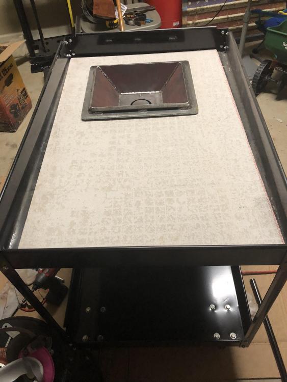

Since I will be moving into a new house soon I needed a forge that was portable. I'll be forging outside under a canopy until I'm able to build a shop/storage shed. I used a firepot from Fiery Furnace Forge, and a $55 36"x24" service cart from Harbor freight. I'm using a hair dryer for a blower right now until I can afford a hand crank blower. I do plan on cutting down some of the walls later on if i end up forging larger pieces. After a few uses im going to assess everything, and i may end up welding in a frame on the buttom of the top tray for better suppoer of the firepot.

That'll make a nice one! I'd consider investing in a piece of cement backer board to lay under the fire pot rim to help isolate the sheet steel from the heat and minimize the chance warping.

Thanks for the advice! I was wondering if i would need to insulate it. I just looked up the cement backerboard and I'm not seeing many that are smaller than 3'x5'. I'll have to find some that are smaller

Backer board cuts easily. Take it slowly with a skill saw and carbide blade. Do it outside, wear good eye protection and a dust mask. Or, you can score it deeply with a utility (box) knife and snap it like sheetrock. To make the center cut out for the fire pot, score the perimeter and make a deep X all the way through the center. It'll snap like sheetrock. I MUCH prefer to use a skill saw, it's just dusty. I'm not a pro however.
The idea isn't so much insulation is it is spreading the heat more evenly. The backer board will dissipate it more gradually so the sheet steel won't have a HOT spot surrounded by cool to cold which will warp it. You can ram damp sandy clay into it about 1"-2" and do the same thin, maybe better but it's a LOT heavier and clay with a forge fire in it has it's own issues. Not bad ones but it's something else to deal with.

So should I just have it under the firepot, or make it fit the whole tray? If I make it fit the whole tray, then it will be more flush. I feel like doing just the perimeter of the firepot is going to get annoying since the firepot will be sitting up a lot farther than the tray, so scraping the coal in won't be as easy.  I'll probably just use a utility knife for it, that way I dont have to deal with a ton of dust.
I'd just cover the bottom of the cart it's not very thick, less than 1/2" IIRC. If you just want to do a spacer for the fire pot make it an inch or two wider and taper it so it's easy to scrape coal in.
I'm a KISS kind of guy, covering the whole bottom would be easier, waste less board be much less likely to break making and not take damage from rakes scraping up along the edges.
I was able to get some 1/4” Hardie backing board today. I cut is to fit the 24”x36” tray, then I spray painted it from underneath to mark the hole. Thanks for the advice Frosty. I’m hoping to get it fired up at least by next weekend. I can make some brackets to tie down my anvil.56F243DD-A40C-4510-8D1E-44E5759FC414.thumb.jpeg.c6461af1e34bcc092e9627f4231ab2c8.jpeg
