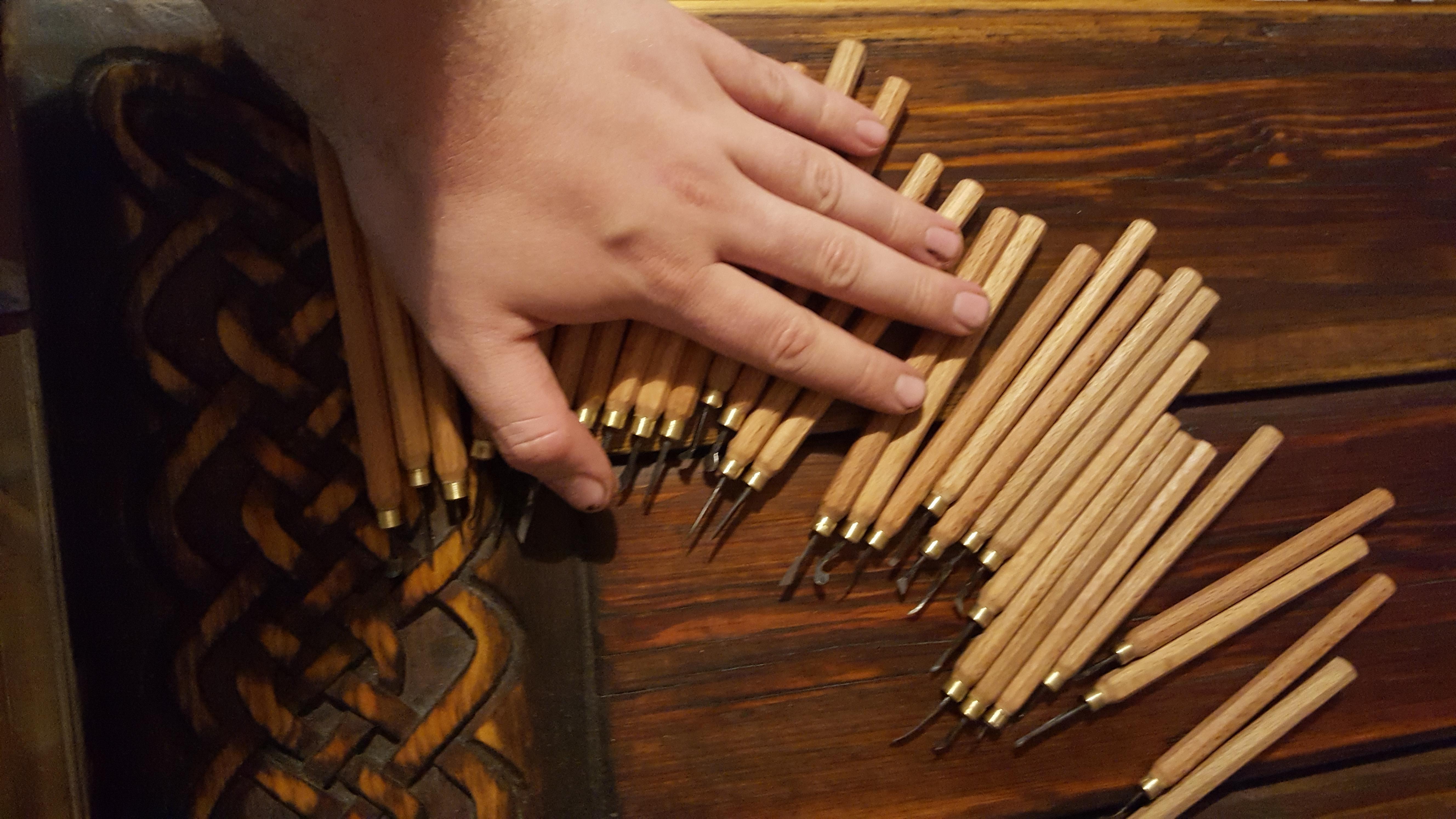

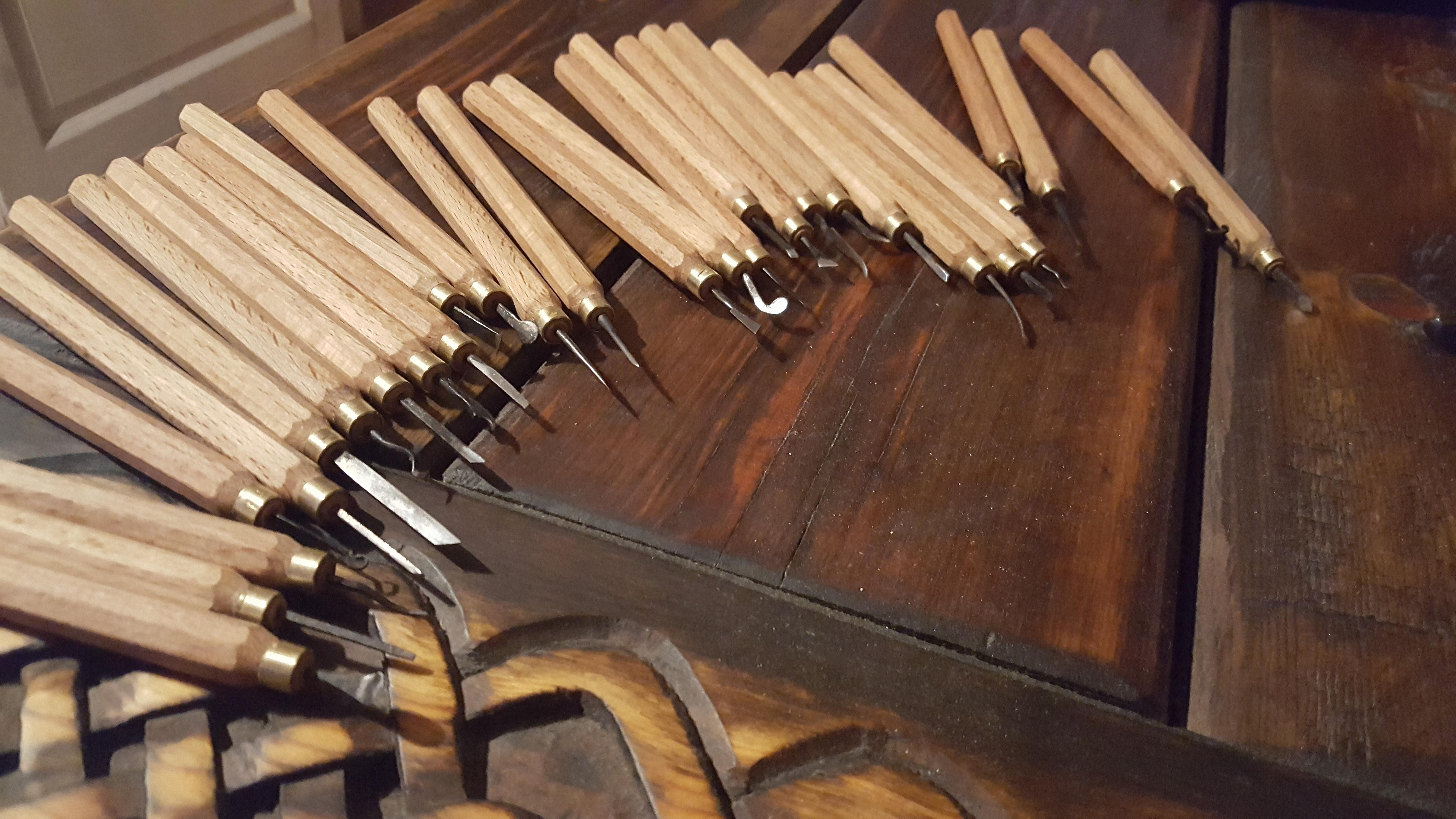

They turned out ok though from what i seen so far, they skate files and they flex like a spring, but we will see if they will break, since im using these myself im not worried about that. But I want to improve if they do break, so any tips are always welcome cause I want to become better. I know I will use these to carve wax so they wont have much strain on em but still want to make the best I can. Like I said not a professional but Ill get there eventually.
here are some pictures
Sorry 2nd pic is a bit blurry, but its for size referance.

You want to listen to Steve, he knows what he's talking about. There's probably a tempering chart in the heat treat section.
