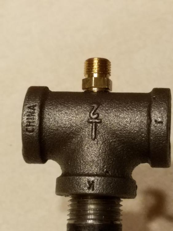

Well, with everyones guidance and recommendations I started with a small Bean Can Forge as a learning platform. Since then I've built a 1/2 Frosty T Burner and started a Coffee Can Forge (Pics attached).  I hope to have it ready to fire up by Sunday. Thank you everyone for your help!
I'd check with Frosty on the configuration of your 1/2" TEE burner.  From the photo it appears that you may have the following issues:
  1. Used standard TEE instead of reducing TEE
  2. MIG tip orifice has visual burr (orifice size is critical for these, what size tip did you use?)
  3. MIG tip may be already cut too short, making it difficult to tune
  4. MIG tip for this size burner may need to be a tapered type
Otherwise it looks like you are well on your way.  What were you planning on using for forge insulation?
Thank you for the input and I will certainly check those things out. I did go with a half inch by half inch t just based on someone else's recommendation who used to use a half inch T burner. The length of the Mig tip was just an estimate based on some photos I saw. As far as my insulation I'm using wool, rigidizer, and ITC 100 HT. I'm just starting out in making very small projects I'm hoping that I'll be able to reach a suitable temperature to learn.
