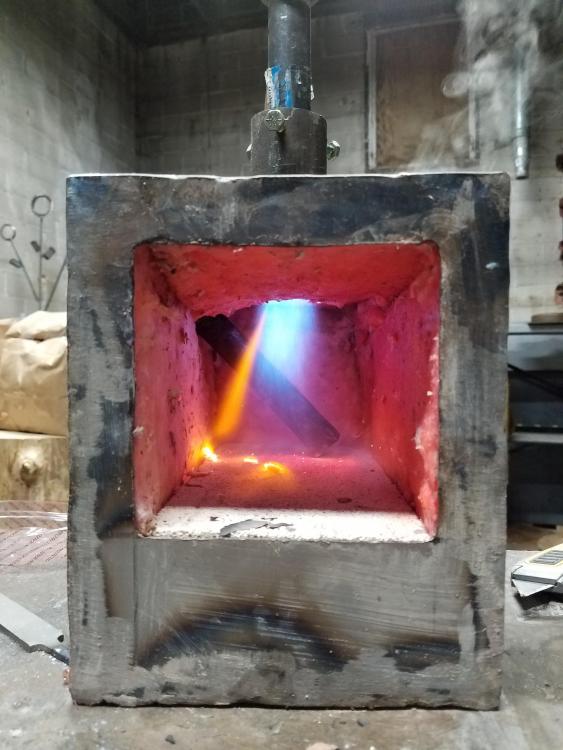

Mellin Posted March 29, 2018 Author Share Posted March 29, 2018 So I have been moving so I took the time to read threads and assemble supplies. Finally tonight I got out to the garage and set up my first two frosty t burners and rigidized the blanket on my test forge number 1. Picture 1 is my good burner at 10 psi Picture 2 is my good burner at 5 psi Picture 3 is the forge with my not so good burner idk psi Pic 4 is not so good burner at 5 psi Pic 5 is same burner 10 psi The first burner I show works better than the other but both seem ok. Maybe the second burning rich? The liner also looks like it was sagging but I fixed it while baking it. Will grab my scientific scale and measure zircopax and Veegum sometime soon this week and tonight I'm drawing plans for a correctly designed and sized forge considered just a single burner but since I started this one up I have been blown away. How hot should the mixing tube be getting on this burner? Mine got quite warm after 15 or so minutes. Mellin Here's the better burner burning 5 then 10 psi Quote Link to comment Share on other sites More sharing options...

Frosty Posted March 31, 2018 Share Posted March 31, 2018 A wobbly mig tip is also an indication of hand drilling and tapping, it's hard to keep the drill from wobbling when drilling so the tap can not cut smooth even threads. Unfortunately if you don't have a drill press or want to modify a hole saw to act as a guide you use what you have. Goop will help. Propane rated thread goop. YES? Your flame looks pretty good in the forge, how does it perform? Frosty The Lucky. Quote Link to comment Share on other sites More sharing options...
Mellin Posted March 31, 2018 Author Share Posted March 31, 2018 You are correct I did hand drill and tap I bought multiple fittings in case I messed up. The burner performs quite well and quite literally blows the little torch I had before out of the water. Quote Link to comment Share on other sites More sharing options...

Mellin Posted April 12, 2018 Author Share Posted April 12, 2018 I did not adjust the mig tip but changing to the new "flare" made it so the torch could not support flame outside the forge. Inside the forge the flame seemed to move away from the flare but the flames coming out of my forge are shorter it feels like. Quote Link to comment Share on other sites More sharing options...

Mellin Posted April 15, 2018 Author Share Posted April 15, 2018 I am going to take a spare mig tip and shorten it down more as the flame has done something a wee bit funny to me. I took the time to draw this masterpiece and I am assuming that the mix is still too rich at the mouth of the burner to support combustion so it moves away from the burner? The figure labeled old (reference pics from March 29) is where the flame sat before, definitely within the flare. The new coupler pushed the flame way off I can only assume that is bad? Inefficient? My logic is The volume of air intake doesn’t change in my 2 situations so if a change in flare causes the flame to walk away from the burner it is rich so shortening the mig tip will induce more air therefore bringing the mixture closer to neutral? Quote Link to comment Share on other sites More sharing options...
Mellin Posted April 17, 2018 Author Share Posted April 17, 2018 The new coupler that I have been trying has not increased performance as far as I could tell I tried trimming down my mig tip but that did not bring the flame within the end of the flare, this also made the flame on the old reducer flare end seem very flamey or not as jet like. Frosty do you have any guidance. i heated up a slug of some sort of metal, pretty hot but forge atmosphere seemed to scale the piece while in the forge more, unknown alloy. Quote Link to comment Share on other sites More sharing options...
Mellin Posted April 23, 2018 Author Share Posted April 23, 2018 So it's been snowy can't get to the shop snowy but finally it's nice and the snow melted. I took a picture when I first started up the forge. I can't tell if this is normal. I ran the forge for a while and it works great I can't tell if it is better or worse than the other flare. Does a frosty t burner need secondary air? I feel like the pieces scale more with the frosty style flare I'm no expert. This is my first item I am making well a pair of tongs. They don't match. I still need to draw one out about half an inch and the area around the pivot point are sloppy. Quote Link to comment Share on other sites More sharing options...
