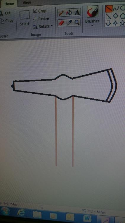

I have been commissioned by a friend to make two twin axes. I have no experience making axes so I figured I would ask the experts.
He wanted them to be made completely of high carbon steel and to have a thick handle (as he has large hands). He drew something like this (the image from paint)

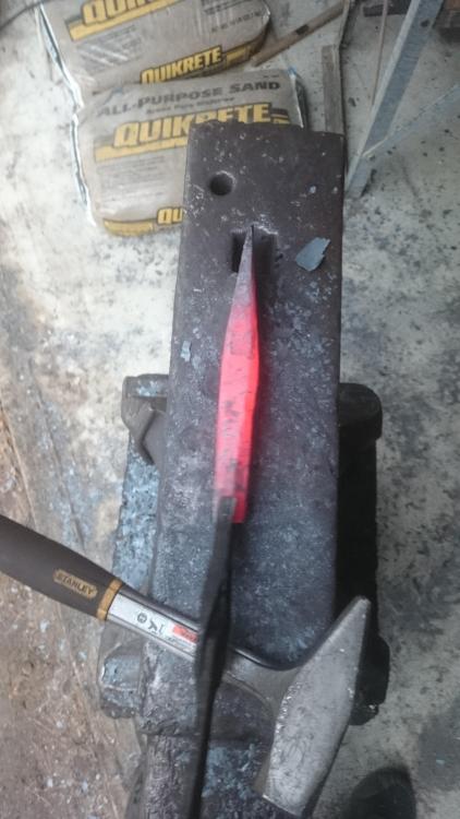

I have started one of the axes, I am using railroad connectors as my metal. My problem is not knowing the best way to punch through this metal and then drift it. I was thinking about drilling a hole through it but I am not sure if that is the best way to go about it.
After looking at videos and posts I think I am going to use a slitter and make the hole that way.
