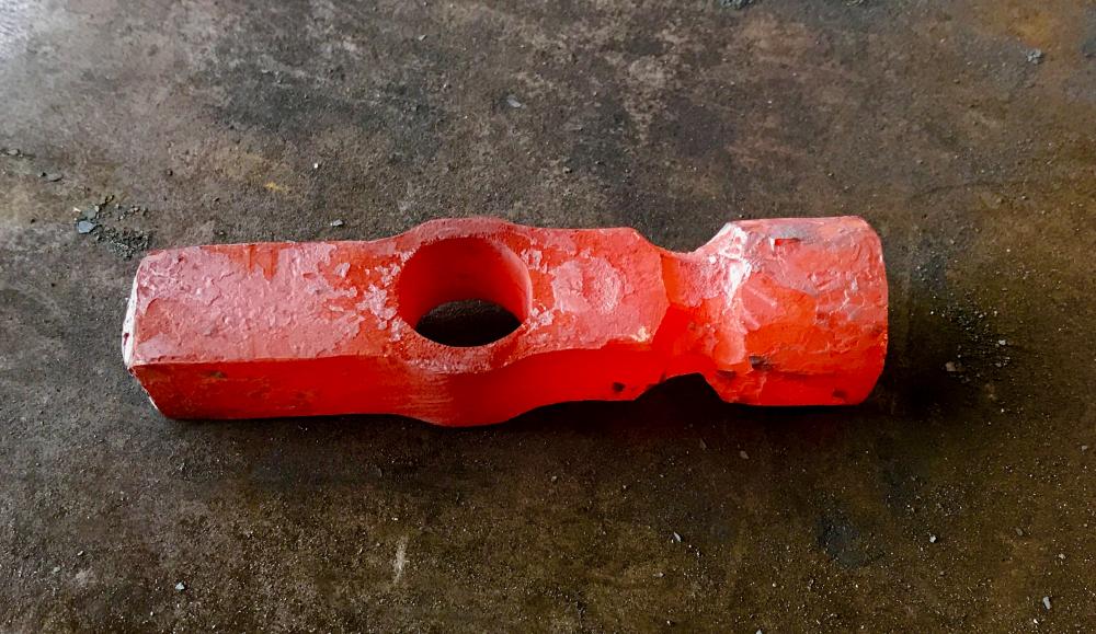

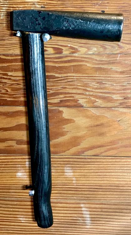

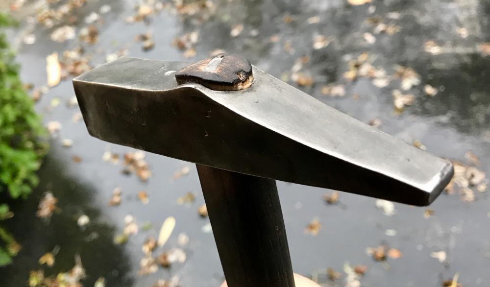

MilwaukeeJon Posted October 22, 2017 Share Posted October 22, 2017 1) Viking style hammer (17 ounce, 1045) 2) Mini hammer (in process, will do cross peen on back side, 1018) for a 4 year old 3) large Japanese style bladesmithing hammer (head is 6” x 1 1/2”, 1045) Quote Link to comment Share on other sites More sharing options...

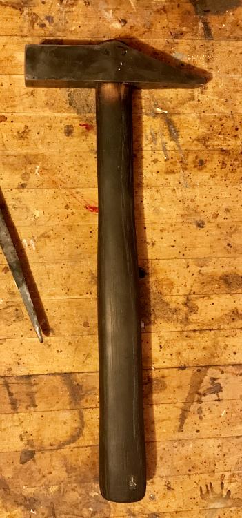

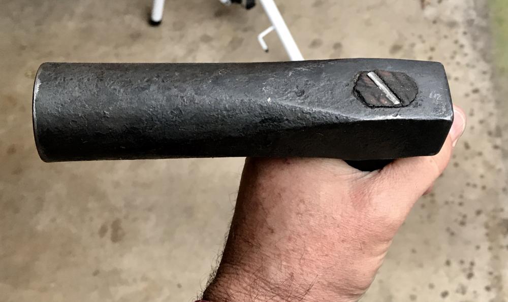

MilwaukeeJon Posted October 22, 2017 Author Share Posted October 22, 2017 Two more shots....simple forms but I have to start somewhere relatively easy! Quote Link to comment Share on other sites More sharing options...
