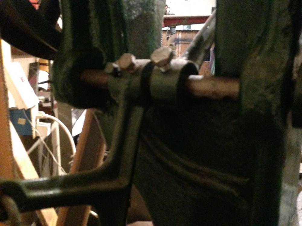

mitchell Posted September 24, 2017 Share Posted September 24, 2017 I just picked up this champion no.1 and it has some old repairs to it which leads me to wanting to find the correct original look. From the operating rod to. Rake and tensioner has been fixed up but looks like garbage. Anybody have pictures of an all original no.1? Or where to find a manual ? Thanks p Quote Link to comment Share on other sites More sharing options...
Judson Yaggy Posted September 24, 2017 Share Posted September 24, 2017 Here are the best pics I have of the idller arm on mine. Will try and remember to snap some more when I go out to the shop later. Quote Link to comment Share on other sites More sharing options...

mitchell Posted September 27, 2017 Author Share Posted September 27, 2017 Here are the best pics I have of the idller arm on mine. Will try and remember to snap some more when I go out to the shop later. Thanks, would you happen to have a picture of the casting where the bottom die sits? Is it suppose to be a dovetail? The casting on mine is hammered out and needs repair. It currectly has no dovetail, just straight sides in casting. Quote Link to comment Share on other sites More sharing options...

Judson Yaggy Posted October 9, 2017 Share Posted October 9, 2017 Yes it's a dovetail. And having the lower dt blow out is probably the most comon problem with Champions, it's the #1 design flaw with them. I've seen what I think are original dies with an extended cross shaped lower section to provide more bearing in the dt. Here are some pics of my dies and keys. I ground, filed, and scraped new oversize female dovetails into the anvil (no sow block, grrr) and eventually used a hot fit larger key and the copper shim trick with a reverse taper smaller key to get it to stay put. Also included some awkward angle pics of the idler arm. This hammer is stuffed tight into a corner of the shop and for space reasons I mounted the motor down low and refersed the usual orientation of the arm. Also turned an extension for the pulley axle to get motor, idler, and main pulley to align with an oddball motor location. Thus the tight pictures but I hope you get the idea. Quote Link to comment Share on other sites More sharing options...
