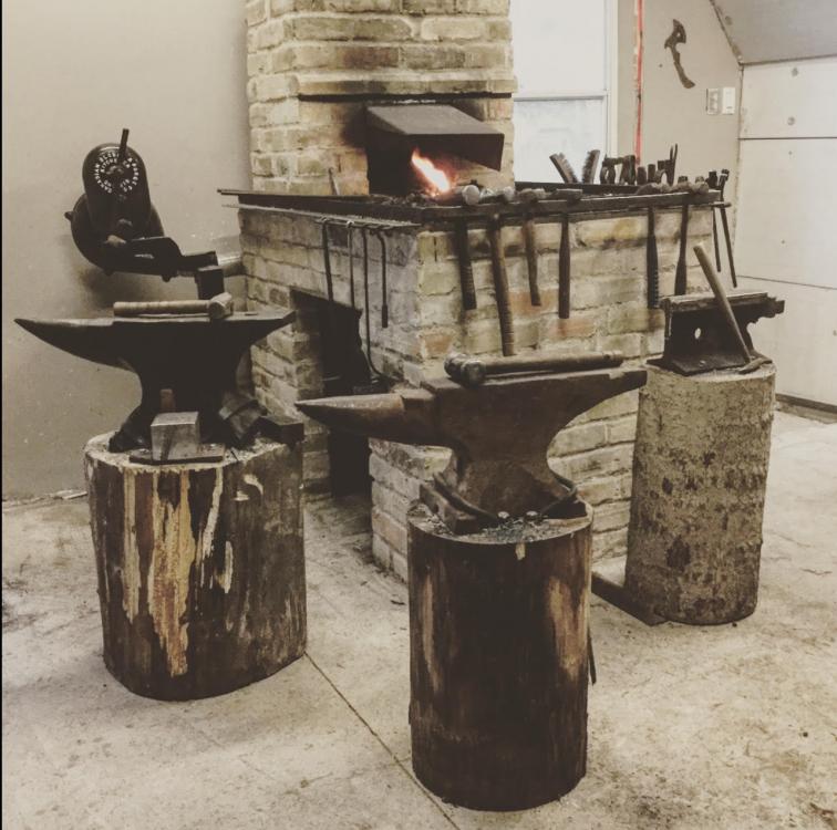

finally got it dirty, chimney draws very well. Reminds me of being in school 20 years ago. Anyone in the Hanover area of midwestern ontario welcome to stop by anytime!
