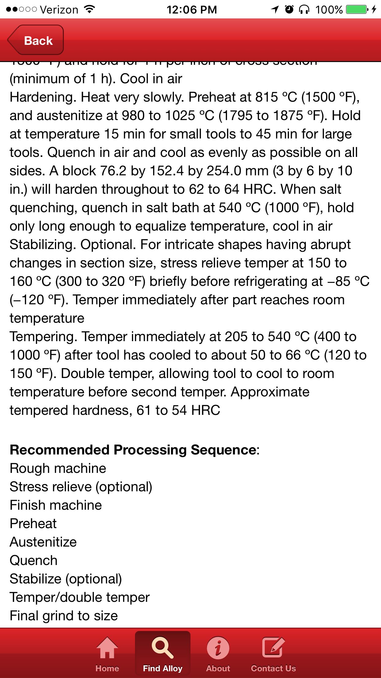

Johnnyreb338 Posted September 7, 2017 Share Posted September 7, 2017 Good afternoon friends. I need a bit of guidance on heat treating D2, I recently took on a 4 knife project for some meat cutting/ butcher knives. I've exclusively used basic oil quenched steels up to this point, but being used in a moisture rich environment I opted for d2 being it's semi stainless hopeing it would resist corrosion a little better. Well I thought I had done my homework and had a plan for an air quench chamber. Well the first blade was a complete disaster. Now I have to order another piece of stock to complete my project. Anyway I am useing .170 thick x 1.750 wide bar stock from alpha knife supply. I hammer forged the cutting edge of the blade to profile the cutting edge as well as to put a curve into the blade as per the customer. As suspected I file tested it after it cooled and it work hardened pretty good. To quench It i used a piece of tubing and capped 1 end and plumbed my compressed air into it with a ball valve. I heated it to a nice dull orange color and let it cool 2 times to normalize. Then heated to a nice florescent orange, held it therefore 15 min to soak, and into the air chamber for quenching, pulled it out file checked and no go, it chewed right down it. Repeated again, same results. At this point I normalized it again and reheated to an almost yellow and air quenched again, I could still cut grooves into it. Then panic set in, i increased the temp and melted the blade off in my forge. Sorry for my grammar and lengthy post. But any advice would be appreciated. Thanks Quote Link to comment Share on other sites More sharing options...

Jclonts82 Posted September 7, 2017 Share Posted September 7, 2017 From an app called "Heat Treat" Quote Link to comment Share on other sites More sharing options...
