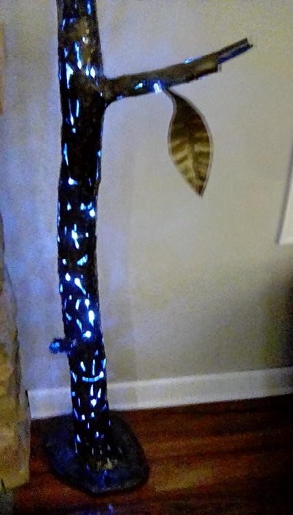

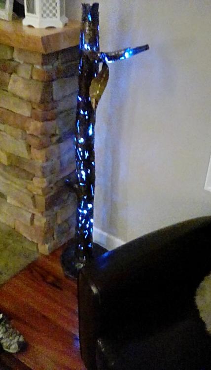

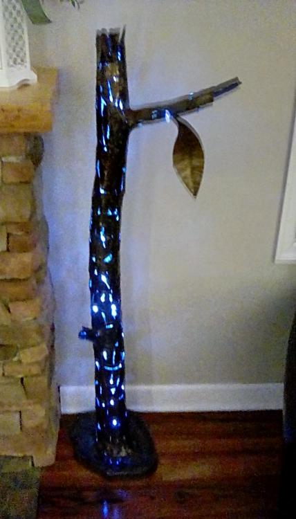

woodsmith Posted July 25, 2017 Share Posted July 25, 2017 My second tree shaped sheetmetal sculpture, (probably also second sculpture Ive ever done) made as gift. I work in auto restoration so we are constantly pitching replaced body panels, the cars are chemically stripped before we start metal work so the steel is perfectly clean, free of paint or rust, so this was once part of the quarter panel of a Dodge Polara convertable, sheared up into random shapes, hammer textured, roughly shaped and stitched together with a mig, picture fails to show surface detail entirely, texturing and mig welding is patterned together to create vines running up, I have 100' of led fairy lights inside so it has a remote control with multiple brightness settings. (I was thinking of the multitude of tiny lights effect from the trees in the Pandora movie) In any sheetmetal shaping, making a complex shape from one piece is very time consuming, making bigger pieces always adds work and challenge, this approach of sticking together small pieces like a puzzle helps to get from a small sculpture to a much larger one without things turning into an enormous effort while the overlaps and extra joints add depth and texture, more easily lead to organic shapes (long as I can stop the machinist side of my brain trying to make it perfectly cylendrical) ongoing expirement, turned out pretty good, I should think of something other than a to do tree next time Quote Link to comment Share on other sites More sharing options...
ausfire Posted July 25, 2017 Share Posted July 25, 2017 Nice concept. You are a very patient person! Quote Link to comment Share on other sites More sharing options...
Daswulf Posted July 25, 2017 Share Posted July 25, 2017 Cool. I like the added lights. Nice piece. Photos could be better. (I'm even still working on a setup to take better photos.) The things to make with just the sheet metal alone are infinite, then throw in the rest of the parts and you can have a lot of fun creating fun sculptures. Man, working with the old sheet metal on cars is so much better then the ultra thin stuff on modern vehicles. Looking forward to seeing more. Quote Link to comment Share on other sites More sharing options...

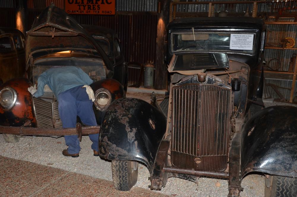

ausfire Posted July 28, 2017 Share Posted July 28, 2017 20 hours ago, ThomasPowers said: Need any packard hubcaps? I couldn't let them go to the crusher at the scrapyard---Just wish they had been still attached to the car when I found them... Not just now thanks, Thomas. These two (Mercury (l) and Packard(r) ) are on hold for a while. As I said, I need Das here to do the heavy metal panel work. Quote Link to comment Share on other sites More sharing options...
