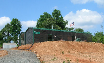

Jim Wilson had a building that would cover two 18 wheel tractor trucks AND trailers. One end of the building was totally open, the other end was one half covered.
He was burning the galvanized coating off some pipe in his gas forge, located in the middle of the building. See the stack above the roof. This was the total amount of pipe that was put into the gas forge, only a dozen or so pieces.
He had COPD and other issues and the fumes sent him to the hospital. Total time from fume exposure to death was only a few weeks.
We push safety on IForgeIron for a reason. Burning plastic, Styrofoam, and other things that produce smoke in the video is a BAD idea. Indoors it is a VERY BAD idea.
