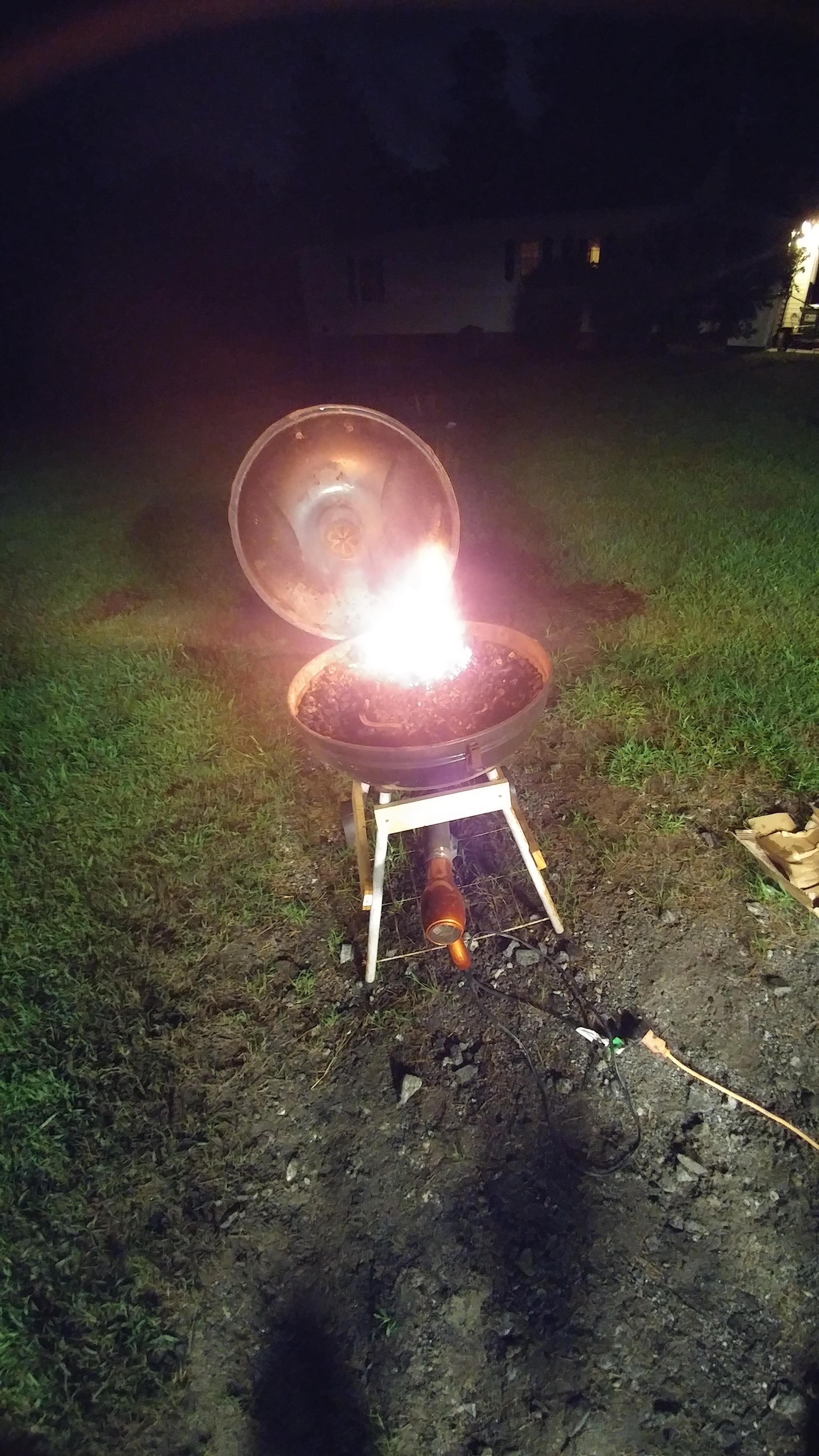

I decided to do the same thing a few months ago. I read somewhere that I could use a brake drum and stopped there. BIG MISTAKE. I wanted to reinvent the wheel I suppose. My current setup is rudimentary but gets the job done. I used an old charcoal grill with a brake drum. Then a month ago I decided to bolt a steel plate on top of the drum. I started out using wood charcoal that I made in a 55 gallon drum. I was burning through wood way to fast and use legit coal now. burns longer and hotter.
Pipe goes from to blow dryer to a tee, then one nipple goes down to a union with a plug to let ash drop out. Then out of the top of the tee into a flange that is bolted to the drum. This setup didn't cost me anything. Granted my wife got a little pissed about the hair dryer, I had a grille laying around that I didn't use, and I work where I can get all the 2" pipe and fittings I could ever want without the risk of being fired. Between craigslist and purchasing the pipe and fittings you might could come in under 50 dollars.
How do you get the center of a 3' long piece of steel into the hot spot of that forge?  And it looks like you need more air control.
I DEFINITELY need more air control. This was never supposed to be a permanent forge. Just something to get started on as I had everything I needed without spending any money. As far as "heating the center of a 3' piece of steel" I haven't yet needed to do that. I have made a set of tongs that I put bends in in order to get the center into the hot spot.
Cutting a slot out on either side of the grill will get you access to putting longer pieces through. Easy enough. And making a stand of sorts for the hair dryer so you can aim its blast At the pipe rather then directly in it so as you turn it away from the inlet it pushes less air in.
There are many ways to get the job done. Just because it isn't permenant doesn't mean some modifications won't help.
Slotting the grille would be a great idea. I'm thinking about dismantling and building a JABOD though. As good as this thing has been working for me its hard to get away from.
I'm pointing out that that is perhaps not an example to follow as that forge still needs some tweaking to get the most from it.  We get a large number of people here who don't have the experience to see what needs to be done to a setup and so sometimes copy a setup that wasn't finished yet.  As it stands your forge is a lot closer to being a good user than some of the ones we've seen posted on youtube as being "the way to do things".  Control the air and make a way to stick stock in horizontally into the hot spot and you'd have a forge ready for years of use!   BTW try removing the plug to the ash dump and see if that moderates the air enough.

Tried running the forge with plug out. It definitely helped.
