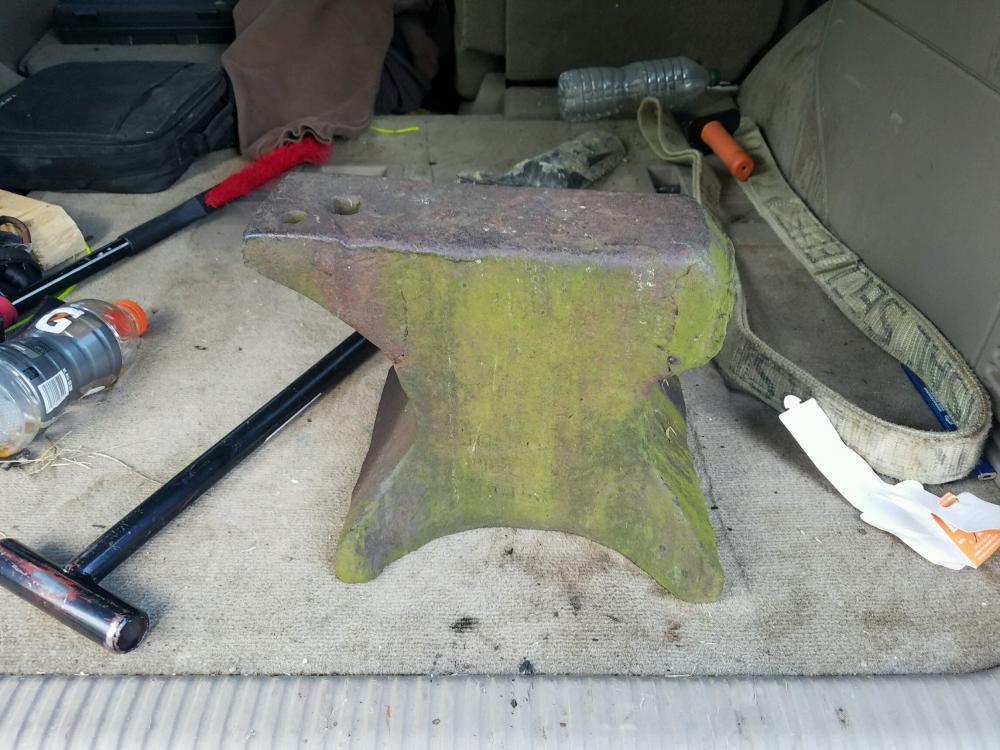

July 12, 20179 yr Buddy of mine picked this anvil up from a farm. Missing the horn but good usable space on it. Can't tell what it says on the side, might have to chalk paper it.
July 12, 20179 yr From a website called iforgeiron: Wilkinson Anvil's are of British manufacture. From "Anvils in America" Richard Postman notes that there were up to four (4) different Wilkinson companies/shops in the Dudley/Birmingham area making anvils. And at least two of these companies were exporting to the U.S. Probably Joshua Wilkinson

July 12, 20179 yr Actually tannic acid is a rust preventer; if the anvil is scrubbed down to raw iron and then soaked in very strong tea it should come out sort of a purple/blue/black colour...

July 13, 20179 yr Actually it was from an experiment decades ago on early medieval pattern welding. "The Sword in Anglo-Saxon England" H.R.Ellis Davidson listed a series of possible ways to develop the patterns in a pattern welded blade and besides selective rusting in salt water they mentioned tannic acid from peat bogs. Not having a peat bog handy, I remembered a chemistry experiment where we boiled a pound of tea for an hour and then extracted the caffeine and went an purchased the lowest quality black tea I could find. Boiled it up and left a pattern welded leaf shaped spear head soaking in it overnight. In the morning I removed in and it was covered with black fuzz. "Well that was a dud" I thought walking to the sink but when I washed it the fuzz slipped off leaving the pattern visible in various shades of blue/purple/black. I later ran across a cite on experiments in using tannic acid as a rust preventer in one of the old ASM manuals IIRC.
