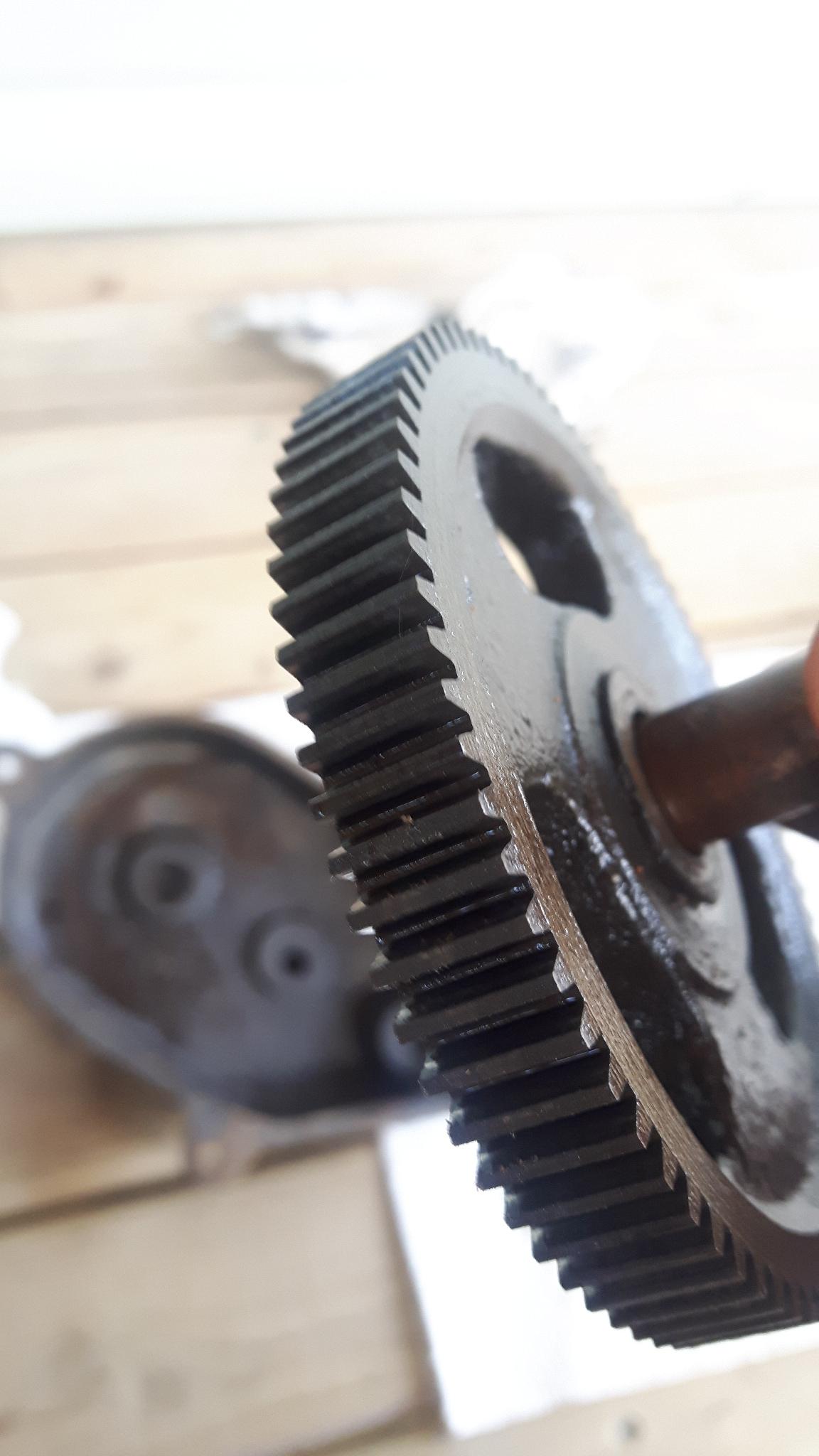

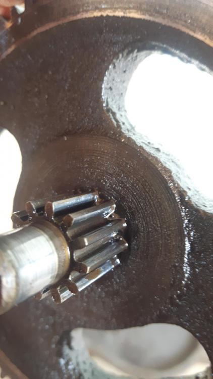

Shkyle Posted July 8, 2017 Author Share Posted July 8, 2017 From what I can see the blades look good but I don't know they look good to you Link to comment Share on other sites More sharing options...
ThomasPowers Posted July 8, 2017 Share Posted July 8, 2017 Blades are OK; do clean the crud off everything (case and blades) as smooth increases air flow. Now what do the gears look like? Link to comment Share on other sites More sharing options...

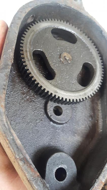

Shkyle Posted July 8, 2017 Author Share Posted July 8, 2017 Those look good? Link to comment Share on other sites More sharing options...
ThomasPowers Posted July 8, 2017 Share Posted July 8, 2017 looks almost unused! Clean, Sharp, no missing teeth. Case not jammed full of fossilized oil. Should run fine after a light cleaning and oiling! Link to comment Share on other sites More sharing options...
Shkyle Posted July 8, 2017 Author Share Posted July 8, 2017 How would you recommend me cleaning the blower? Link to comment Share on other sites More sharing options...
ThomasPowers Posted July 8, 2017 Share Posted July 8, 2017 Grease solvent and a wire brush and EYE PROTECTION, then flush with clean solvent. Place so it can drain and let it sit till dry and oil it good and reassemble. Is there an oiling fitting on it---over the R in forge? Get a small pump oiler and give it a dose every now and then. I assume there was no sign of a gasket when you took the gear case apart? These blowers were commonly more of an oil flow through system and will generally leak oil so watch out for clean concrete floors if you store it in the garage! (a tray of cheap cat litter can be a help...unless you have cats...) Link to comment Share on other sites More sharing options...
