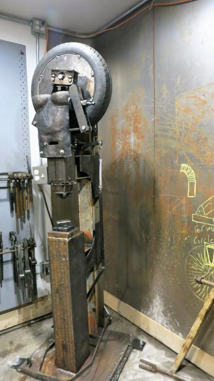

zadvorney Posted March 2, 2017 Author Share Posted March 2, 2017 I DID IT!!! Got the spring tonight and installed it on the arms. I made a few adjustments and bing bam boom away we went. Works like a charm. I'll post a video, to close this out, about the ins and out of the build at a later time. My power is out due to a wind storm so I'm on generator power so I'm done for the day. Quote Link to comment Share on other sites More sharing options...

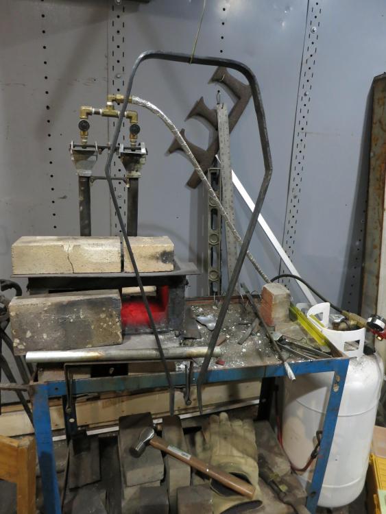

zadvorney Posted March 2, 2017 Author Share Posted March 2, 2017 So far I figure 55 hours and am close to the $1700 mark. I have some stock left over as I bought more on purpose but not much. I used everything on the list with the exception of a few nuts and washers. I can't say enough of how I enjoyed doing this build. An absolute blast. A great project to do with a kid or a friend. Spending some time in the shop playing with drills and fire and grinders is good for the mind and body. I used a Lincoln Electric Power Mig 210 for the welding. It performed flawlessly. I could have done the project with the old Tombstone AC stick welder from the 50's that I learned on, but the power from the mig and it's precision made it easier. I purchased a used Victor 42 plasma cutter for the project. I didn't use it as much as I figured. I used it when speed was priority over precision. An expensive piece of gear for sure. As I got used to using it, it got easier. I made a stand off jig so the tip couldn't touch the work. It also helped when I used a guide to rip along. The first time I used it was with damp and dirty air. I went through three tips and electrodes before I figured that out. $$$$$$$$$ So I installed a home built air cooler and water/oil separator. Better but it needs a micron particulate filter just before the machine to be perfect. A portable band saw was the BOMB for this job. My harbor Freight cheapo model had it's work cut out for it. A heavier duty one would have made my life loads better. Better still, a stand up band saw. Or a metal chop saw. Some high end bits and a metal hole saw set could be helpful. I got away with a low end set of bits and lubed the crap out of them as I cut. Never dulled a one. Broke a few when the work slipped off the drill table but that was my fault. A good drill table clamping system is on my list of things to get. The drill press I used is a 50's vintage as well. I rebuilt that a few years ago. So worth it on the build. You can't drill through thick metal with a hand drill. The more precise the holes, the easier the pieces go together. Definitely cut things as close to perfect the first time. Square things up. Be patient. Enjoy the ride. A very big thank you to Ray Clontz for the design and Clay Spencer for the excellent plans. My hats off to both of you. Spend the $30 on the plans if you are serious. Well worth it. Quote Link to comment Share on other sites More sharing options...
