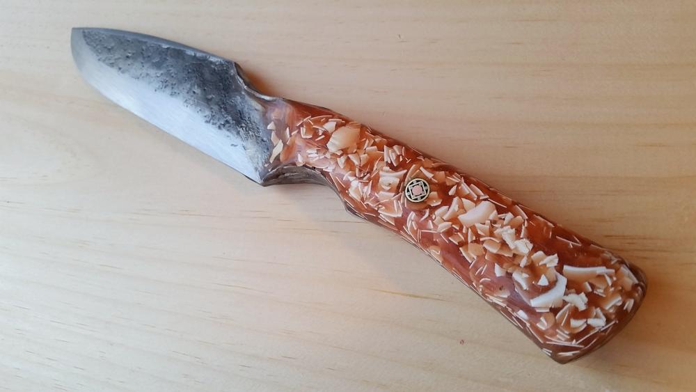

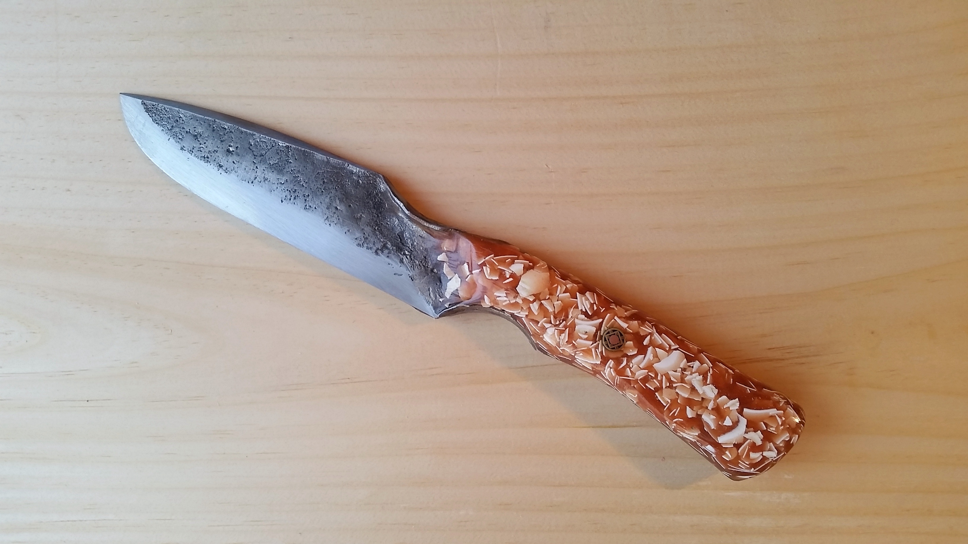

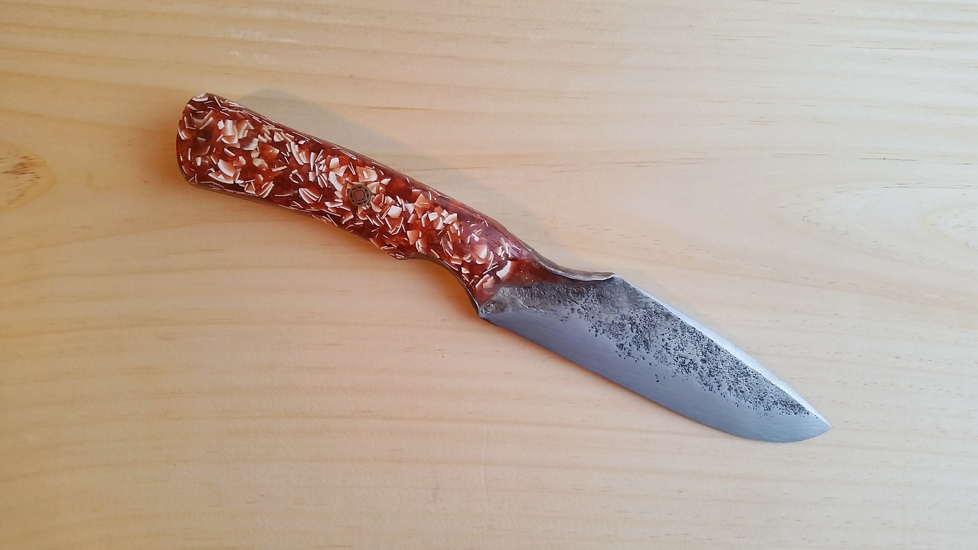

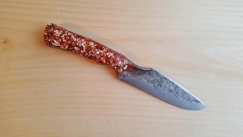

I've been having a lot of fun with this material, it's great for forging all sortsa wacky integrals and then not have to spend hours getting the scales to fit.

My favorite comment yet is that the material looks like someone vomited back up osso bucco and noodles on the handle... I'm still giggling

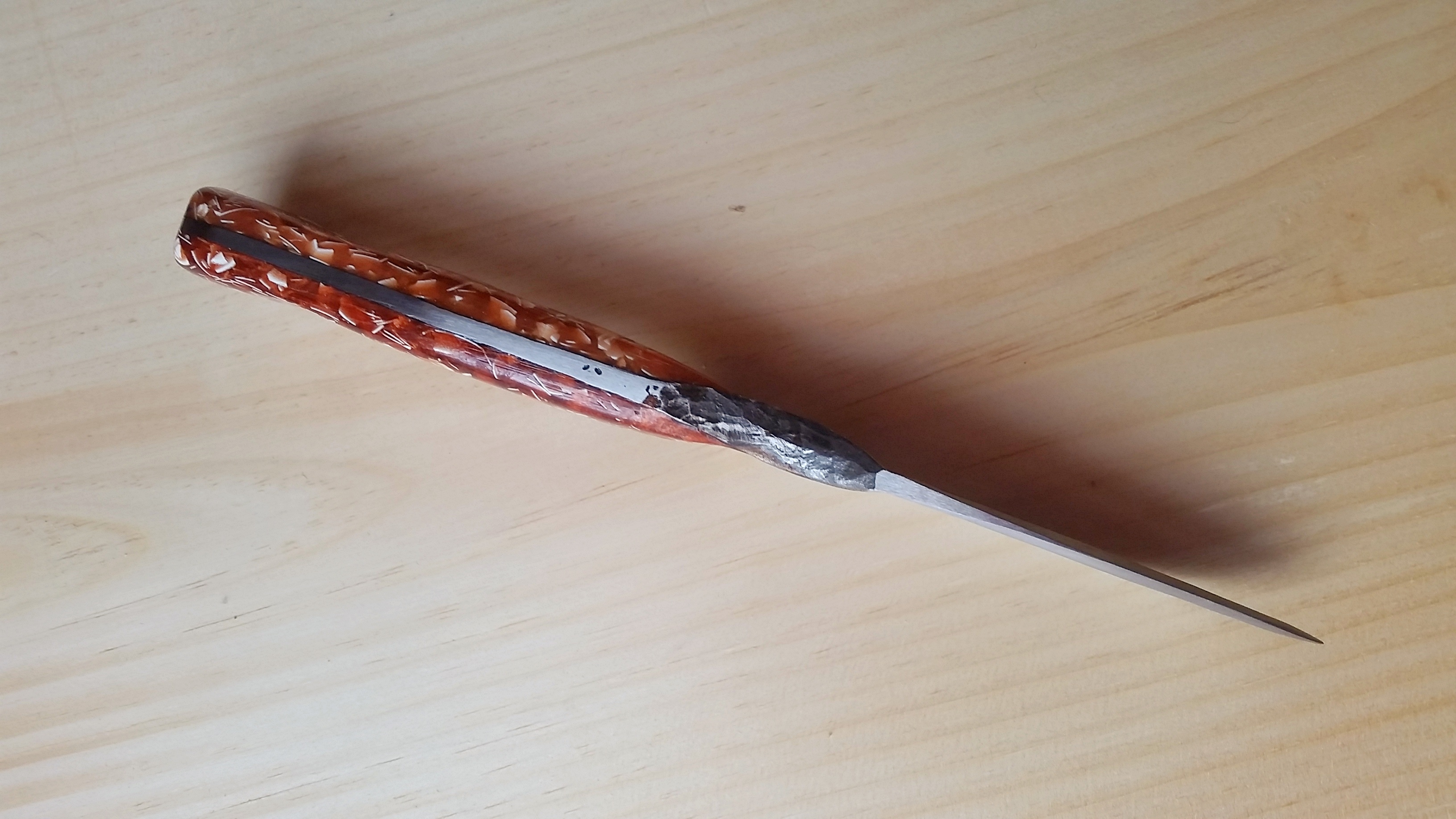

After forging and profiling the tang, I drill a couple holes and create a chamber to contain the material with artists tape, then literally mix n pour the material around the tang. It's easy to shape and cleans up nice.
