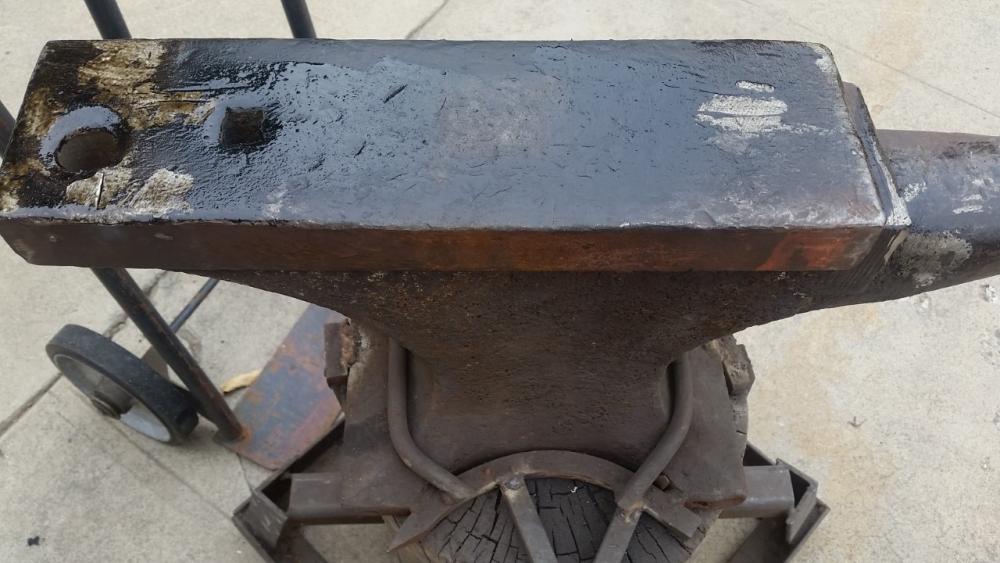

Well I was offered this anvil for one of my post vises...they said its around 200lbs...but I have yet to check it out...first wanted to get a idea of type of Anvil it is, quality....so here is a pic of it...I don't want to waste gas going to check it out just yet.
Anyone have any ideas...they said they cant see any marks..
Looks like a cast iron ASO, note the many hammer dings in the face and odd sized pritchel.  Have to be a pretty mucky postvise to be down to that level!

ASO just killed it for me....I was thinking kinda same, but was just making sure. Always good to get fresh eyes. Thanks
Wipe the oil off the face and try the bounce test on it but all the hammer marks would make me VERY suspicious.
An the "Fake" face plate is a warning sign too.
Is not a pritchel hole but a "heel hooking" hole. These things along with turning cams are common amongst cold shoeing cowboys who never learn how to use an anvil's horn properly. On this anvil it was added later on by some ham fisted individual but many low quality contemporary anvils and ASO's have this undesirable feature.
Pass it by it's another mutilated abortion.

i called him and passed on it. I think he seen "Sucker" on my digital forehead...but I've learned to be a bit more skittish and to ask around before buying lately....
Turns out he is a welder (has his own business)...so not sure if he put that plate on himself...but he mentioned he had other anvils Peterwright and Trenton he wanted alot more for....so made me even more weary since he feels he "knows" a good anvil yet he was so optimistic in trading this one away...
