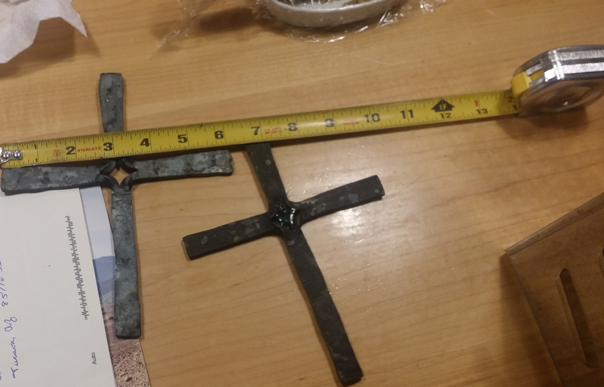

I need to get started on my N/A propane forge build and I have acquired three possible cylinders to start with. The small LP cyl is 9" across, the bigger one is 11 and the chunk of 3/16" wall pipe is 13". They are all about 13" tall. The second picture shows the crosses which will be the majority of what I plan to use this forge for. Problem is the crosses can be over 6" wide. I want to have the forge cubic inches small enough for one burner, but I would like to have room for at least a six inch wide cross, maybe seven. As you can see my dilemna would be a bigger cu inch area with two burners or a flatter design, instead of cylindrical. But this being my first gas forge build I am heeding the advice of you guys and sticking with one design without variation, like the Wayne Coe design so this pretty much leaves me with the cylindrical design. I also considered the one where you split the cyl in half then put it back together, which can then be opened  for wider pieces but seems like that will waste more gas than a two burner.
Any ideas welcomed.

What you need is important so start there, either a wide vault (D laying on it's flat side) or oval shape chamber an inch or two wider and longer than your largest project estimate.

I like the wide vault idea and I have the ability to build that shape easily. Here is how it is coming together in my head. If I make it 9"  deep I calculate 286 cubic inches. With a 9" x 9" floor it will easily accommodate my work.
I believe you have it! That's a good floor size and a great volume for a 3/4" burner, it'll have plenty of overkill for those special projects.
You can also align your burner flatter so it hits the roof of the forge first. This will heat the top and one side hottest and the curve will act like a lens to focus the IR radiation to a degree. However projects like spread crosses are fairly flat so aligning the burner towards the center of the floor won't make a flame shadow behind the work. Does that make sense?
