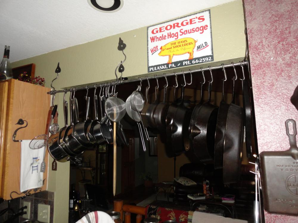

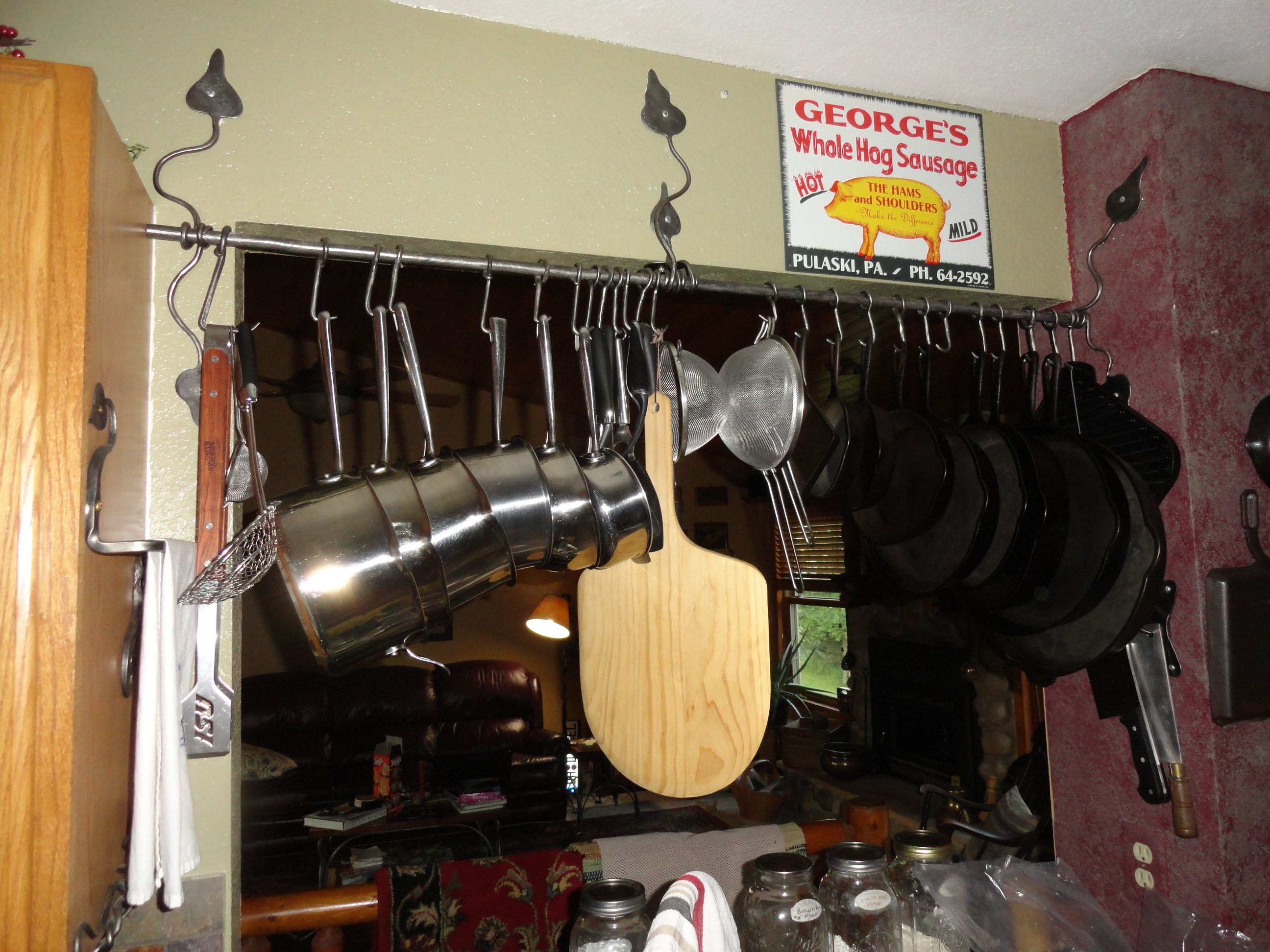

swedgemon Posted August 21, 2016 Share Posted August 21, 2016 In our home there is a nice large "window" that looks into the living room from the kitchen...DW has a goodly collection of stainless and daily user Griswold and Wagner cast iron, so a Pot Rack in the Window was a natural. The rod is 1/2" round, 54" long, textured on the power hammer and reverse twisted on a 4" repeat (hard to see). The leaves started out as 5/8" round rod, worked down to what you see supporting the rod. The hooks were 1/2" (or maybe 5/8" ?) round, formed into a ball, flattened and punched, then drawn out to form the hook...some of the later hooks were 1/4" round, tapered at each end and bent to the needed shape and length. Several mounts and dismounts were required to get the hooks in the right order and length(s) to get the pots and cast iron to properly nest. The finish is wire brush and a few coats of clear satin acrylic. As you might guess, I am one well-fed and happy metal mangler. Quote Link to comment Share on other sites More sharing options...
Frosty Posted August 21, 2016 Share Posted August 21, 2016 Nesting the pots and pans on the rack never occurred to me, guess that shows how much experience I have making pot racks. I like it. Nice sign, I like sausage too. Frosty The Lucky. Quote Link to comment Share on other sites More sharing options...
swedgemon Posted August 21, 2016 Author Share Posted August 21, 2016 Glad you like it, Frosty !! If you turn the pots 90 degrees, not many would fit up there...many years ago (1968) I learned to freeze professionally while I was stationed at Ft Richardson. I had Mountain and Glacier training (80-year old Hans Wagner was our primary instructor - the guy was tough as nails) at Eklutna Glacier and various aspects of being an Arctic trooper with a week of -40F (and lower) outside of Ft Wainwright, playing soldier in the snow in early 1969. Got to be pretty good on cross-country skiis but leave it to the Army to provide irony - a month later I was getting off the airliner in Ben Hoa, RSVN, at 100F in the shade so the other guys could shoot at me. Quote Link to comment Share on other sites More sharing options...
