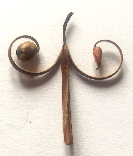

To prove my point...here is an illustration of a correct scroll! :)
Lesley has just this hour returned from a visit to an "open garden" and her friend gave her this bit of plant for me as it was scroll-y.
I thought it was too coincidental to be true!
You can see that the spiral part is pretty regular in its gradual and consistent transition,  but that the flower although it came off tangentially did not conform to classic form of the penny end scroll...obviously whoever designed the plant had not studied 18 century ironwork best-practice!
