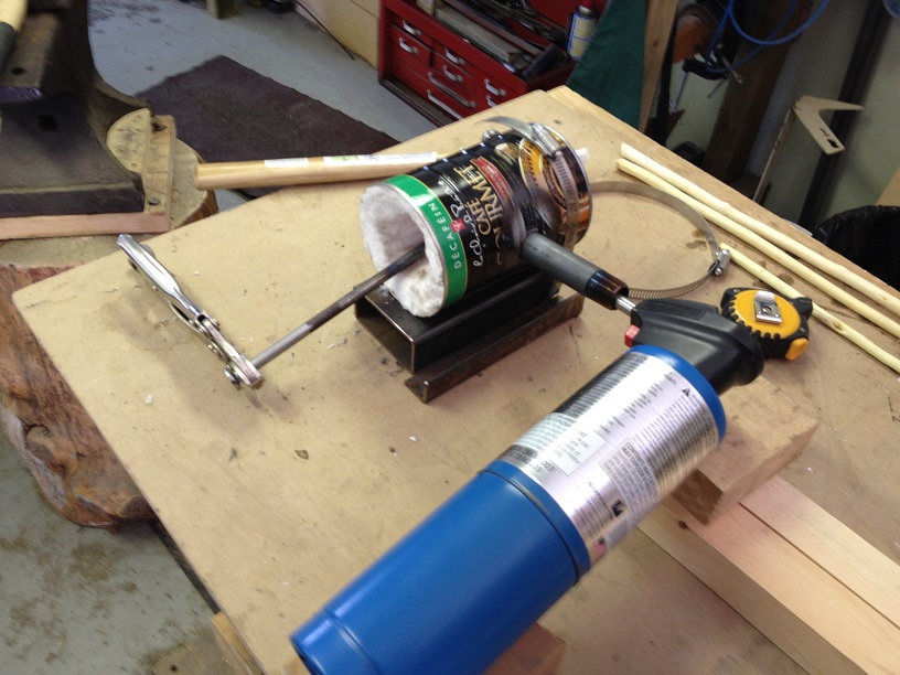

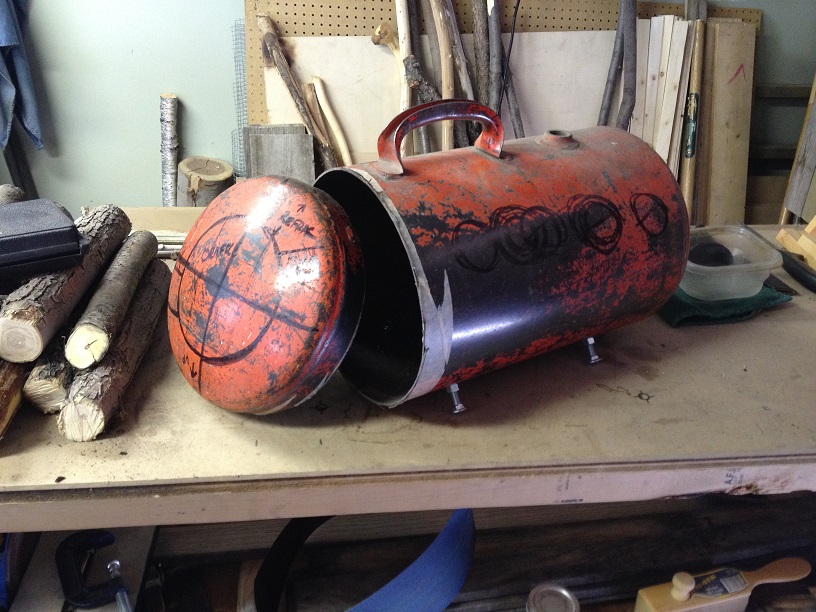

BlackMetalViking Posted June 30, 2016 Share Posted June 30, 2016 Here is a picture of the air tank I will be using for my forge. As well as the Coffee can forge I slapped together this week to keep me occupied while I build the big one. I am already thinking of upgrading to a better designed little knife maker with dedicated burners, any thoughts on using a spent fire extinguisher as a body? Quote Link to comment Share on other sites More sharing options...
ThomasPowers Posted June 30, 2016 Share Posted June 30, 2016 Shell doesn't really matter that much. I've seen a professional smith who needed a large forge for a project who just rolled the kaowool out to the correct diameter and used baling wire to hold it and stuck the burners into that. Now a heavier shell helps resist erosion/corrosion of the steel where it comes into contact with hot gasses and you can also use it to weld various bells and whistles to---like a sliding third hand to help hold longer but not tipping over long pieces in the forge. But it's not necessary. Quote Link to comment Share on other sites More sharing options...

Frosty Posted July 1, 2016 Share Posted July 1, 2016 I don't have anything to add to what Thomas said except maybe I really like stainless steel stove pipe for cylindrical forge shells but that's a long post. About the coffee can forge. Lose the piece of water pipe, all it is doing is introducing excess air (oxygen) to the fire. Pull the torch tip far enough back in the liner it can get combustion air and it will keep cooler as well. Another indicator the pipe is hurting performance is it turning blue, that's heat wasted. Frosty The Lucky. Quote Link to comment Share on other sites More sharing options...

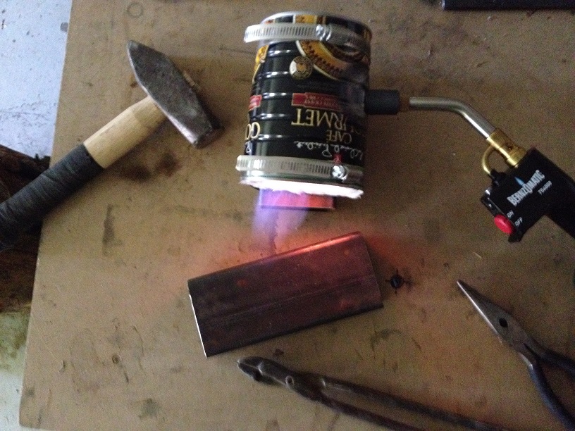

BlackMetalViking Posted July 3, 2016 Author Share Posted July 3, 2016 Thanks Frosty! I've already made a couple of improvements which have made a huge difference. I bought a new torch that fits very snug into the pipe nipple, which itself has been significantly shortened, I just use it as a mount now. I'll post a couple more pictures with the improvements. I can say that its functionality has improved tenfold. Viking Quote Link to comment Share on other sites More sharing options...

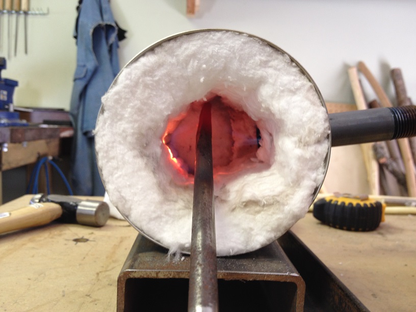

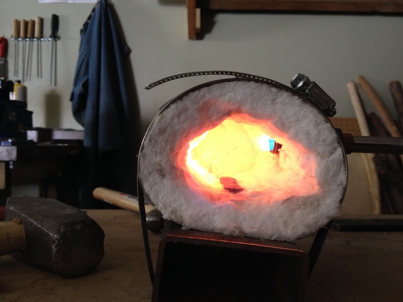

BlackMetalViking Posted July 6, 2016 Author Share Posted July 6, 2016 Here are a couple pictures of the improvements I made, including the new torch. It works perfect for arrowheads (that's what is in the forge). I'm sure I can pound out a couple knives with the thing, but I think I'll need an upgrade very soon for that. On 6/30/2016 at 6:12 PM, Frosty said: I really like stainless steel stove pipe for cylindrical forge shells but that's a long post. I'd be interested to hear some more on this Frosty, if its not too much trouble. I'm always looking for a better way to do something! Quote Link to comment Share on other sites More sharing options...
Frosty Posted July 6, 2016 Share Posted July 6, 2016 Looks like you're getting good heat. You need to pull your torch tip back out of the chamber entirely or it's going to burn off. Also, it's aimed directly into the angle made by the vault and the floor, aim your burner upwards a few degrees so the flame impacts the liner across the top. Firing into the corner makes unnecessary back pressure reducing the burner's efficiency. I like Stainless, (SS) for a couple reasons. It's tougher so it's less likely to deform or warp from escaping heat or weight. It IS a little harder to work with but not a lot. SS is much more IR reflective than plain steel so more heat is reflected back into the forge. I pay for that heat I want it to stay where it's supposed to! A 10" dia. cylindrical forge made with black stove pipe using 2" kaowool and after an hour's use you can touch the shell it's about like a fresh cup of coffee. A SS shell on the other hand is warm. All things being equal. I didn't have access to good furnace building information or I should say I didn't look based on the preconception a forge wasn't just a furnace. They are just furnaces the only differences are tweaks to make them more efficient for specific uses. Anyway, in the day I thought I was one clever hombre when I washed the inside of my Kaowool forge with Kaolin clay. Welding flux just make the Kaowool go away on contact and the kaolin kiln wash was a whole lot more durable. Still not terribly good but WAY better. I haven't made a cylindrical forge to use in I don't know how many years but I've been thinking about a vaulted forge for the superior circulation the shape lends. Tristan has also made a darned good argument for using updraft burners by demonstrating how well one works. His 2 brick forge's burner is aligned tangentially to the left side aimed almost straight UP. Your forge is coming along nicely. Still room for tweaks of course but all round, well done. Frosty The Lucky. Quote Link to comment Share on other sites More sharing options...
ThomasPowers Posted July 6, 2016 Share Posted July 6, 2016 I can't tell from the pics; but do you have the adapter to run the torch off a BBQ sized tank? MUCH cheaper! And I agree on pulling it out so just the flame enters the side hole. Quote Link to comment Share on other sites More sharing options...
Latticino Posted July 6, 2016 Share Posted July 6, 2016 Please consider coating your refractory blanket with some type of sealant (even colloidal silica is better than nothing) to reduce the fibers being blown into the air. Take this advise from someone who didn't for 10 years of regular glass blowing and now has scarred lungs to show for it. Quote Link to comment Share on other sites More sharing options...
