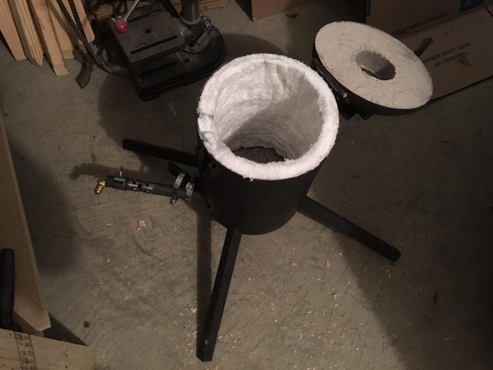

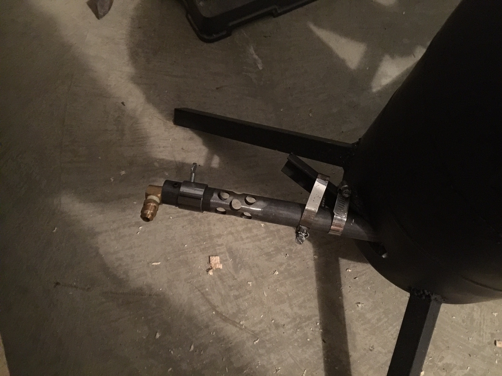

David Durman Posted June 24, 2016 Author Share Posted June 24, 2016 I finally finished this foundry. Here are some images of it; does anyone have any suggestions? It still needs a first firing, but I am going to wait until I get the crucible I am going to use so I can cure them both at the same time. Quote Link to comment Share on other sites More sharing options...
ThomasPowers Posted June 24, 2016 Share Posted June 24, 2016 what are you planning to melt in it? (temp ranges are an important part on choosing refractories, an Al foundry would use different stuff than a steel foundry...) Quote Link to comment Share on other sites More sharing options...
David Durman Posted June 24, 2016 Author Share Posted June 24, 2016 Planning on making bronze with it, so copper-melting temps are the highest. The ceramic wool is Cerablanket 2400F and the castable refractory is a commercial mix rated for 2600F. Quote Link to comment Share on other sites More sharing options...
Frosty Posted June 24, 2016 Share Posted June 24, 2016 How much space is around crucible? I'd certainly have put 2" of Kaowool or equivalent blanket in the melter but that's just me. The casters I know call their studio the "foundry" and the furnace they melt metal in a "melter". I know I'm bordering on semantic nit picking but it's the same misnomer you see so often when people call a blacksmith's shop a "forge." The forge is the fire place you heat the iron/steel in, not the building. Bronze has a lower melting temp than copper, it's the eutectics of the alloy. If you break the copper up small enough and add the tin before you start the melt the whole mass will melt at a lower temp than copper. Frosty The Lucky. Quote Link to comment Share on other sites More sharing options...
ThomasPowers Posted June 24, 2016 Share Posted June 24, 2016 On the other hand he intends to *make* bronze and so will start by melting the copper and adding the lower melting temp alloys. I would get the crucible and get the lifting tongs you plan to use on it and see how much side room you have to pull the crucible without hitting the walls. Quote Link to comment Share on other sites More sharing options...
David Durman Posted June 24, 2016 Author Share Posted June 24, 2016 1 hour ago, Frosty said: How much space is around crucible? I'd certainly have put 2" of Kaowool or equivalent blanket in the melter but that's just me. The casters I know call their studio the "foundry" and the furnace they melt metal in a "melter". I know I'm bordering on semantic nit picking but it's the same misnomer you see so often when people call a blacksmith's shop a "forge." The forge is the fire place you heat the iron/steel in, not the building. Bronze has a lower melting temp than copper, it's the eutectics of the alloy. If you break the copper up small enough and add the tin before you start the melt the whole mass will melt at a lower temp than copper. Frosty The Lucky. Fair on the terminology; I would think, though, that calling the building the foundry would be the same type of misnomer as calling the shop the forge. The caster's building is a shop and the melter is the foundry. This might simply be a matter of regional usage. I would prefer that method but all of the examples I've seen where the bronze is made prior to casting have the tin being added at the last moment. The material I've read warns against 'boiling' the bronze, presumably due to the tin in the alloy being roughly 4 times past it's melting point. But this could all be just caster superstition, similar to blacksmithing superstitions like a forge that has had copper in it being unusable for steel. 1 hour ago, ThomasPowers said: On the other hand he intends to *make* bronze and so will start by melting the copper and adding the lower melting temp alloys. I would get the crucible and get the lifting tongs you plan to use on it and see how much side room you have to pull the crucible without hitting the walls. Yeah, the instruction I have had was to up the tin in after the copper melted, then give it a few minutes to melt but be careful not to 'burn' the bronze. I plan on a couple of cold runs before even thinking of firing it; as Frosty said, I would have preferred 2 inches of wool, but I was concerned about he #10 crucible I need to use not having sufficient room. Quote Link to comment Share on other sites More sharing options...
