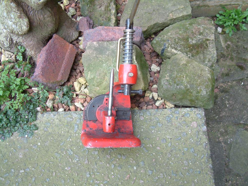

Arceye Blue Posted March 27, 2016 Share Posted March 27, 2016 Collected this item from a boot sale ,the seller when asked said he had know Idea what it was and for a quid "£1" I could have it. Could not resist it at that price any notions as to what it might have been used for ? ,the spigot an back scale are both adjustable. Regards . Quote Link to comment Share on other sites More sharing options...
Crazy Ivan Posted March 27, 2016 Share Posted March 27, 2016 What does pulling the lever do? If it's a snappy.little hammer contraption, then it may be a saw tooth blade setter tool. Quote Link to comment Share on other sites More sharing options...
Arceye Blue Posted March 27, 2016 Author Share Posted March 27, 2016 The lever just moves the shaft with the threaded knurled head bolt through up and down. Quote Link to comment Share on other sites More sharing options...

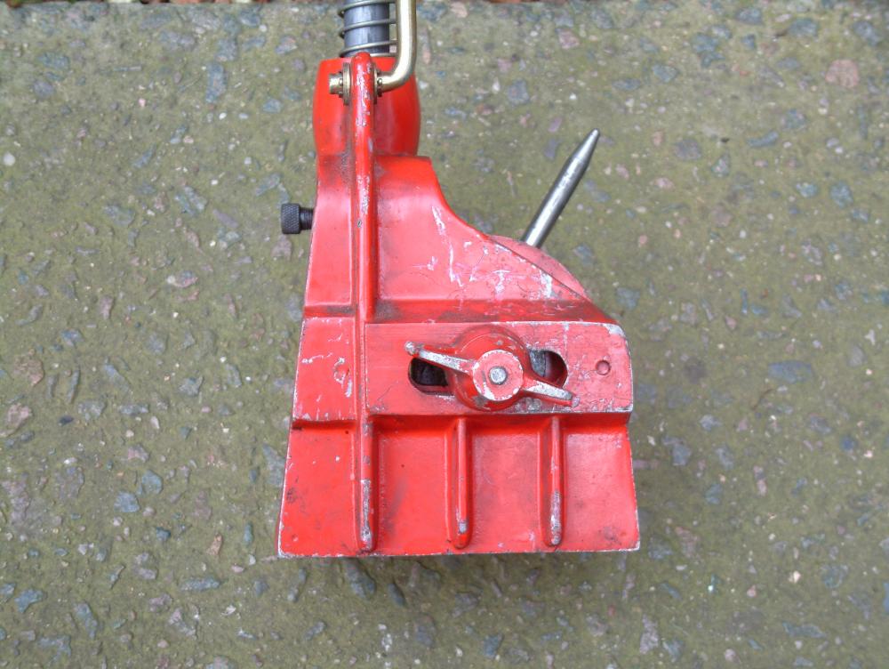

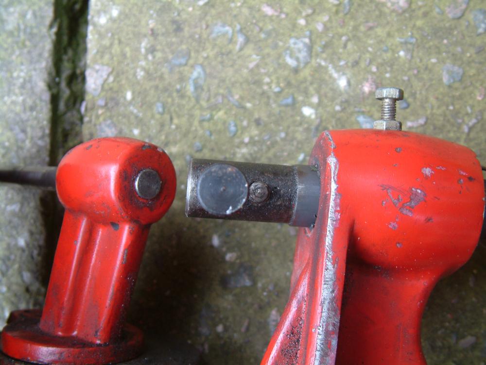

Frosty Posted March 27, 2016 Share Posted March 27, 2016 Can you post a pic from the side compared to the angle of these shots, showing what's on the bottom of the spring loaded shaft thing please? I have NO idea what it but I want one! It'd be cool even as a coffee table toy to keep folk entertained if they've already heard the story I'm telling at the moment. Seriously I just want to play with it. Frosty The Lucky. Quote Link to comment Share on other sites More sharing options...
duckcreekforge Posted March 28, 2016 Share Posted March 28, 2016 I would say it is a valve seat stone dresser. A lot of engine valve seats are 30 degrees and 45 degrees. Does the end of the black screw have a diamond for dressing grinding stones? Quote Link to comment Share on other sites More sharing options...
Arceye Blue Posted March 28, 2016 Author Share Posted March 28, 2016 10 hours ago, duckcreekforge said: 10 hours ago, duckcreekforge said: I would say it is a valve seat stone dresser. A lot of engine valve seats are 30 degrees and 45 degrees. Does the end of the black screw have a diamond for dressing grinding stones? I would say it is a valve seat stone dresser. A lot of engine valve seats are 30 degrees and 45 degrees. Does the end of the black screw have a diamond for dressing grinding stones? Yea I think you are bang on the money after a google search of valve seat stone dresser. A few extra pics for Frosty to conclude his train of thought ? Will have to think of a use for it Quote Link to comment Share on other sites More sharing options...
BIGGUNDOCTOR Posted March 29, 2016 Share Posted March 29, 2016 Sell it to the guy with the valve grinder. I see them for sale and they are incomplete many times. Quote Link to comment Share on other sites More sharing options...
