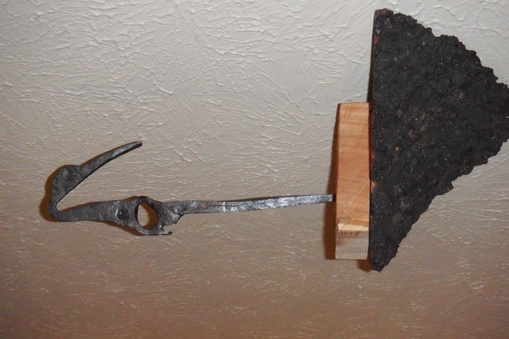

twodogzz Posted February 26, 2016 Author Share Posted February 26, 2016 Day 1 was still mostly for tweaking the forge and getting familiar with it and learning how it behaved. After forging a slot punch and drift out of some mystery steel, which, of course, turned out to be 5% iron, 95% butter, I forged the bottle opener: Wire wheeled it and set it back in the forge, which was off but still pretty hot. I was only doing that to take a picture, but when I went to take it out I could see the colors running. Yanked it out with this nice blue temper to it. Dumb luck but noted for later. I didn't have the proper tools to forge a horse head. So I forged a horse head. After building up a modicum of confidence, it was time to get serious with a sucker rod knuckle. Holy crap, I need a power hammer. Day 2 was in the books. The horse head was supposed to be a bottle opener too, but the punch was a disaster. Never got to the drift. The slot punch was a fail, so I forged a round punch which I think will work better. Day 3. Forged a hand fuller and chisel out of a crowbar. No pictures as they are soaking in vinegar at the moment. The round punch does work better, but my technique must be lacking. I screwed up another bottle opener and then decided to go with the crane. I've seen them done and Alec Steele has a nice how-to on youtube, so I went for it. The proportions are all wrong and the drifted hole got distorted along with various other little failures, but it got made. Lessons were learned. Quote Link to comment Share on other sites More sharing options...
