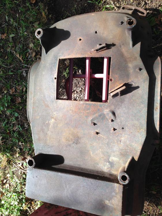

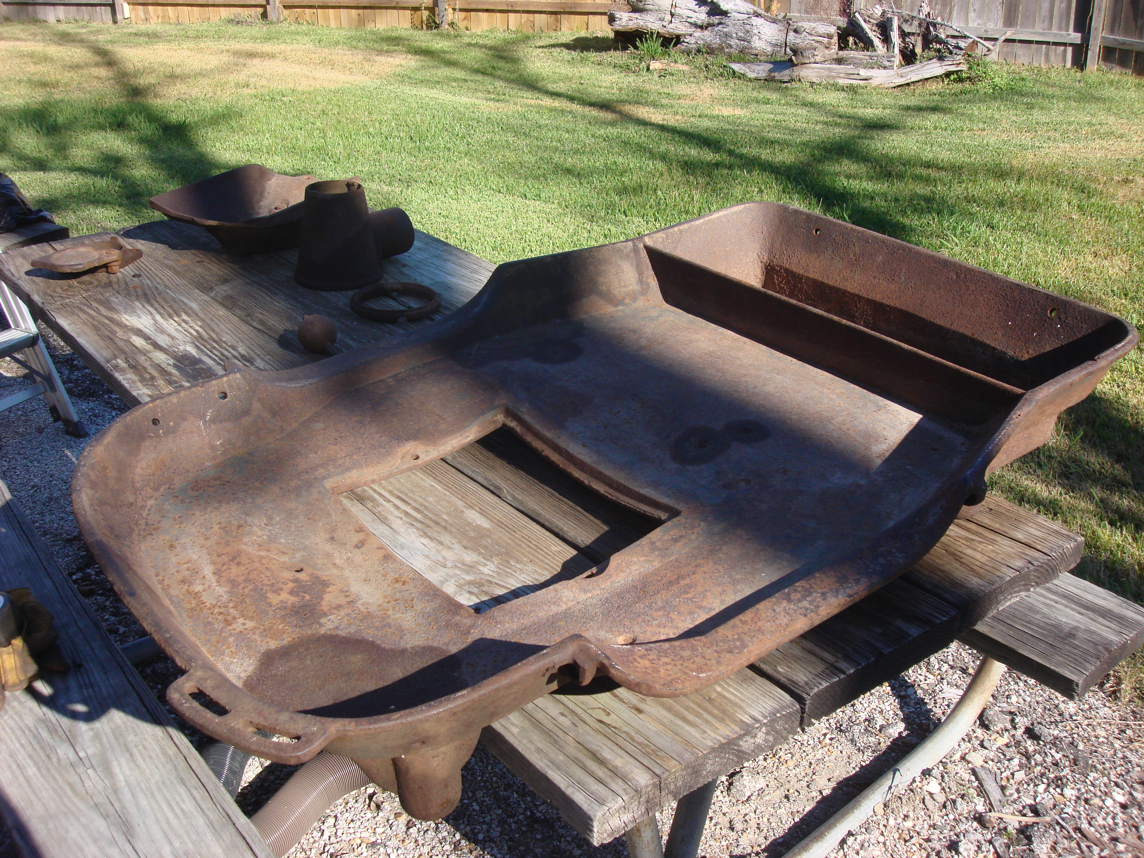

I just acquired a large old cast iron forge and the clinker breaker is missing. The rod and ball handle still exist, but the breaker itself met some sort of tragic end. I need to come up with a design, or find one compatible, new or used. The Centaur Forge clinker breaker is too small. The circular opening in my fire bowl is 3". I did buy the Centaur tuyere plate but I'll have to cut and grind on it to make it fit. What success will I have with just that and no clinker breaker if I want to get started forging without a clinker breaker solution? Any suggestions on finding or designing a new one? Here are some pics of the whole assembly. The only marking on any of it is "712" on the throat of the air intake.
I picked up this beast a couple of days ago and can't identify it. Before Show and Tell, known issues are: Forge: The clinker breaker must have suffered a catastrophic death along the way as it is missing (rest its soul). The Centaur Forge clinker breaker is too small, so I'll need to find one for sale (fat chance?), or fabricate one. I'll welcome ideas on that one. The opening in the fire pot is 3.5 inches. The ring that holds the clinker breaker is cracked. It is probably perfectly functional as is but if it can be welded I would have that done. It looks like the fire pot is designed for 2 long bolts to hold the entire assembly together from bowl to ash gate. In their wisdom, whoever disassembled it cut them flush with the receiver and they are rusted in place, so I'll have to extract those. On the forge table, same deal with the legs. They cut them off flush in the receivers and I'll have to figure out a way to extract them. Pictures tell all. I'll welcome suggestions on how to deal with these issues. Anybody know the brand and model of this beast? The seller said he thinks it's a Champion, but I didn't see one like it Googling, or in the 1909 catalog. No markings I can find. Anybody know? Champion 400 Blower: Thanks to a ton of info here and on other sites I've got a good working knowledge of how it's assembled and what needs to be done to restore it. But in all I have read I still haven't found a single solution for how to get the fan off if the nut is stuck. The jam nut is stuck on and I know cheaters in certain positions are out of the question. It is in good shape but I think the bearings need some work or replacement. I've seen the rear bearing set up and tightened it up a bit, but it's still loud and rattles a bit and it doesn't have a lot of inertia when you release the crank. It goes about 3/4 of a turn when released. No pictures of that. It looks like all the others. The tuyere opening is 3.5". I'll need to acquire or fabricate a clinker breaker to fit. Any suggestions? The retainer ring with crack, the old clinker breaker and a possible replacement rod given to me by the guys at Centaur Forge (they rock). Close detail of the clinker breaker carnage. On the underside you can see where the legs were cut flush with the receivers. Any ideas on extraction? Also, any ideas what the various mounting points are for?
You were right. Look what I found on eBay: Knowing what to google for is 99% of the battle. Never considered they could be for the end of a bar rather than for crossed bars. That gives me some crazy ideas. Well done sir. What part of Charlotte do you live in? I am a former resident of the great metropolis called Shuffletown.
