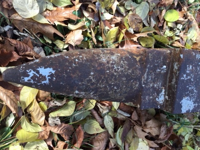

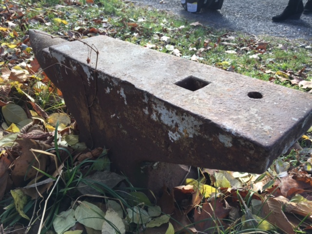

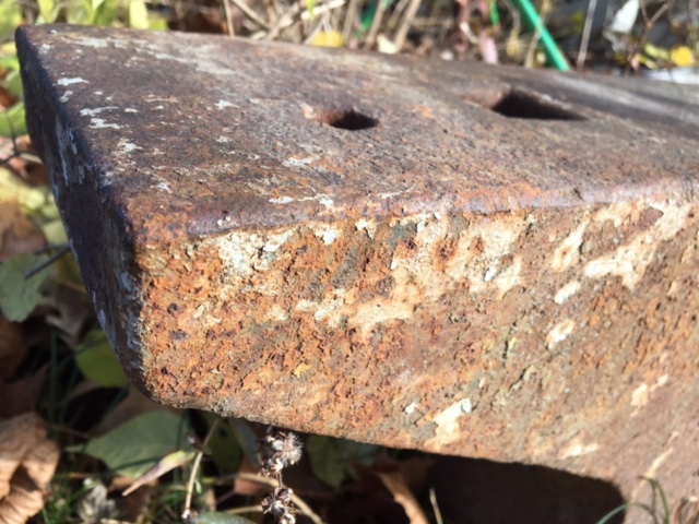

Heliotropicmoth Posted December 8, 2015 Author Share Posted December 8, 2015 Okay so a little back story on this anvil. This is sitting in the yard of my father in laws recently deceased best friends property. His widow, who is 90 and still sharp as a razor, doesn't care if I take it. But, she said it is up to her children what to do with it. I am still waiting to hear back from them. Even if they want to keep it for some reason I will try to convince them to shelter it out of the elements. There is a good chance I will get it for free though. So here are the pics I took on Saturday. I forgot my ball bearings, we were really there for a family visit, so I did not have a chance to test the tone or rebound. Any idea what anvil this is? Is it salvageable? Any help would be appreciated. Thanks Quote Link to comment Share on other sites More sharing options...
BIGGUNDOCTOR Posted December 8, 2015 Share Posted December 8, 2015 That is a Fisher, an excellent maker. Mine is 260# and was made in 1907. They are great for urban smiths because they do not ring. That is because they have a cast iron body with a tool steel top on both the body, and horn. They usually have the weight, and date cast onto them down by the feet. If you get that for free, you definitely need to do something VERY nice for them.... Quote Link to comment Share on other sites More sharing options...
Heliotropicmoth Posted December 8, 2015 Author Share Posted December 8, 2015 Thanks Biggundoctor, So the rust and chips are not a concern? I assume I can clean it up pretty easily and the amount of chips are minimal. Let me re-phrase what I said earlier. I will most likely get it for free, but I want to give Dorothy (the widow) something for it. She needs a lot of work done around the house so I was planning on offering my services, gutters, painting, potholes etc... If she doesn't want the help or the kids ask for cash, what would be a reasonable offer? Quote Link to comment Share on other sites More sharing options...
ThomasPowers Posted December 8, 2015 Share Posted December 8, 2015 It looks to be in quite good condition. I would advise not using anything more aggressive that a wire brush on it (followed by hot steel). If someone tells you to grind or mill the face DROP the anvil on them repeatedly till they come to their senses! Quote Link to comment Share on other sites More sharing options...

Heliotropicmoth Posted December 8, 2015 Author Share Posted December 8, 2015 Thanks for the info. If I get it I will just take a wire wheel to it, I assume in an angle grinder? Has anyone ever tried using electrolysis to remove the rust? Anyone have a estimate of a good offer on this anvil if they want to sell it? $1 a pound - $3 a pound? Quote Link to comment Share on other sites More sharing options...
ThomasPowers Posted December 8, 2015 Share Posted December 8, 2015 Yes and Yes ($1-$3 if it's in Ohio I wouldn't go high; Ohio's full of anvils most of mine were bought there with an average price for good name anvils in great shape of under US$1 of course that was a decade ago and the internet has probably ruined the localization of anvil prices...) Quote Link to comment Share on other sites More sharing options...
