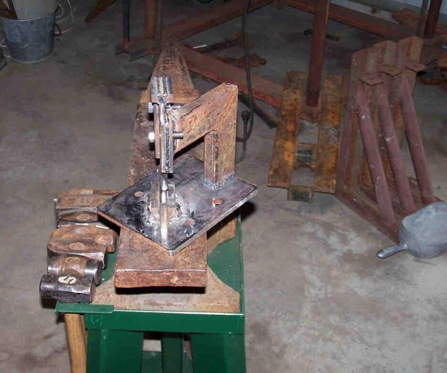

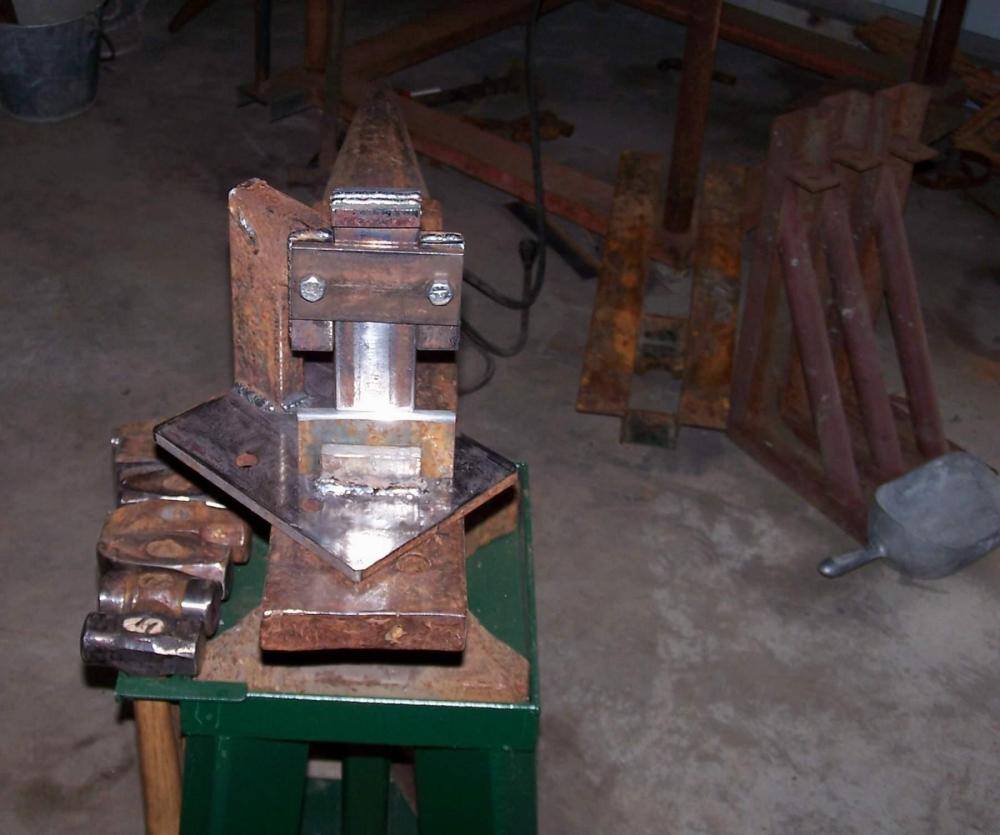

My small setup
I wish I remembered Will, when I  built mine I started with the piece of leaf spring I figured I could get the most dies out of and built out from there. I also wanted to be able to work across or lengthways on the stock so my guillotine doesn't look like "normal."

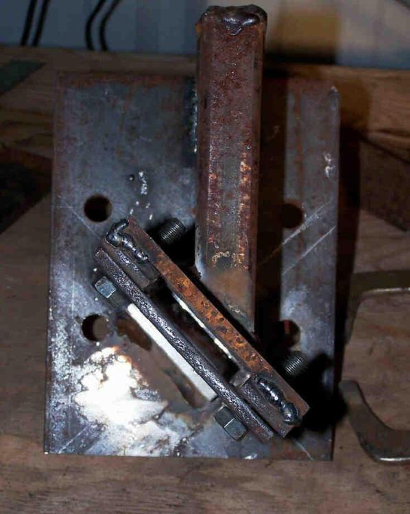

Sooooo, I made an open throat frame with the dies on a 45* angle so I can pass stock across or along the dies. Say I want to fuller a piece down or put a fuller in a blade. Rotate the guillotine to suit how I want to address the anvil depending on what I'm doing.  The last pic is a detail WIP to show the open throat support and the upper die guides.
At first I welded a piece of 1/2" square across the top of the top tie as a striking surface but they didn't survive long so I chamfered the striking surface SLIGHTLY and made sure the temper wwas drawn to dark straw.
Version two will have a socket to receive the hardy shank so I can use the guillotine over the center of the anvil rather than on the heel.
