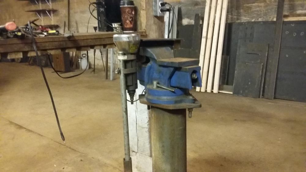

This is my fullering setup. A simple air cut off saw on an adjustable shaft connected to my vise pedestal.
20151018_083340.thumb.jpg.204500c3aed91e
I set the height, turn on the air and then grind the fuller in. I have several other air tools mounted to shafts for other operations as well. I lock a plate in the vise jaws to provide a stable work surface.
20151018_083321.thumb.jpg.df0edfa4aaeee4

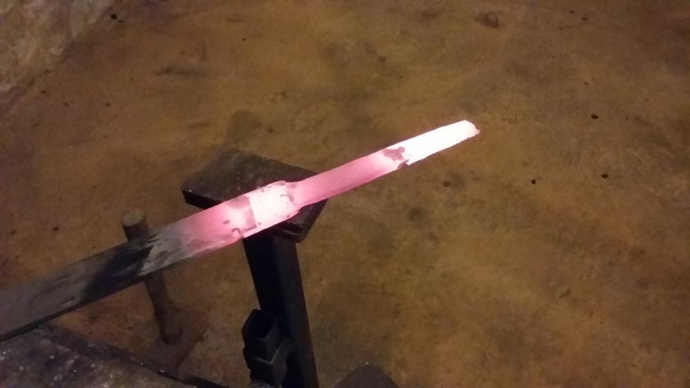

After cutting the fuller, I hammered out the edge and adjusted the amount of curve.
20151018_091523.thumb.jpg.803b3c62c69092

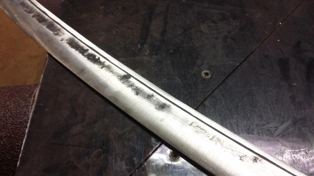

A quick grind before heat treating.
20151018_103407.thumb.jpg.8487f741f9fc6e
Close up of the fuller.
20151018_103420.thumb.jpg.a2442e8f225389

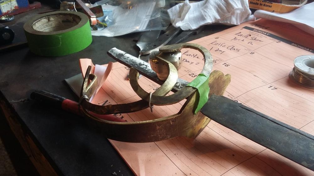

These are the brass elements. I cut most of them into long strips, annealed and then hammered to shape.
20151022_110259.thumb.jpg.d27ae4a9c5ac55
Testing my layout.
20151022_130416.thumb.jpg.9dd33413a04e69
After playing around with assembly ideas, I brazed the individual pieces to the base of the bell, cutting and making any additional pieces as I go along. Essentially, once I have a base I can build upon the design. It doesn't have to be pretty, just solid. After assembly I annealed the entire piece and hammered to the final shape over the horn of my anvil.
