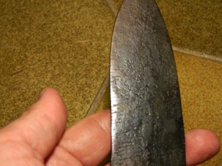

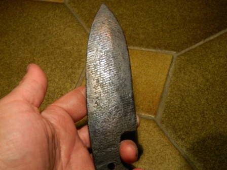

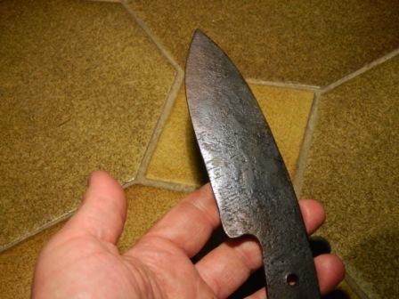

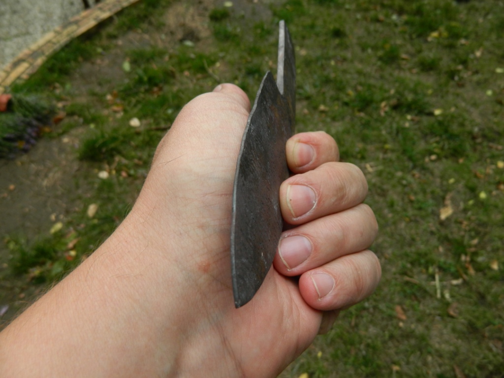

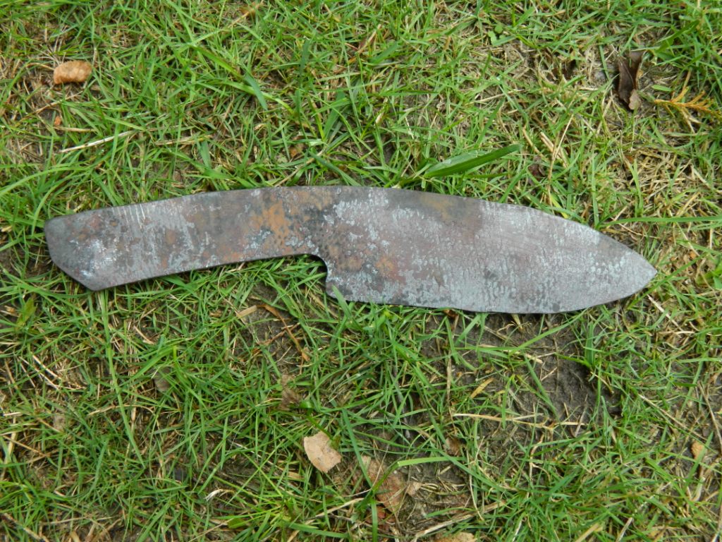

1) Old (non-identified) file wanted to become a knife....I start carressing it to shape with my hammer. (photo)

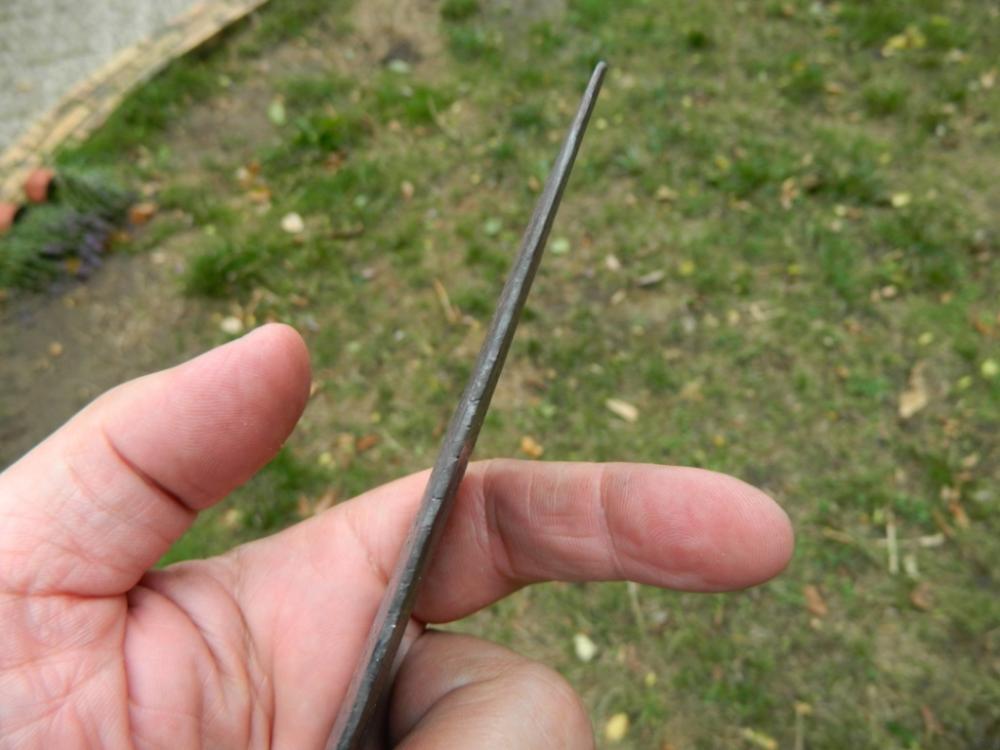

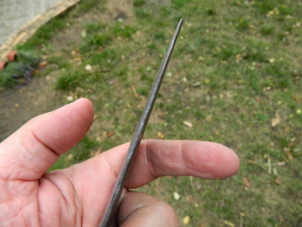

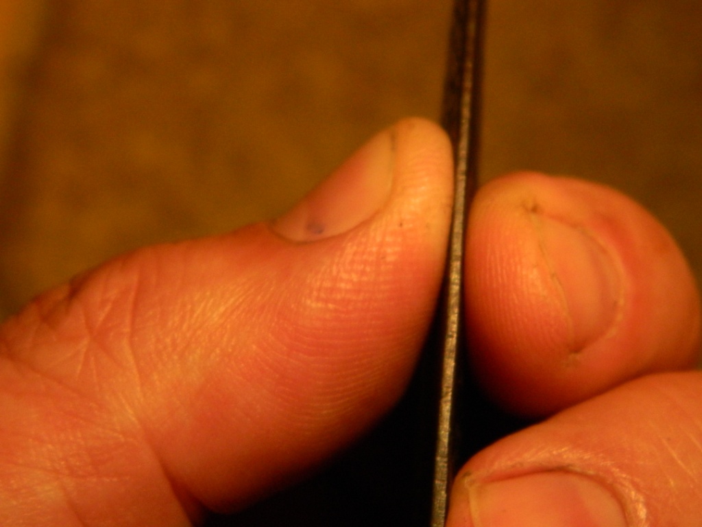

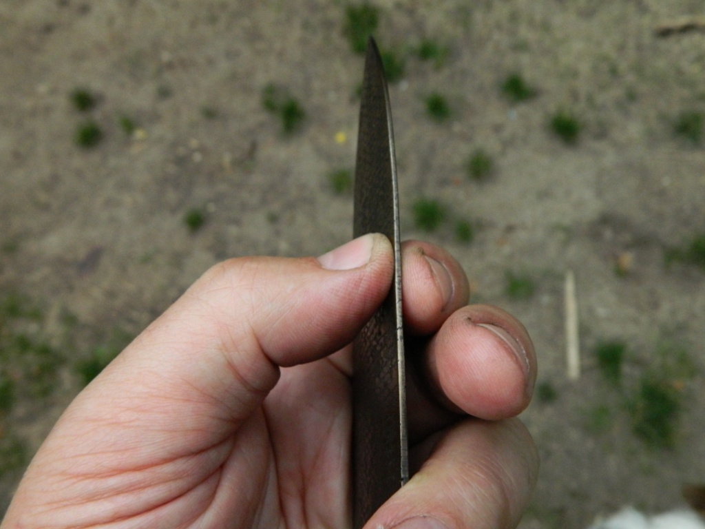

2) I get it to pretty much where I want it (edge about 1.3 mm thick, hardly any grinding to do except to tidy up the contour or the point) (photos )

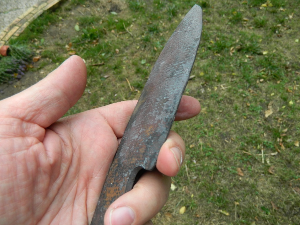

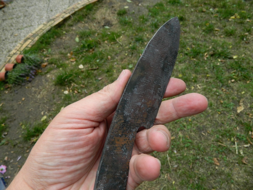

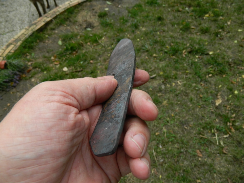

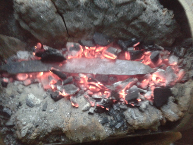

3) I took it back to the forge to thin out the profile of the knife, taper the tang slightly, and get the edge tidy. I quench it (in oil) and start to temper it directly on the coals (as in the Knifemaking Unplugged dvd) (photos ) BUT run out of light, and figure I can finish the last part (getting more of the blade to a bluish colour) the next day.

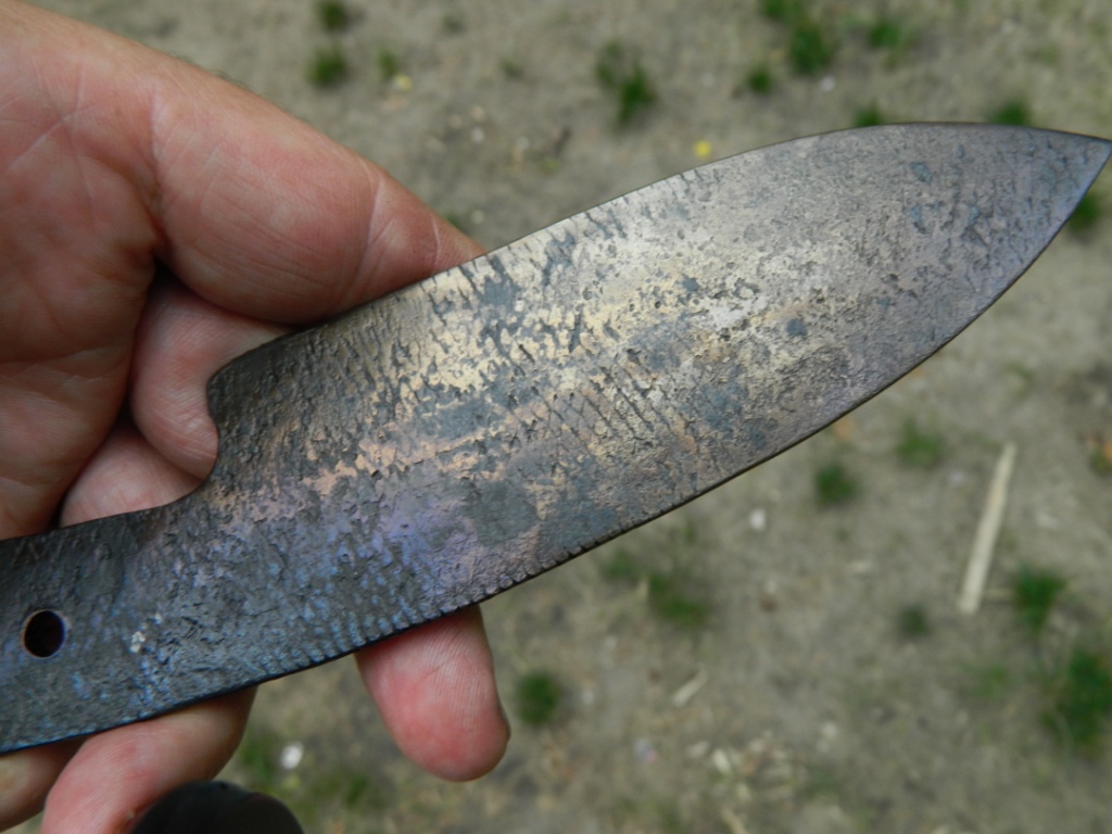

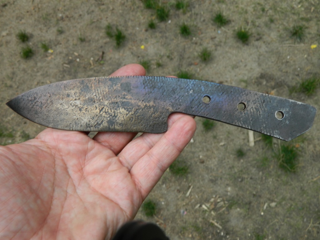

4) Tonight I realised that it might be difficult to control the heat from a bed of coals to precisely the area I wanted heating, so thought Icould do it with a gas burner (I can feel some of you raising your eyebrows).

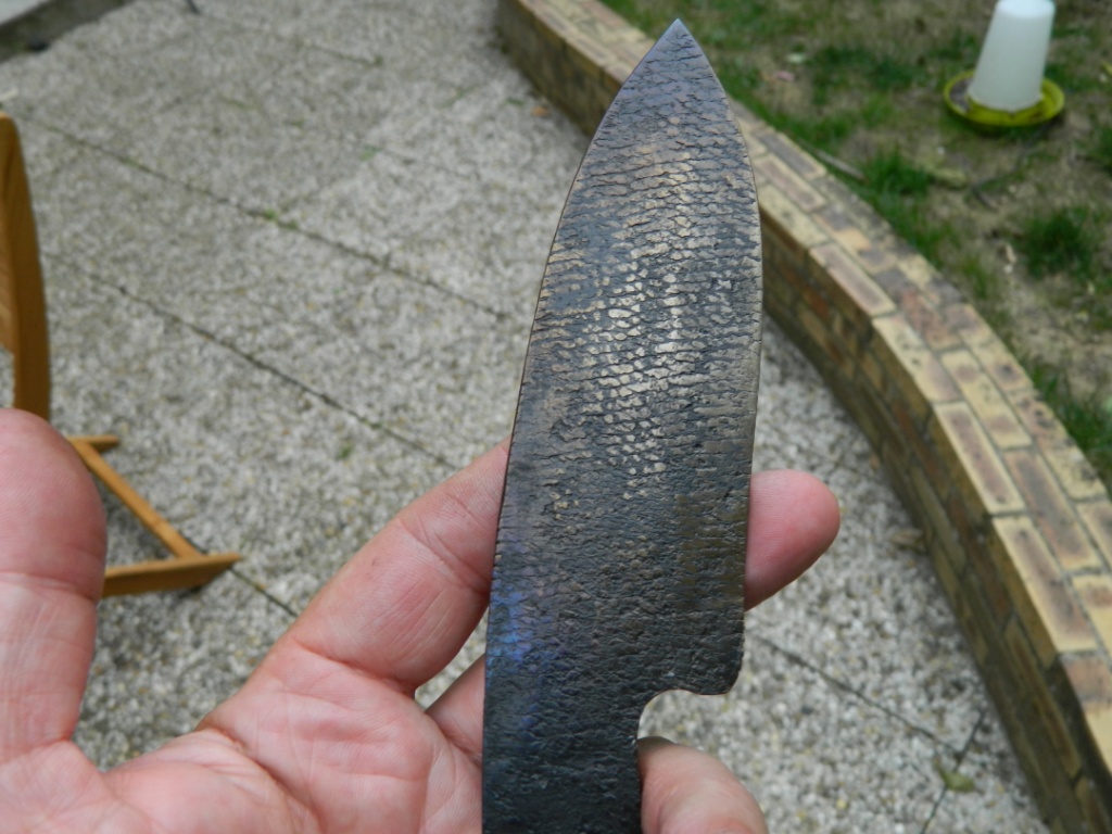

5) I heated the back of the blade, and the part I heated went bronze...and bluish colour seeped down almost to the blade edge. This was exactly the opposite to what I expected. Now the photos (called) show that most of the blade is bluish, but wiht some large Bronze areas near the point and at the black of the blade. (hard to see them because the phots were taking after dark with electric lights on)
I imagine that I can just normalise a few times, then requench and start the heat-treatment again...but I also feel that the edge of the blade is narrower now than when I quenched (maybe 1 mm). Is that possible/normal?
Remember this is the very first thing I've ever worked on, and although I don't like the idea of risking a new quech if the edge is finer, I don't really want to carry this knife forever worried that if I drop it it breaks. It's ONLY a 10c file from a flea market, but I've spent a fair bit on time on it, and I REALLY LIKE this knife already ;)
I'm not sure 'how bad' the situation is....Problemchild3.thumb.jpg.5519d8312ee75365

Remember when heating a blade the fat part heats slower than the thin part unless you take special precautions---look up tempering tongs for instance.  I've tempered a lot of blades using my gas stove burners.  (usually do a snap temper in the oven and then a differential temper using the burner)  and at last I TOLD YOU SO!  (also look up stress concentrators wrt blades)

Didn't you shine the blade up before trying to temper it? If so you got it to black heat so normalize and start over. Then again it might be the way you took the pics. Do NOT aim a flash attached camera straight at a flat reflective surface or the reflected flash will wash out colors and details. Just tape a single ply of tissue over the flash as a diffuser. OR shoot on an overcast day. A tan or light green background works nicely to show detail.

To be honest, I avoided the toaster oven out of sheer curiousity (that's one of the ways I learn ;) ), and actually seeing the colours move across the steel was really awesome (I use the word in the old sense). I did (half!) what you said, went back, normalized it, requenched...and ouch, it came out warped (cocking up really badly is the other main way I learn :D ), I heated it up, straightened it out, normalized again, and quenched...looked fine. THEN...
@ThomasPowers  then I tempered it using two red-hot hammer heads that I wanted to anneal (one to make a light, rounded hammer to fill in for a ball-pein hammer since I don't have one ;) ). I figured this way I kill two birds with one knife! I laid one head on the anvil, and held the back part of the knife on it, and laid the second one on top. Worked out pretty well...yah! (although I was shocked at how fast those colours raced across the blade...Lucky I was horribly worried and was watching closely..lol!)

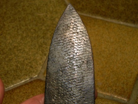

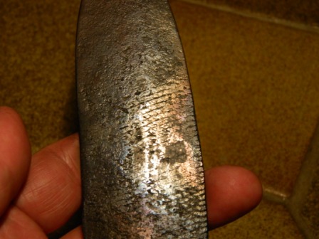

Well, the first thing.  Never forge a file with teeth.  They get pushed into the steel, deeper than you'd imagine.  That can cause stress risers that will crack and weaken the blade.  I'll tend to grind most of them away and all at the edge bevel.  If you look down the edge you can see the teeth pushed in.

For your last question, the more complex the alloy the more important to give it a proper temper cycle.  While a simple carbon steel can be done that way, do you know that's what the file is made of?  Did you check it with a sharp file after quenching to make sure it hardened?

@jmccustomknives...I've already been to your site a few times...that certainly does lend a lot of weight to your words.  I have no idea what the file was made of. An old-looking file, with rather deep teeth..so I guess that's about the worst case to leave them on rather than grind them off to start with. Although the file was about 1cm deep.  'Stress risers that can crack or weaken the blade'...I don't suppose you're just talking about during the forging/quenching/tempering process? (crosses fingers). -_-
