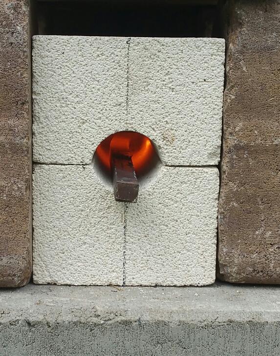

Codycrusenberry Posted August 17, 2015 Author Share Posted August 17, 2015 I have the 50$ dollar knife shop, super cool book! So i got my bricks today, made a nice little 1.5"x8" chamber. It gets much hotter than the ceramic board alone, however im starting to have my doubts as far as my propane/torch go. I think the torch is good, its for pre-heating steel before a weld, however the control knobs on it, about 2 turns out, it no longer dumps more fuel, its like the propane bottle is to the max. Would a regulator fix this? Or just a larger bottle? Im just using the 16oz propane handhelds......not so great. Ive got the cash for a larger bottle, however not sure if that will help to get more flame and heat, or i need a better burner, i know i could use both, just wondering what i would see a more dramatic difference from.....also i have photos of my setup, its sure to dazzle you all. Lol thanks for helping a noob out, im trying to pay my dues just as you all did! Quote Link to comment Share on other sites More sharing options...

Codycrusenberry Posted August 17, 2015 Author Share Posted August 17, 2015 Check it out buddy, got me some of those magic bricks........finally! Sorry for the wacky picture layout......had to crop them to death to get them under 500kb. Thanks for any feed back, try not to be jealous of my sweet gear............lol Quote Link to comment Share on other sites More sharing options...
LastRonin Posted August 17, 2015 Share Posted August 17, 2015 I would highly recommend building a Frosty T-burner and getting a good 0-30 psi propane regulator. Quote Link to comment Share on other sites More sharing options...
