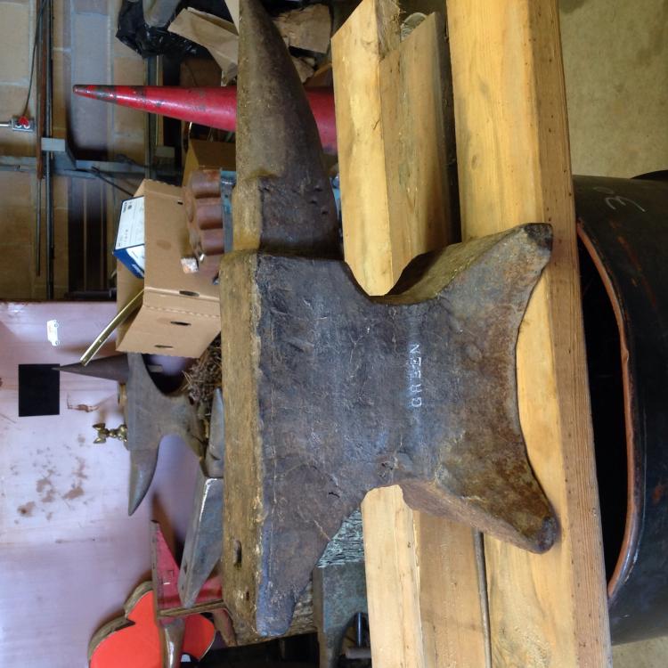

June 4, 201511 yr This anvil says Green at the bottom. I can't locate any information on a green anvil. What do you all think this anvil is and how old is it? Thanks for the help.
June 4, 201511 yr Stamp may be a personal stamp too. Can't see much in that picture but it looks a bit like a Vulcan or Vulcan clone.Knowing at least what country you are in would help.
June 4, 201511 yr The horn doesn't look like a Vulcan's horn. The picture you posted won't enlarge. Does it have handling holes? More and bigger pictures would help identifying it.

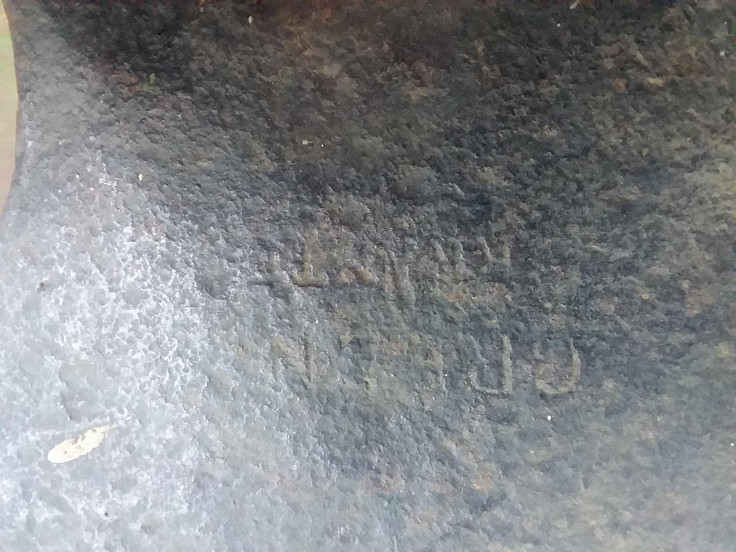

June 4, 201511 yr Author I'm sure its an European anvil because it's got 1 0 18 as the stone weight on the opposite side of the anvil.
June 4, 201511 yr NC New Caledonia (French: Nouvelle-Calédonie) is a special collectivity of France located in the southwest Pacific Ocean, 1,210 km (750 mi) east of AustraliaProbably from France as you are in a French collectivity....world wide web ya' knowCan we see a picture of the stone weight and any other markings on it? The fat, short heel, short horn and little height in the step transition was what I was basing my call on. Does it weigh 130 pounds? Edited June 4, 201511 yr by ThomasPowers
June 4, 201511 yr The horn does look like a Mousehole forge anvil's horn but the heel is USUALLY shorter on a Mousehole. It may just be the angle of the picture though that makes the heel look longer than it is.
June 5, 201511 yr Author This anvil says Green at the bottom. I can't locate any information on a green anvil. What do you all think this anvil is and how old is it? Thanks for the help.
June 5, 201511 yr Those photos are much better, thanks. Obvious globbed together forge welds in the body, visible face plate weld line, and overall shape strongly indicate English import. There were hundreds? of makers of similar anvils in that era so who knows. Call it a Green and get hammering. Not much rarity value if you are planning to take it to ebay unless you can dig up a better story than you are finding here. It's functional for a smith but beat up for a collector... kind of small in my opinion (grin). There are 2 or 3 guys on here who might know better, perhaps they will chime in.Some of those Hay Budds you have in the background look like nice users. Edited June 5, 201511 yr by Judson Yaggy
June 5, 201511 yr Yes the clear pictures clearly contradict my earlier musings! (save that Green might have been the owner)Traditionally forged anvil; not a bad weight; does the pritchel hole look to be drilled rather than punched? (If so it may be a retrofit pushing the date of the anvil back a bit further.)
June 5, 201511 yr the pritchel hole was punched from the bottom side and was punched at a slight angle. the hardy hole is also crooked with a slight taper on all four sides. ps posting for hammerhead73 thanks joe
June 5, 201511 yr It looks a lot like a Mousehole although mine and all the ones that I have seen have the weight and maker stamp on the other side. Edited June 5, 201511 yr by Anthony San Miguel

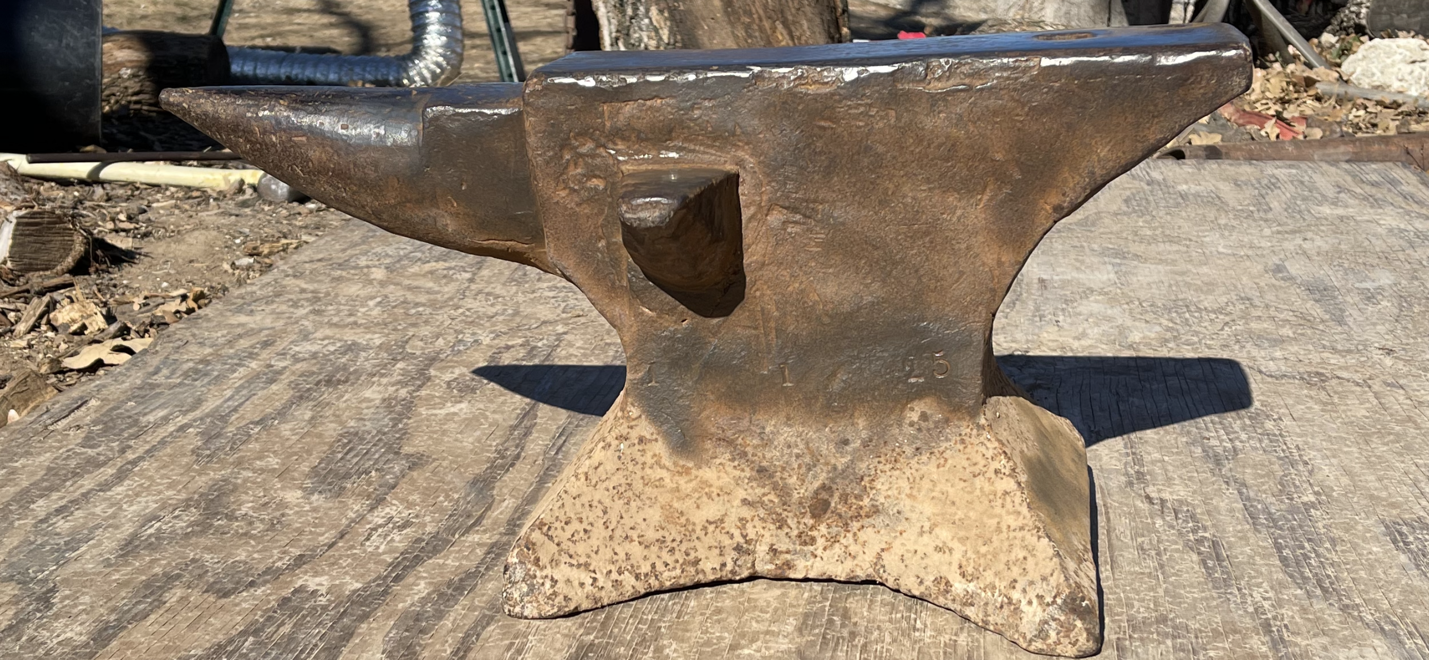

September 29, 20214 yr Pictures of your anvil may help in identifying it and what it is worth. The main thing in estimating value is the location, condition, ring and rebound.
September 29, 20214 yr I've updated my location. I believe it's the exact same as those shown above. This one is in need of some repair but I'm pretty proficient with a welder. Picked it up at a local antique store this morning.
September 29, 20214 yr Being proficient with a welder is important when repairing an anvil. However knowing how to do that without ruining it is even more important. Have you ever welded on an anvil with a wrought iron base and hardened face plate? The best method of repairing anvils is in this article by Robb Gunther and Karl Schuler. http://www.anvilmag.com/smith/anvilres.htm
September 29, 20214 yr Are the stampings identical? Looks don't make it the same brand! (Remember when all the American car dealers made all their sports cars almost identical and you had to pretty much read the name to tell them apart?) The Gunther/Schuler is the gold standard for repair; DON'T forget the preheat! It is in pretty sad shape for using as it is. I would not suggest it even to a beginner unless it was very cheap indeed! Fixed it could be a nice anvil; but to fix it well is going to take a LOT of time, talent and consumables for the welder----way more than it could be sold for afterwards probably. Now the horn looks in good using shape in case someone with an improvised anvil needs the use of one.
December 20, 20214 yr New to the site and thanks in advance for any help. My uncle gave my son an anvil with this exact maker's 'Green' stamp on one side and '1 1 25' stamped on the other (believe this makes this anvil 165#?). My uncle was given the anvil from his great uncle who's family settled in Willow City, TX in the 1800s and my great, great uncle's brother worked at the Morris Thoroughbred Ranch where Max Hirsch, the famous race horse trainer started at 12 years old. I was trying to find a date or at least an era when this anvil was made.
