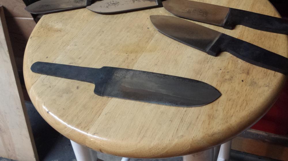

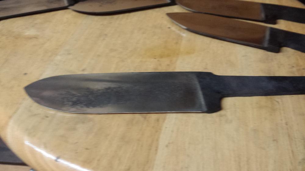

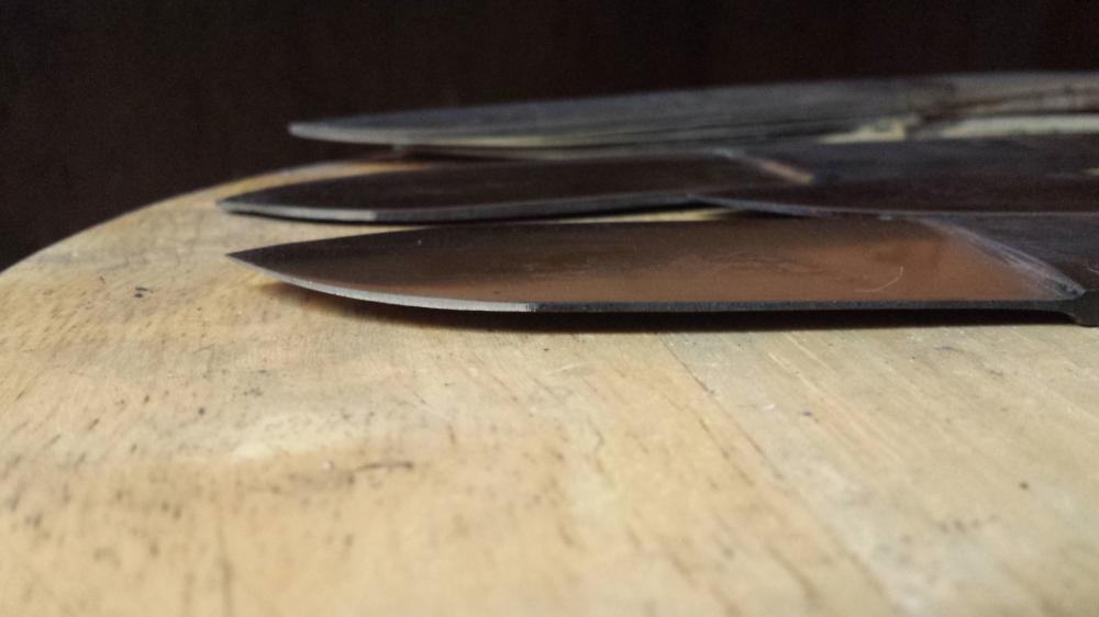

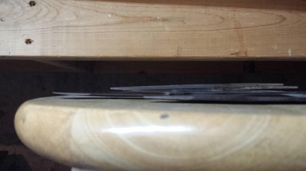

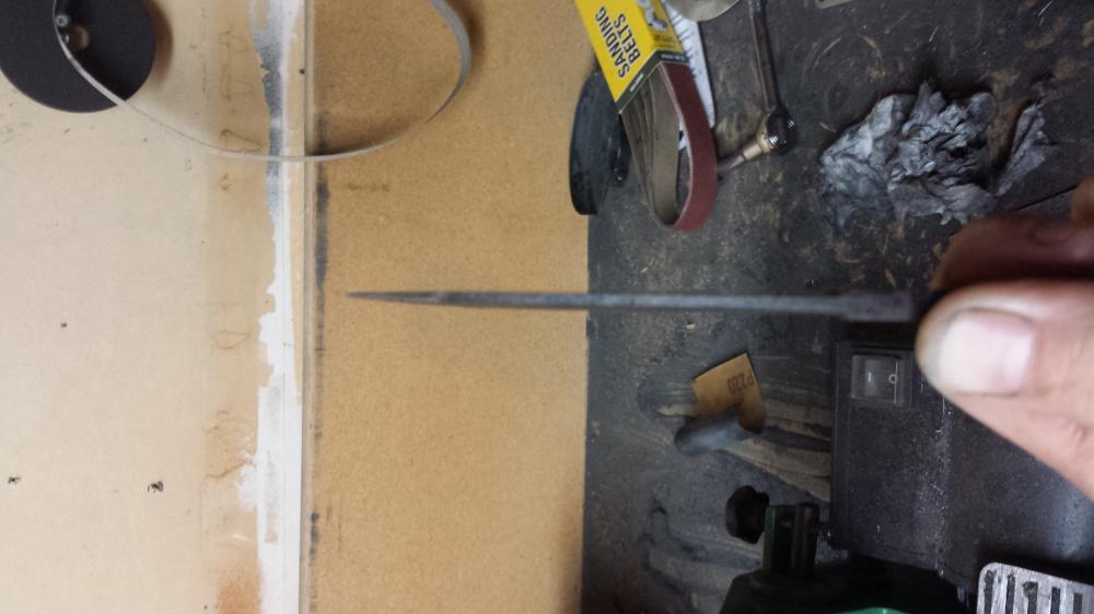

here are the pics I promised, after looking at them again ( post frustration ) they are not that badly warped, and even a wooden hammer treatment might even save the larger one.
20150427_162820[1].thumb.jpg.0814def1b3220150427_162708.thumb.jpg.f3a5ae1c870f3020150427_162754.thumb.jpg.a9b52d73d2137b20150427_162931[1].thumb.jpg.1dcbbd157d720150427_162958.thumb.jpg.90aa6b8349469e
The bottom two are of the larger knife, as you can see in the first pic, there is an obvious central curve to the knife, on the last one, the outward curve is VERY apparent.
but, I am going to take a bash at them with a wooden hammer ( just gotta make one first which should be MUCH easier then making one of metal ) and see if I cant straighten these bad boys out some.

Don't hammer hardened blades!  Some alloys have a, brief, period during hardening when you can tap a blade straight; but if you miss the window then it's tink time.
I still suggest normalizing and straightening and then re hardening and tempering.  Read up on grain refinement too.

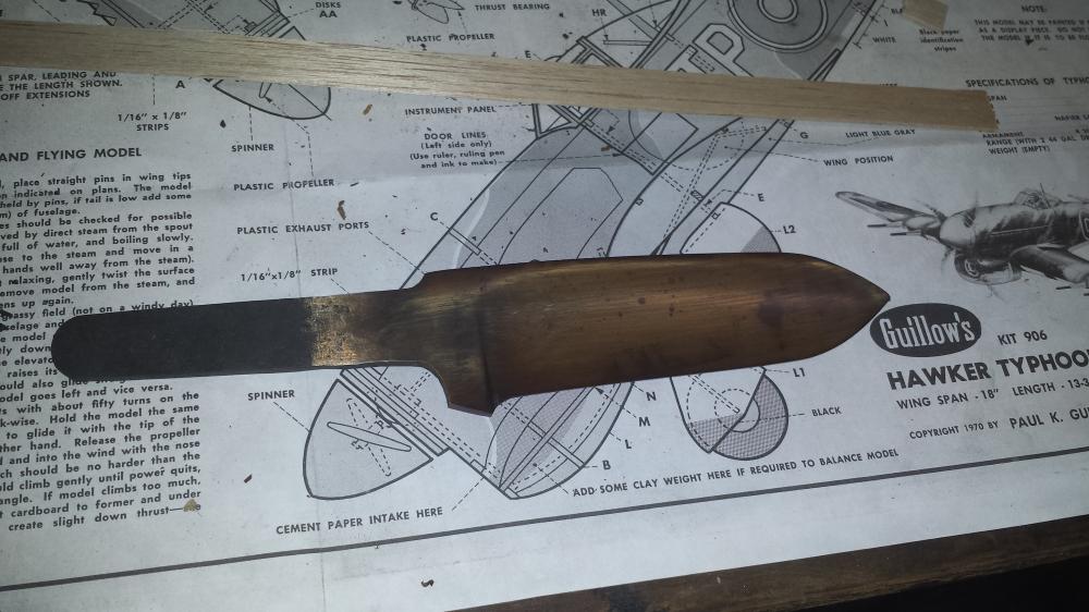

Ok, so I have fixed the bigger one, cleaned it up, and triple tempered it. However, I think the oven got hotter then I should have let it get.
To be honest, I was looking to go for a " more durable " blade for this one, as its bound for the jungles of Costa Rica on the belt of one of my best friends dad who retires to there this week. I did a file test on it after it had cooled and the edge ( not sharpened yet ) is still VERY hard to remove any stock from with a clean file, But this is what it looked like when I pulled it out of the oven after its final temper.
I ran the oven at 400 deg. for 2 hours.  I dont have a Temp gauge for in the oven yet, that is something I plan to buy this weekend for when I fix my other knives that warped and start the temper process on my fully forged O1 knives I have been waiting to start on.
Did I get this too hot, like I said, I was going for a more " chopper " level of temper so it could stand a bit more use and abuse before it eventually breaks.

Can you tell us how we should know how hard your customer likes their knives?  Machetes are traditionally a bit on the soft side to make them easy to sharpen in the field and less likely to chip and break in use.
Forget the colour it's the hardness you need to concentrate on.  Leaving it in the oven for a long time will shift the colour  more than it will shift the hardness.  Go by your testing of the edge with a file.
