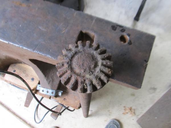

This is my mystery steel. I'm hoping that someone can tell me what it is and where it was used. I believe it's high carbon and I would like to make some drifts from it, if possible.
It was threaded on one end with a keyway and geared on the other.[

It appears to be axle stock.  4140 is a good guess.  That's not high carbon... but it makes pretty good drifts for most purposes.

Looks like the driveshaft for the chamber packing fingers on an international small square hay baler. the tapered keyway would fit a 45 degree timed bevel gear the 90 degree gear end is driven from the plunger crankshaft.

High Carbon can be detected by the spark test; especially comparing with a good file.  Medium carbon is a bit harter to judge without a lot of known samples
