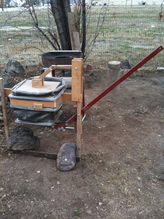

Azur Jahić Posted August 23, 2012 Author Share Posted August 23, 2012 my progres with bellows it"s half done only i need atach iner tube of cars and make frame which is easy this was the hard job Quote Link to comment Share on other sites More sharing options...
pkrankow Posted August 23, 2012 Share Posted August 23, 2012 With a little more care that type of saw can make much neater cuts. You can also take the blade out, pass it through the holes, and cut neater openings. The openings do not need to be round, but neat is helpful. Ragged edges will make it harder for the valves to close properly. Phil Quote Link to comment Share on other sites More sharing options...
Azur Jahić Posted August 23, 2012 Author Share Posted August 23, 2012 i will try with rasp because i hammered this and its have flap inside i cant pass trough "when i wide the hole will air escape Quote Link to comment Share on other sites More sharing options...
VaughnT Posted August 23, 2012 Share Posted August 23, 2012 That's a rather ingenious design! I can see it with brass tacks and maybe brass nailing strips for that Steampunk look. The holes you have cut should be as neat as possible. You want to have the edges smooth, and don't worry about making the holes too big. The one key problem I see is that the design you showed has one long strip of rubber to cover all three of the holes. This is a recipe for disaster because the flap can get twisted and you have no way to fix it without taking the bellows apart. I would strongly suggest you use a separate flap for each hole so the rubber tubing is reasonably stiff and can't get twisted up. Also, it will help if you hold all of your sheets of plywood together and form them at the same time as one big piece. Trying to get four individual pieces shaped and matching one another is a lot of trouble if you don't have the best equipment for the job. Holding the four or five sheets together with some clamps will help a lot. Quote Link to comment Share on other sites More sharing options...
Azur Jahić Posted August 24, 2012 Author Share Posted August 24, 2012 i put leather instead of rubber guys can i use slim (thin) peace of wood instead sheet metal to atach iner tube on plywood Quote Link to comment Share on other sites More sharing options...
pkrankow Posted August 24, 2012 Share Posted August 24, 2012 guys can i use slim (thin) peace of wood instead sheet metal to atach iner tube on plywood Maybe. The thin sheet metal is a lot better because it won't split out like thin wood can. You may be able to cut up some cans to get the sheet metal. Even a bean can, cut in a spiral, can offer a long strip of metal. It would probably take several cans to get enough strip to go all the way around all 4 boards. Larger cans, like from coffee or paint, would work better. To mark a spiral on a round can easily mark the sides of the can up one side then wrap with tape carefully in a spiral. Cur along the edge of the tape. If you don't have tape, use string then trace the string carefully. Phil Quote Link to comment Share on other sites More sharing options...
VaughnT Posted August 24, 2012 Share Posted August 24, 2012 The metal strip is there to distribute the pressure that the nails apply, and prevent the nail heads from tearing the tube material. Thin would will work, as will thin plastic, but the wood will require pre-drilling the holes so you don't split the wood. I would also recommend increasing the number of nails used, tightening their spacing, should you go with the wood option. Or, use a section of garden hose cut to length..... Lots of options..... Quote Link to comment Share on other sites More sharing options...
Azur Jahić Posted August 25, 2012 Author Share Posted August 25, 2012 i have metal sheet but i dont have sissors for metal i have hack saw but i think its hard to cut metal preciesely do you have difrent way instead use hacksaw or sissors Quote Link to comment Share on other sites More sharing options...
pkrankow Posted August 25, 2012 Share Posted August 25, 2012 A heavy knife can be carefully used to cut thin sheet metal. Carefully being a key word, getting hurt while building a tool is no good. You can use a wood mallet to drive into the sheet backed by a stump. A chisel can also be used in this manner. If you have a vise sawing along the jaw with the hacksaw can quickly cut sheet metal neatly. Similarly using a couple clamps to fasten a piece of metal stock to act as a vise, or even a couple stout boards, could also work well as a vise and cutting guide. Vaughn suggested pre-drilling thin wood for nails, or using some rubber hose. Rope, or a couple layers of leather strip may also work. The idea is to provide for enough clamping along the entire edge to prevent air leaks. Phil Quote Link to comment Share on other sites More sharing options...

Azur Jahić Posted August 28, 2012 Author Share Posted August 28, 2012 final picture when bought tin snips the job was half done Quote Link to comment Share on other sites More sharing options...
VaughnT Posted August 29, 2012 Share Posted August 29, 2012 Excellent work, Azur! Quote Link to comment Share on other sites More sharing options...
Azur Jahić Posted August 29, 2012 Author Share Posted August 29, 2012 thanks i will secure that bether because it almost hit the ground and i think its heavy i must make balance Quote Link to comment Share on other sites More sharing options...
