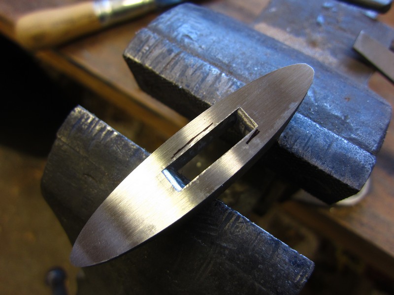

JAKA Posted March 7, 2011 Share Posted March 7, 2011 Absolutely wonderful tutorial. The knife turned out to be beautiful. Really nice work. I have a couple of questions for you. You said you peen the edges of the guard. Are you talking about the bottom edges of the slot or the top? Also, you mentioned that you hammered the guard onto the shoulders. Would it not fit prior to this? Not criticizing, just curious since you've achieved a really nice fit on the guard/blade. This is really useful informations and it is appreciated. Thanks. Quote Link to comment Share on other sites More sharing options...

Phillip Patton Posted March 9, 2011 Author Share Posted March 9, 2011 Maybe this picture will show what I'm talking about better. This is the side that faces the blade. Can you see the dimples from the ball peen hammer? They expand the metal at the edges of the slot, and make the slot slightly smaller. Then the guard is driven onto the tang. Then the guard is taken off and the surface ground down until the dimples are gone. I always try for a fit tight enough that the guard has to be pressed (or hammered) on. This just helps guarantee a good, gap-free joint. I guess I forgot to mention that the tang is slightly tapered. It's thickest at the guard location. Quote Link to comment Share on other sites More sharing options...

JAKA Posted March 9, 2011 Share Posted March 9, 2011 This is the side that faces the blade. Can you see the dimples from the ball peen hammer? They expand the metal at the edges of the slot, and make the slot slightly smaller. Then the guard is driven onto the tang. Then the guard is taken off and the surface ground down until the dimples are gone. I always try for a fit tight enough that the guard has to be pressed (or hammered) on. This just helps guarantee a good, gap-free joint. I guess I forgot to mention that the tang is slightly tapered. It's thickest at the guard location. Quote Link to comment Share on other sites More sharing options...
